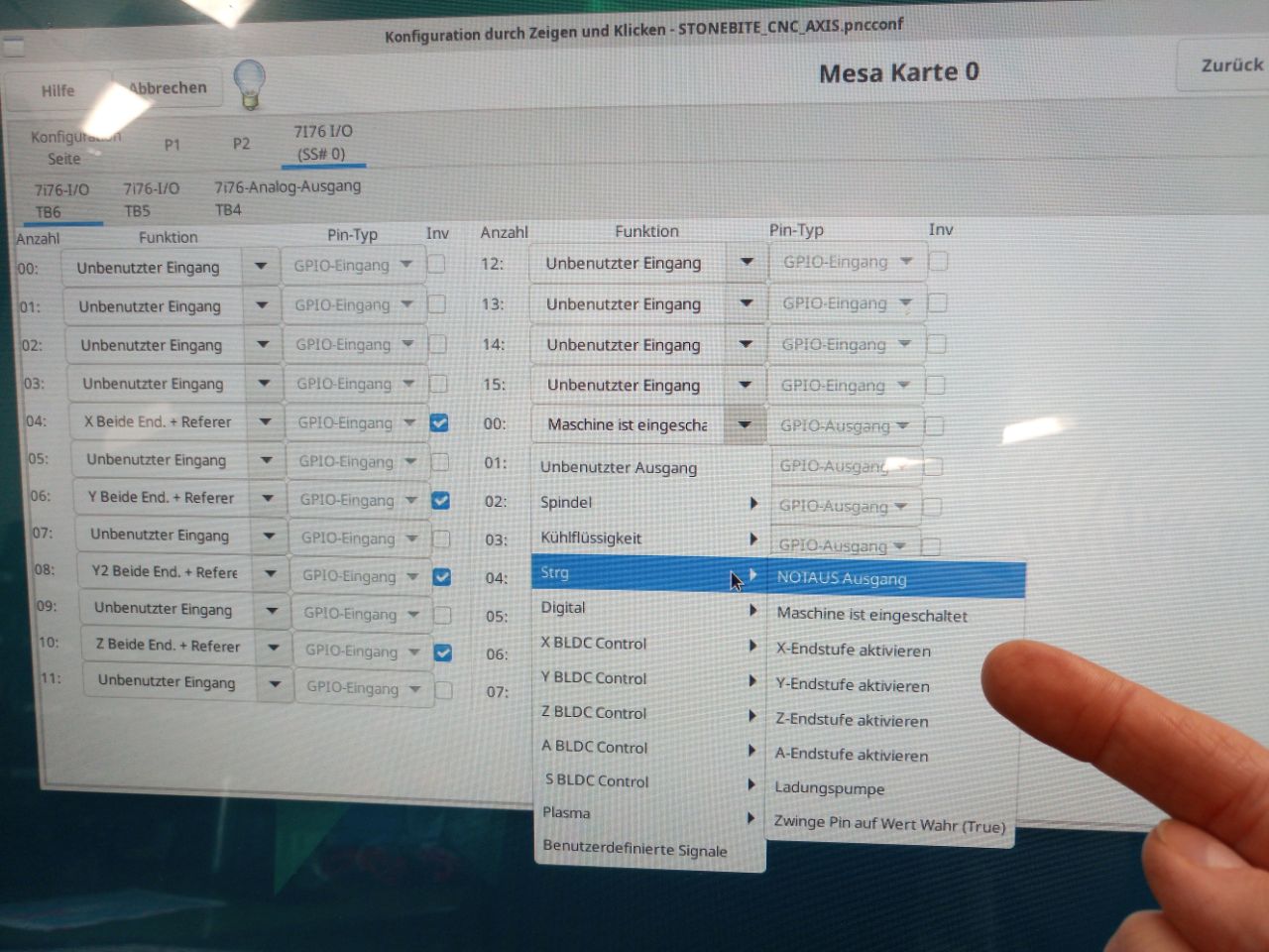

04 Jun 2024 08:25 #302311
Replied by PCW on topic PNCconf 7i92H and 7i76
For a general enable output, "Control" --> "Machine Is Enabled"
is a good choice
is a good choice

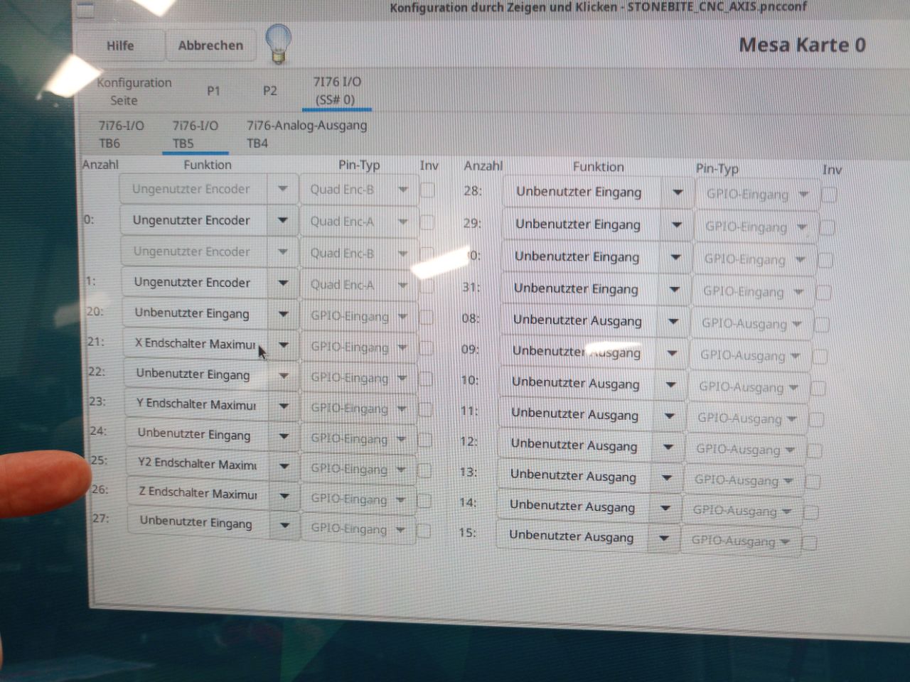

You asked : To enable this via the 7i76 I have to assign the correct property from the pull-down menu, which is the correct property?
You got the answer : For a general enable output, "Control" --> "Machine Is Enabled"
is a good choice
That is the exact answer to that question, on the output pins pull down menu, choose "control" and select "machine is enabled".
That is the pin that will enable the machine when F2 is pressed on the keyboard or screen/GUI.
That is also the pin that will disable the drives in case of joint errors or pressing E-stop.

The PNP limit switches (work on halshow). The servos are running. The Excel sheet shows where I have created which contacts, what I don't know and can't read anywhere (manual) or look up (videos) is which assignment is correct.
The Excel sheet shows where I have created which contacts. What I don't know and can't read about anywhere (manual) or see (videos) is which assignment term is to be assigned to which GPIO, etc. I don't have a clear idea of this and I can only test, test, test, but I don't know whether I'll destroy anything in the process. I want to counteract this.

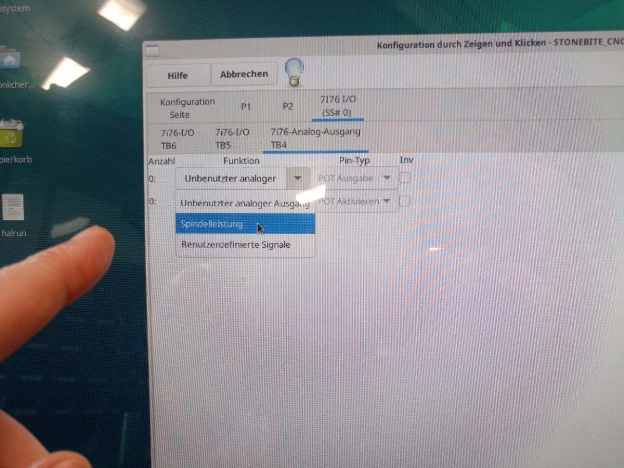

I would now like to ask specific questions.
Would anyone like to help me ...
to write the basic HAL/INI files for my Gantry CNC machine if I provide all information about the machine and its components like the 7i92 with 7i76?
or
would someone like to help me ...
to write me with the PncConf with the Excel file "7i76 Contact Assignment" listed above, which "selection criteria" from the pulldown menus of the PncConf I should/must select for the corresponding pins, so that I get at least all actuators on the 7i76 assigned for LinuxCNC?
I realise that I learn the most by testing and trying things out. At the moment I'm at a point where I realise that it's no use spending nights on end and not making any progress.
If I had at least the basic HAL/INI file, I could learn from it.

- Posts: 18120
- Thank you received: 5337
06 Jun 2024 07:41 #302465
The typical way this would be done is to use pncconf
or mesact (GUI configurator programs) to create a basic
hal/ini file set. Then if there are more complex details
not handeled by the GUI configurator programs, the hal /ini
files are edited by hand to add the needed features.
Do you have a basic working hal/ini file set?
if not , what is the specific issue?

To help me:
Can and or do you want to write a HAL/INI file for me and my CNC portal milling machine?
If so, what informations do you need?
If not,
the second possibility to help me:
Can and/or do you want to write me which terms I need to assign to the pins from the pulldown menus of the PncConf. Please watch my video per Link
www.dropbox.com/scl/fi/j62sg1yh12hca8g03...dbu&st=cnasz00z&dl=0
I need the correct assignment terms from the pull-down menus in PncConf that match my data sheet for the contact assignment.
To respond to your answer, if I understand it correctly.
I am using Visual Studio Code to create, read, emulate an save HAL and INI files.
Are you referring to this or a similar programm?
I don't think I'm asking the right question, or my questions are interpreted?
So again ...
To help me:
If not,
