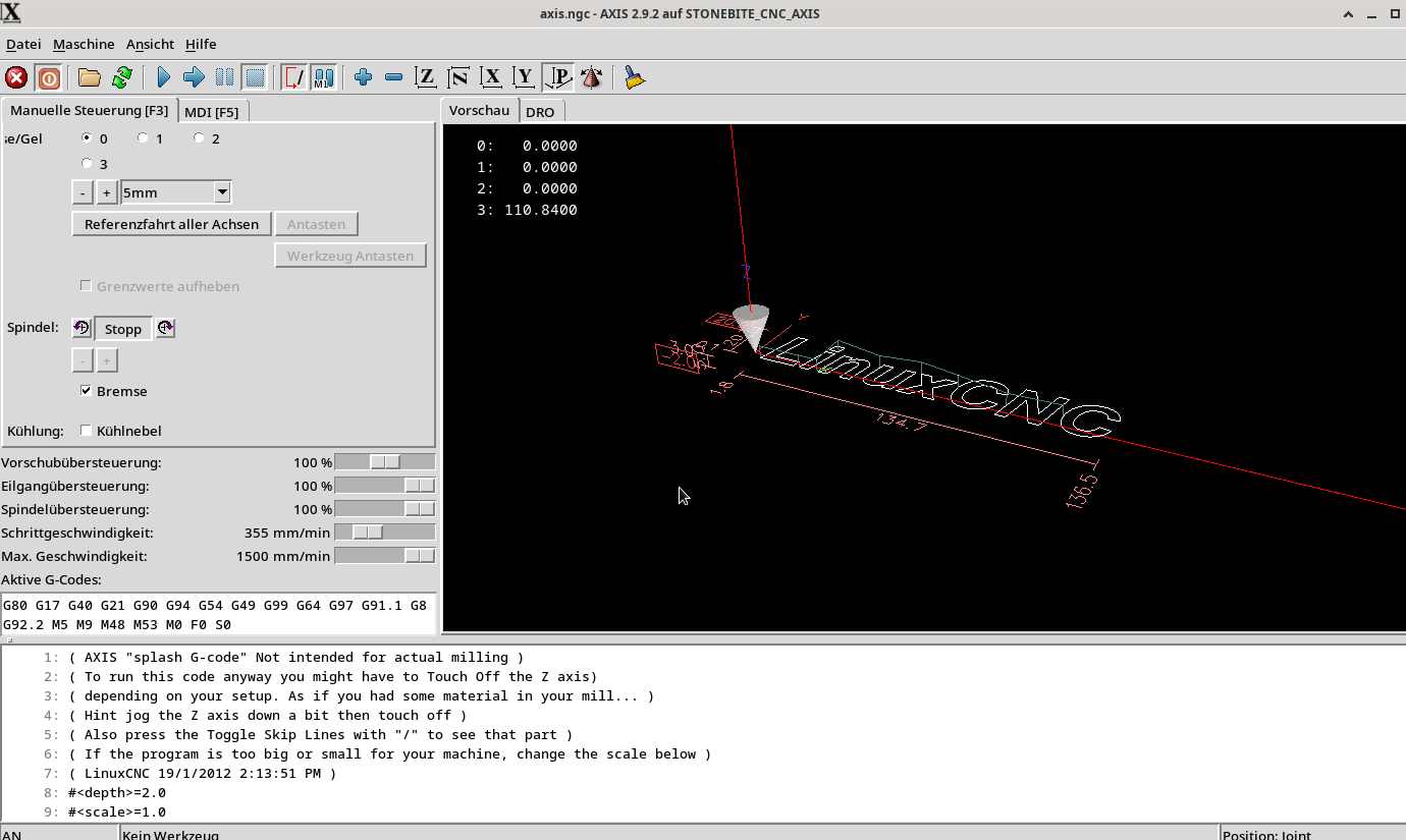

Did you try moving the machine?
- stonebite
- Posts: 118
- Thank you received: 10
06 May 2024 04:19 #299922
by stonebite
Replied by stonebite on topic PNCconf 7i92H and 7i76
i am confused, i would like to ask my question again about my understanding.
which axes of the machine should I move?
for me the question arises, is the generated PncConf file a pure simulation, or does it already affect the real machine?
If the latter, I would like to know how the file can intervene? Does the FPGA have the necessary information?

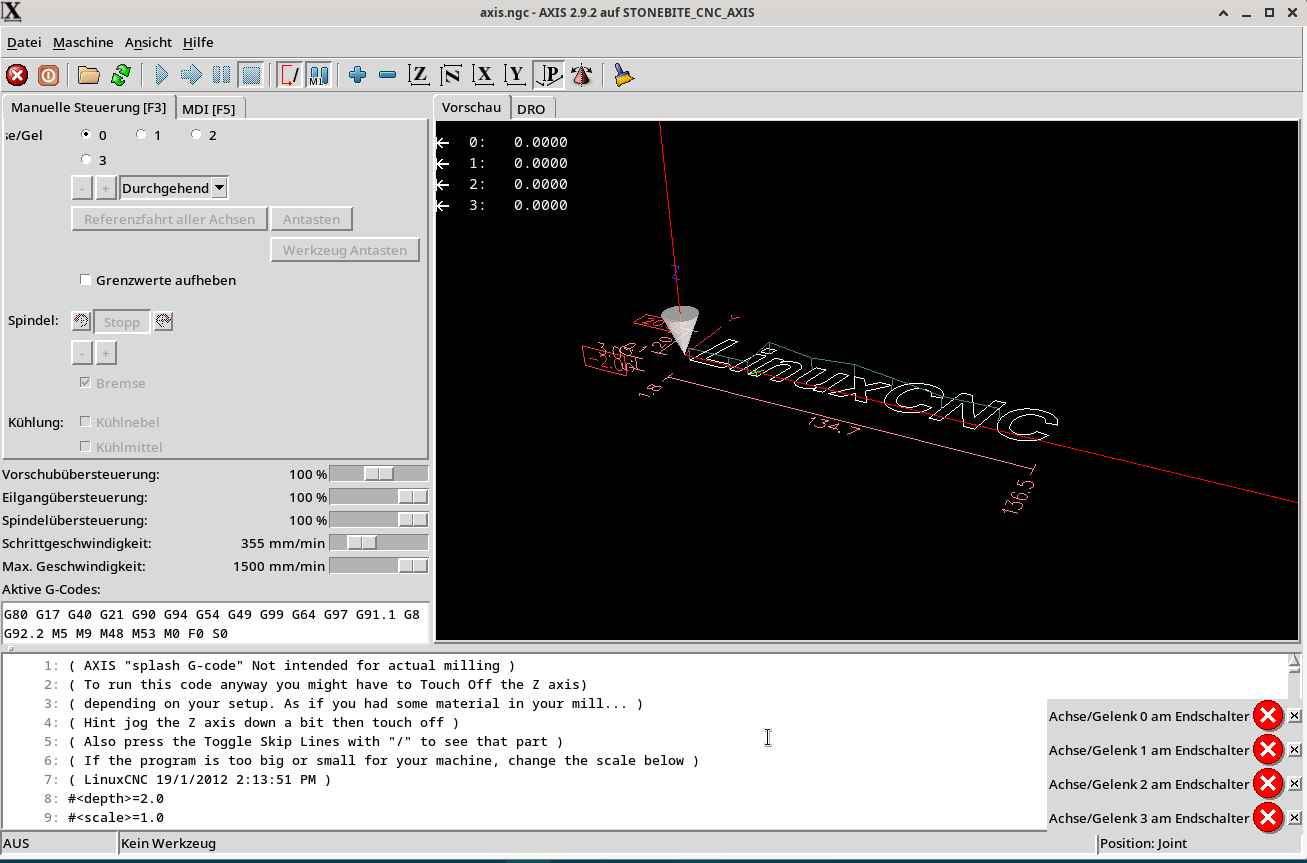

Use PncConf to edit the existing config, on the input pins page invert all 4 sensor pins.
Edit.
First make sure the sensors are not triggered.
Edit.
