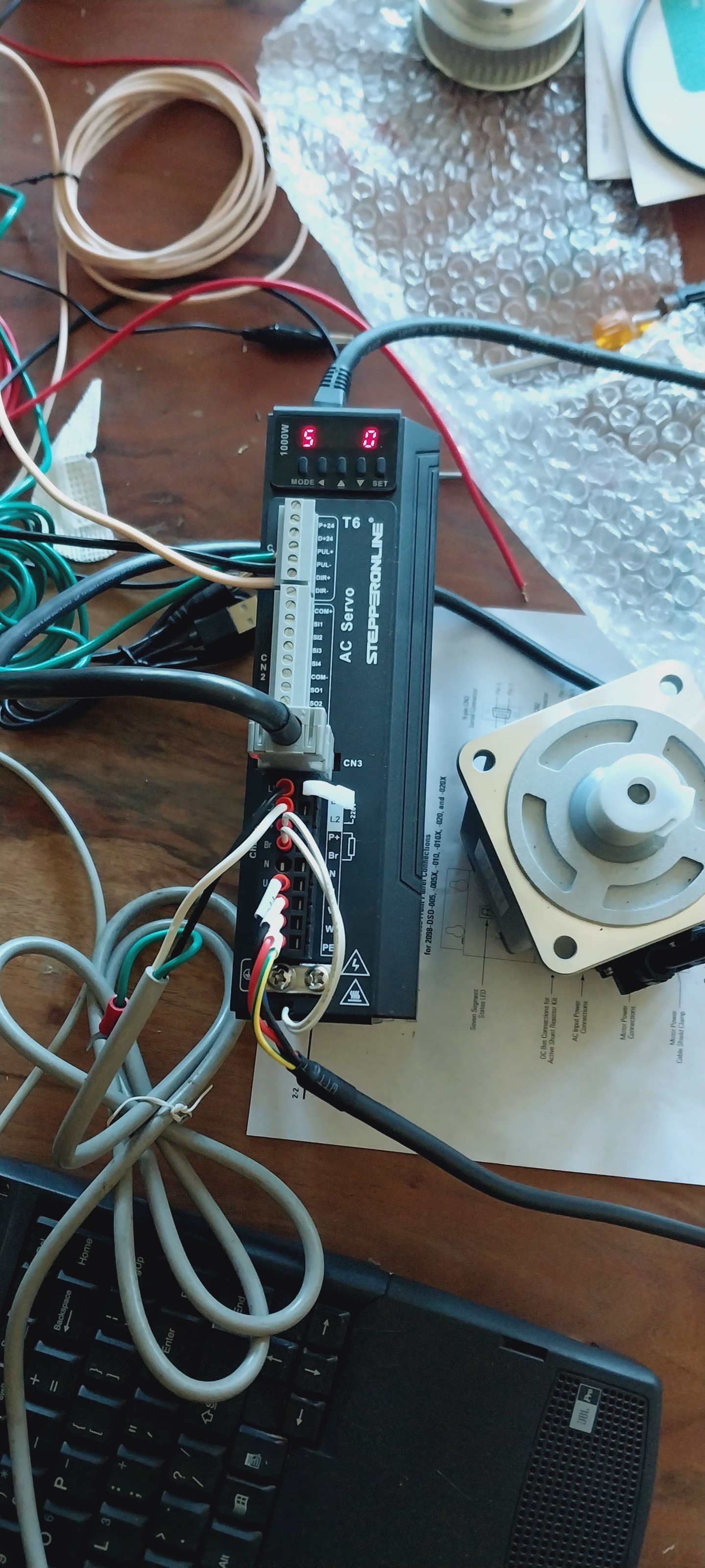

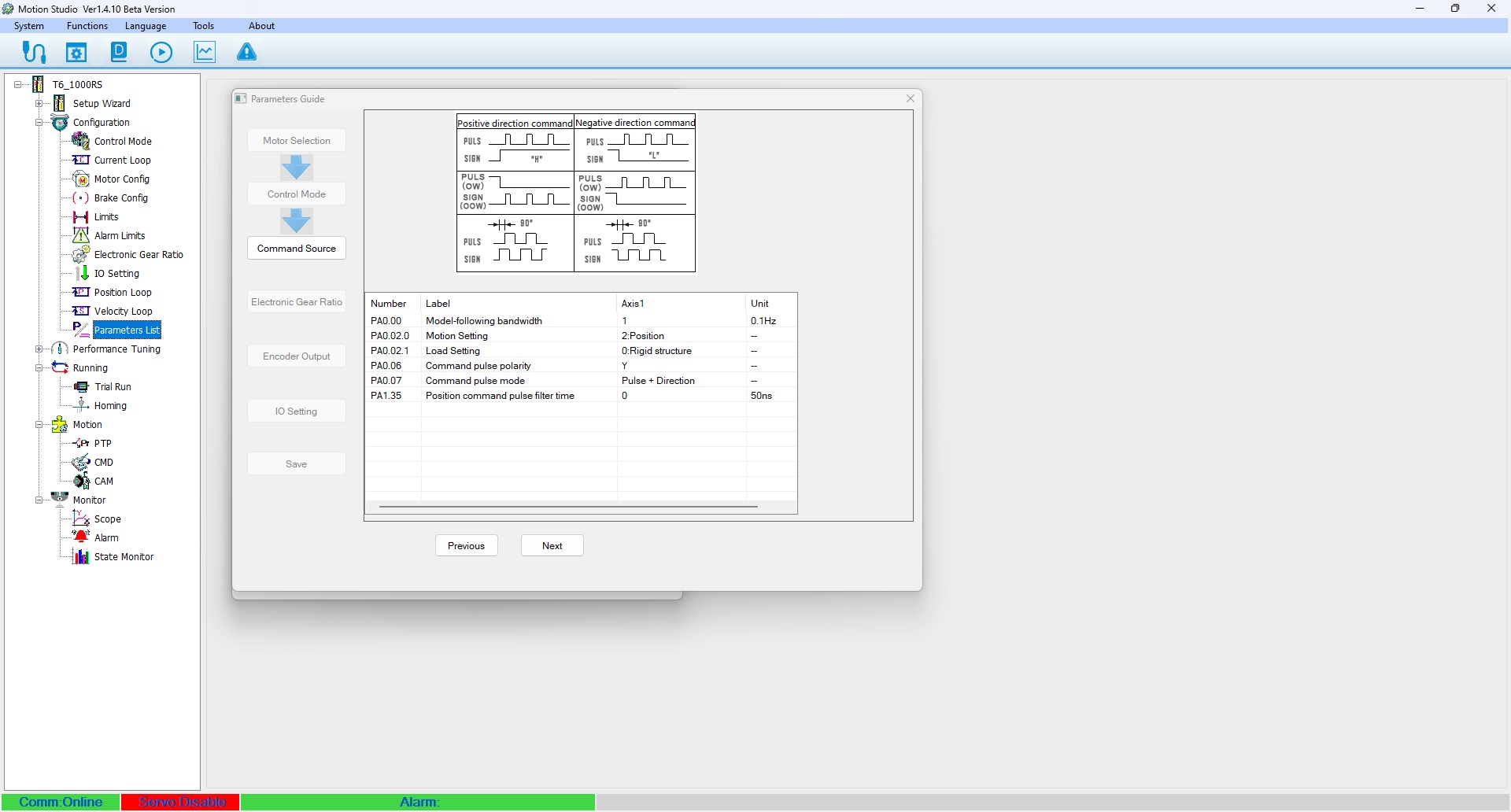

Hi, is anyone familiar with the StepperOnline T6 servo drives? I had got one a few weeks ago as they are sold as a complete kit including motor and cables and are supposedly a ready to run kit. Well, I got mine and connected the step/dir wires to a mesa 7i96s then in the Pncconf wizard I go to test the axis and there’s no movement. When I connect to it using the diagnostics cable and Motion Studio configuration software it starts rite up and I’m able to jog it. Does anyone know if there’s some kind of special parameters settings needed on the drive to make it work?
I see in the manual it says something about how “frequency for both input mode signal is 500kHz(Differential), 300kHz(Single-ended).” Is Pncconf using the correct frequency or is that something I should be looking at? Thanks Or how can I set this up as a spindle using step/dir? Thanks

Well for now its still set on the default 5000 but I did try increasing/decreasing it and still no luck. Also when I enable and jog it using the drives Motion Studio software I notice theres an internal fan that turns on for cooling and the diplay on the drive also changes and the shaft on the motor becomes locked and cant turn it. When I enable the servo from Pncconf it doesnt turn on or do anything at all? I even tried enabling the servo from the Motion Studio software then try and send it step/dir signals from Pncconf and no luck. Is there somthing that needs to be programed to tell the drive to enable first? This CNC hardware stuff is so sophisticated and there like no documentation on it

Ok thanks awsome this helped and it worked! Basicaly theres a parameter that needs to be set to turn the servo on then the axis will move when sending it testing signals from Pncconf. Ill make a video about it and post the link here after a couple celebration drinks! Otherwise its tough to explain how to enable the setting on these drives!

No need but thanks! I just figured it out on the led screen with the buttons I had to go into PA400 press the set button and change it from 3 to 38 then press the Set button one last time and unplug and replug the power restarting it and it then starts up in SVR-ON mode. Then im now able to use the step/dir signal port to control the motor. Awesome!I've got the exact same setup and had the exact same problem. If memory serves it needed to be enabled, I think I just connected a pin to 24+, a wire for 24+ and a gnd wire.
