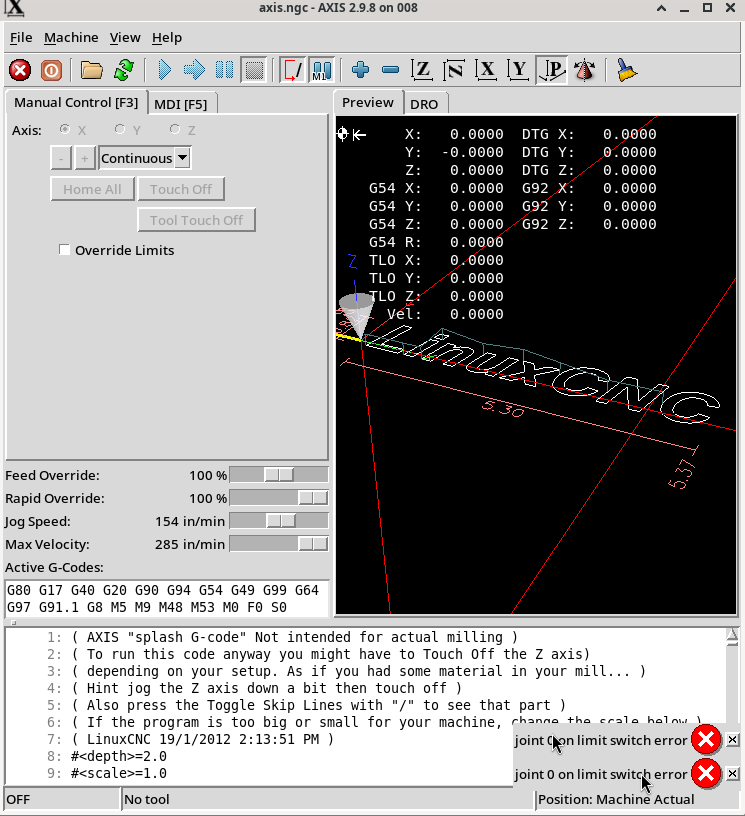

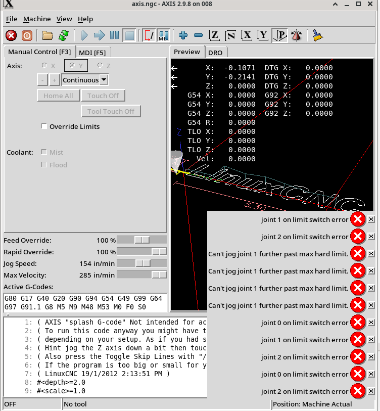

Set velocities low – less than half of previous values – no luck - started “playing” again changing other items as it appeared to me that some thing was interfering with the switch signals.
had to back off the ballscrew for the Y axis by hand each time as it would hit the limit switch and lock right there. No over ride limits would allow me to jog it away, but that does work for the X and Z - can jog them away after over ride limits.
So tried commenting out stuff just to find what was interfering and - in HAL did the following:

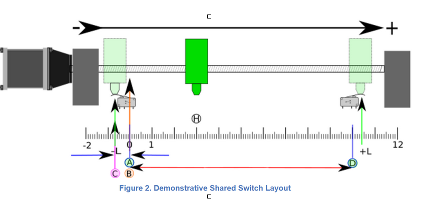

Pretty sure that if you have combined home/limit switches you will need a
HOME setting that's away from the switch actuation point or the ON LIMIT
errors are guaranteed.

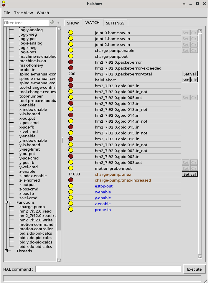

Did you verify that all home switch inputs work as expected in halshow?
that is, the motions home switch pins (like joint.0.home-sw-in ) change from
red to yellow when activated.
You might also check that there is no noise on the switch inputs.
(setting halscope to trigger on the switch active level can catch single cycle noise pulses)

Yes, I am just confusing myself now.
Yes, looked at Halshow - never done that before so I read a little and then picked what I thought would give the best info.
So, I re-enabled the Y & Z both home limits. All home switches active. I made sure for each test I over road the limits and enable/active Axis display before moving any switch and I got the following. Screenshot is ENABLED base Halshow.
Then I methodically tripped switches + and recorded what happened.
For the limit switches at both ends of each axis:
Again, 7i92 connected with short parallel cord directly to mx3660. All limits and ESTOP run through the mx3660 and then would report back to the 7i92.
Appreciate the input. I now have a few things to learn and can see how Halshow sort of works so will check what I have which isn't much - enable, limit switches, Z probe only, external ESTOP.
Finally, I looked everything over for type mistakes but I am kinda deer in the headlights at this time so ask if you think something does not look right.
- joint.0.home-sw-in [my 7i92 X] yellow turns red when either switch tripped, then back to yellow on release
- joint.1.home-sw-in [my 7i92 Y] yellow turns red when either switch tripped, then back to yellow on release
- joint.2.home-sw-in [my 7i92 Z] yellow turns red when either switch tripped, then back to yellow on release
- charge-pump.enable yellow
- charge-pump.out blinking yellow / red
- hm2_7i92.9.gpio.005.in blinking yellow / red
- hm2_7i92.9.gpio.005.in_not blinking yellow / red opposite charge-pump.out
- hm2_7i92.9.gpio.005.out blinking yellow / red opposite charge-pump.out
- hm2_7i92.9.gpio.016.in red turns yellow when probe tripped
- hm2_7i92.9.gpio.016.in_not yellow turns red when probe tripped
- motion.probe-input yellow turns red when probe tripped
- probe-in yellow turns red when probe tripped
- hm2.7i92.0.gpio.003.in red not change when my ESTOP button active, but changes color when axis display button pushed
- hm2.7i92.0.gpio.003.out yellow not change when my ESTOP button active, but changes color when axis display button pushed
- hm2.7i92.0.gpio.003.in_not yellow not change when my ESTOP button active, but changes color when axis display button pushed
- Posts: 18111
- Thank you received: 5330
04 Mar 2026 20:17 #343864
Replied by PCW on topic 7i92T and mx3660 request for help
Well the first thing is that all home switches are inverted...
The need to be false (dim red) when not activated and Yellow when activated.
(whoever chose those colors should be punished somehow...)

Ok, changed all in_out to in and the axes and everything stays enabled - I can jog them. They go in the right direction.
Since I have changed all the limit settings will revisit that later. Many thanks. Your in the run.
Now I need to play with getting my homing back to normal and get the axes unlimited and start uncommenting other stuff too.
Funny, the homing was INVERTED in Stepconf, but now is not in Pnnconf. Also the latest Pnnconf instructions do not match the Pnnconf I see on my machine. ????? documentation must be lagging I guess, realize everybody is busy and this is a free program......
Thanks again.
