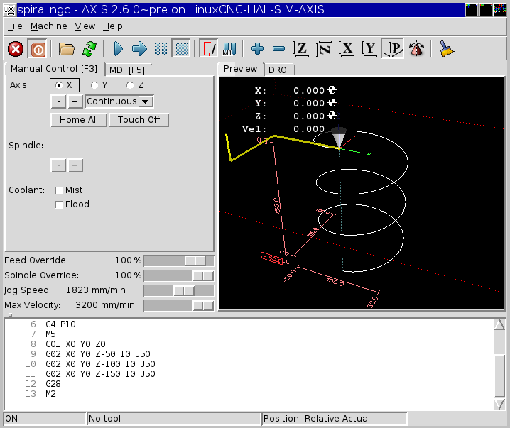

16 Aug 2013 19:10 - 16 Aug 2013 19:12 #37741 by DaBit
Replied by DaBit on topic Overriding feed rate in a subroutine
OK, thanks so far. This problem is perfectly solved.
I have two more:
- How do I rotate the coordinate system in such a way that jogging is also included? I am aware of 'G10 L2 P0 Rxx', but that doesn't work for jogging. The reason behind this: I would like to clamp a workpiece to the table without perfectly aligning it, touch off two known features, and calculate a coordinate transform. It would be nice if I can plug in a 4x4 matrix somewhere to convert workpiece coordinates to machine coordinates.
- How does one create a 'perfect spiral'? I can approximate one using line or (better) arc segments, but it is not a 'perfect continuous' spiral.
If you would like me to create separate topics for this: fine with me.
Last edit: 16 Aug 2013 19:12 by DaBit.
16 Aug 2013 19:51 #37743 by ArcEye
Replied by ArcEye on topic Overriding feed rate in a subroutine
Depends exactly what you mean by spiral.
This will produce a downwards cutting helix
G01 X0 Y0 Z0
G02 X0 Y0 Z-50 I0 J50
G02 X0 Y0 Z-100 I0 J50
G02 X0 Y0 Z-150 I0 J50
Or do you mean a plot which remains in the same Z plane and goes from outside diameter to the centre?
regards
16 Aug 2013 20:21 #37744 by DaBit
Same Z plane. Like this:
Code used to generate this is also in the image, and is hacked together quickly (so not too good).
Quite a close approximation to a spiral, but still an approximation consisting of multiple arc segments.
I keep on thinking that such a basic shape as a spiral should be very easy to generate, but I just don't see it.
