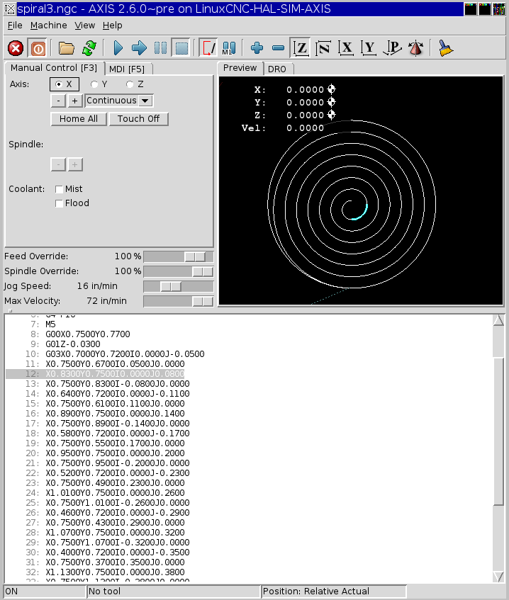

That is pretty much all I have ever done, increment or decrement the radius over a series of G2 or G3 calls
The only thing I have used a spiral for is cutting out circular pockets.
The first cut is the outside diameter and then the spiral clears the waste inside, with an increment per 360 deg just less than the cutter diameter
16 Aug 2013 20:47 #37746 by ArcEye
Replied by ArcEye on topic Overriding feed rate in a subroutine
This is an imperial, CAM produced one, but same method basically
I was hoping that there was a more natural way to create a spiral, but OK.
Which is also my main purpose. I actually cut circular pockets a lot since I currently only have a high speed spindle on my (BF20/G0704) machine so i can use twist drills only up to a small size.

Once more about arcs. I would like to submit some 'feature requests':
- Floating point P parameter. It would be nice to be able to easily program a partial circle (arc) starting from the current position, rotating with IJK coordinates as center. Currently P must be at least 1.0 (and probably an integer; didn't check that yet).
- Something like a G2.1/G3.1 which interpolates arc radius so one can start with r=10 and end with r=5 for example. Would be great for things like ellipses, spirals, HSM-like toolpaths, etc. We do have NURBS and quadratic splines, but these are not easy to program manually.
Where do I submit these?
Actually, "P" is a LinuxCNC add-on to the standard arc-code, and the way to do a partial circle is to have no P at all.
You have to specify end-point, not angle, though.
If you want to define moves by angle and radius, have a look at:
linuxcnc.org/docs/html/gcode/overview.html#_polar_coordinates
