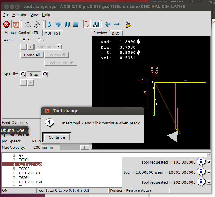

27 Jul 2014 23:14 #49196 by andypugh
Replied by andypugh on topic Gcode preview and remap
Yes. It appears as if the program is stuck in the g-code subroutine handling M6, but i do not believe this problem occurs after the last M6 in a g-code file. So for g-code files with one M6 command it works as it should.
This isn't the behaviour I am seeing in the VM where I am testing a remapped T-word
(lathe-style tool changing)
The first tool-change is highlighting the wrong line in the program, but the second and third don't even make that error.
None of the tool changes alter the displayed G-code file.
28 Jul 2014 00:35 #49199 by orangecat
Replied by orangecat on topic Gcode preview and remap
I think this is likely due to the fact that you've remapped T instead of M6. I think there's additional problems caused when the M6 subroutine calls M6 (special code prevents recursion by ignoring the mapping when M6 is called inside the M6-mapped subroutine.) To be certain, before i included M6 in the tool-change subroutine i had far fewer problems.
