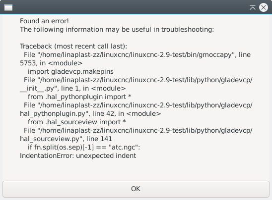

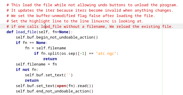

I tried make dirty fix:
It dont work. Probably I need modification for Python 3 from Python.
I would like ask you for help.
21 Sep 2023 11:13 - 21 Sep 2023 11:15 #281291 by rmu
Replied by rmu on topic Gcode preview and remap
it says right there at the end of the error message. In python, indentation is part of the syntax. It needs to say
if fn == None:
fn = self.ilename
if fn.split....
notice same indentation level, you have additional indentation on the line with "if fn.split...". rule of thumb, if the previous line is a complete statement (no open parenthesis, ...) and doesn't end with a colon (":") then next line must be on same level.
Last edit: 21 Sep 2023 11:15 by rmu.

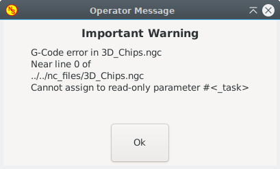

21 Sep 2023 11:46 #281296 by zz912
Replied by zz912 on topic Gcode preview and remap
I tried this:
o<ATC> sub
#<_task> = 1
G53 G1 Z-195 f20000
G53 G1 Z0 f20000
#<_task> = 0
o<ATC> endsub [10]
m2
But #<_task> is only readonly parameter.
