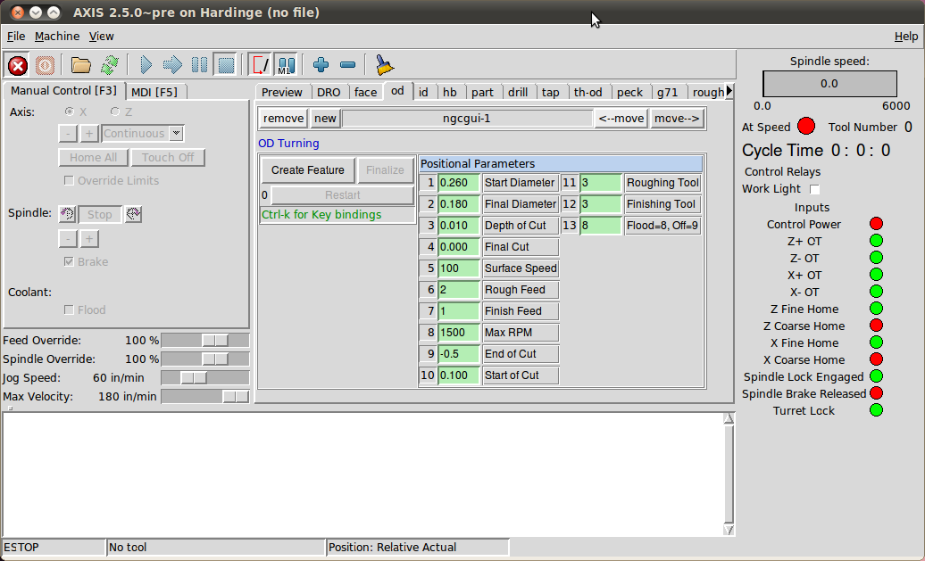

06 Mar 2011 11:53 #7609 by cwmk577
Replied by cwmk577 on topic Re:Subroutine GUI
Is there any way to adjust the packing of the UI elements, i.e. to make them stack vertically or put scroll bars on the fram? I am using an 800x600 touchscreen and in Axis a lot of the fields get cut off. I don't mind tweaking code but I am not at all familiar with Tcl.

06 Mar 2011 13:32 #7611 by Pilotltd
Replied by Pilotltd on topic Re:Subroutine GUI
Alternately, is there a way to run in standalone mode with multiple tabs? While I like having it inside Axis it's not a dealbreaker to run standalone. But I do really like being able to define multiple operations into a single part file.
Same thing was happening to me with 1024x768 screen. The solution I found was to remove the font information in the ini file.
Make the line
NGCGUI_FONT = HELVETICA -10 normal
read
NGCGUI_FONT =
It now resizes properly to show as tabs in axis without anything being cut off.

28 Mar 2011 15:37 - 28 Mar 2011 15:38 #8223 by BigJohnT
Replied by BigJohnT on topic Re:Subroutine GUI
An updated screen shot of my lathe config.
John
