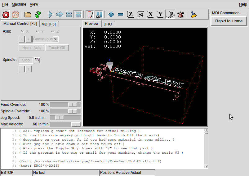

If you didn't have a pyvcp panel before in your xml file you will need the following in your MyPVC.xml file.
<pyvcp>
<labelframe text="MDI Commands">
<button>
<halpin>"rapid-to-home"</halpin>
<text>"Rapid to Home"</text>
<font>('Helvetica',10)</font>
</button>
</labelframe>
</pyvcp>
Also in your ini file in the [DISPLAY] section you will need
PYVCP = MyPVC.xml
the above line is what loads the pyvcp panel.
Get the button to show up first then the rest will come together.
John

04 Apr 2011 10:36 - 04 Apr 2011 10:51 #8453
by piasdom
Replied by piasdom on topic Re:Subroutine GUI
ok, i have that in my MyPVC.xml file and PYVCP = MyPVC.xml in the [DISPLAY] of axis.ini.
still no button. will the button be all the way to the right or with the regular buttons on the left ?
could the axis display be over it ? i mean the button is there just covered.
and should the MyPVC.xml file be in the EMC folder or the axis folder?
i tried both
i tried both
Last edit: 04 Apr 2011 10:51 by piasdom.

04 Apr 2011 11:45 - 04 Apr 2011 11:46 #8467
by BigJohnT
Replied by BigJohnT on topic Re:Subroutine GUI
