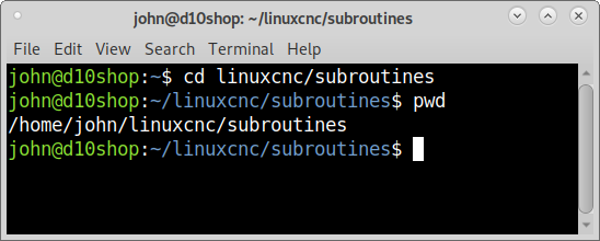

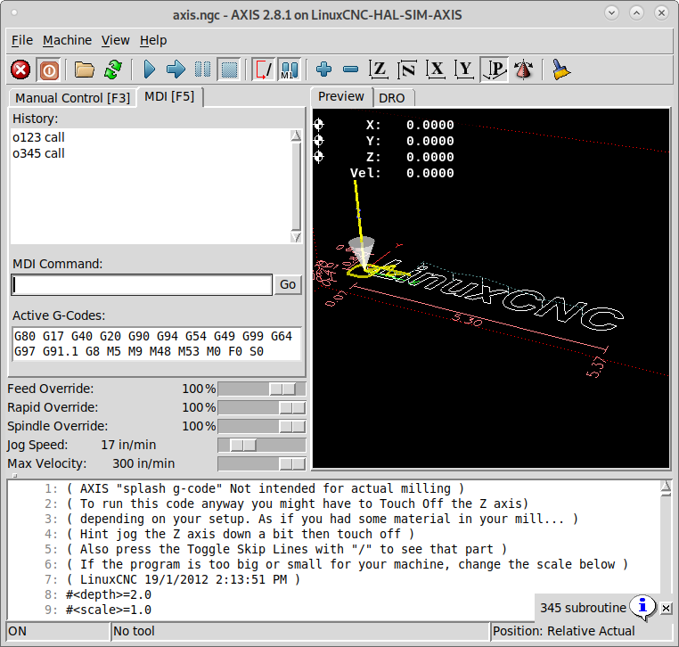

I went to /utilitysubs opened terminal and copied directory. sudo -i . chown -v name cat > program.ngc . Printed texted and ctrl + z . Either /utilitysubs or /subprograms paths not recoverable yet or something else about the pop-up box: Unable to open file <111>.

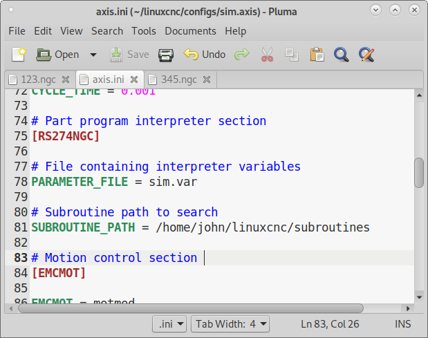

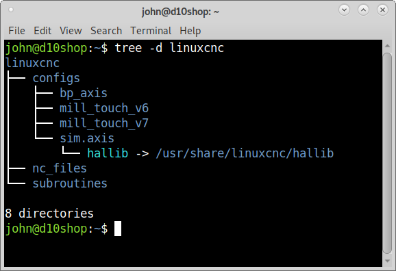

My /linuxcnc/subprograms ls show subprograms.ngc. I just went to the /linuxcnc/configs/sim.axis/axis.ini and texted in SUBROUTINE_PATH = /home/name/linuxcnc/subprograms and save. I would of expected PARAMETER_FILE = sim.var goto /utilitysubs folder before now seeing it in the axis.ini file. Reloaded Axis program is still same error pop-up box. My main program and line syntax is just ' o111 call ' if to retrieve the subprogram.

Yes. Present version AXIS 2.7.0 LinuxCNC-HAL-SIM-LATHE rtai.

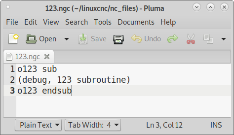

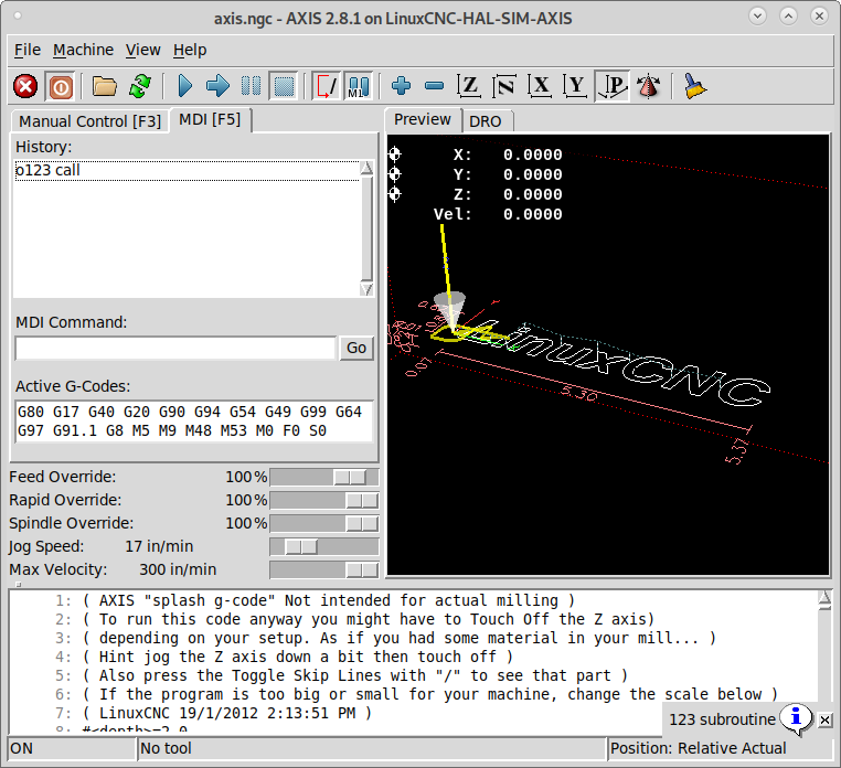

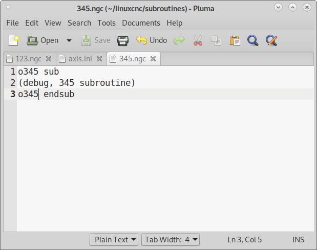

Your ini file looks correct.
Does the attached subroutine work for you?
JT
JT

Does my simple subroutine work for you now?
