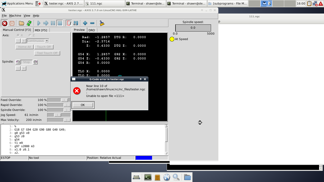

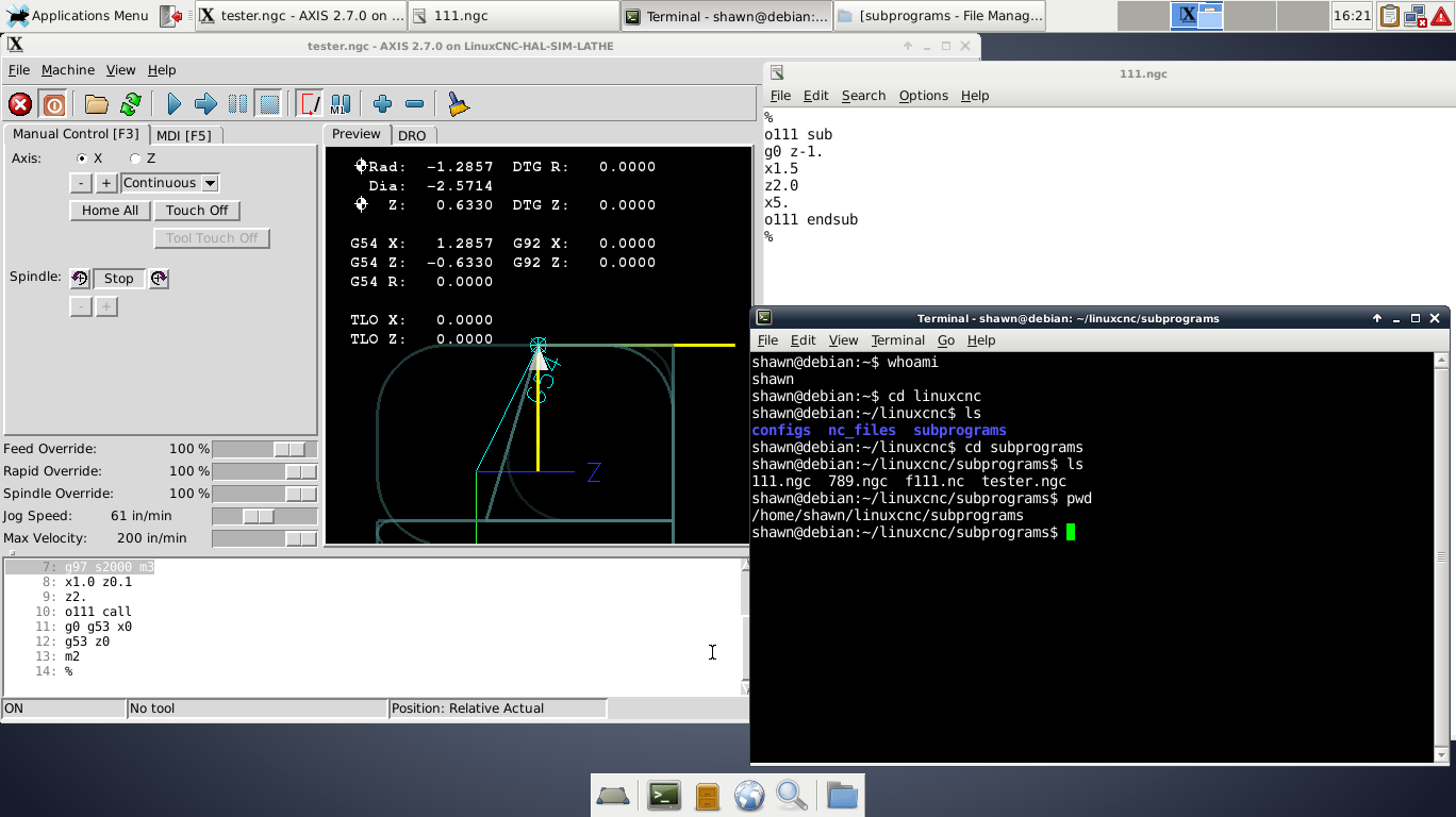

My computer user name is shawn. whoami does return user shawn whom is me. pwd does return the same directory as at axis.ini and SUBROUTINE_PATH=/home/shawn/linuxcnc/subprograms. Yes, I did try your program 123.ngc (debug) and only call able if at nc_files which, is the same folder the main program tester.ngc is located. My test program 111.ngc is only call able if at nc_files which, is the same folder the main program tester.ngc is too. o111 call cycle did run and verified at digital read out. Only indication that o111 calls from main program is during auto cycle and digital read out and o111 program not on display. Not always the subroutine from the same folder as the main completes cycle and hangs either at the subroutine or main program. Trying to Reload the main program and either 123.ngc or 111.ngc from the /subprograms folder is a pop-up box unable to open either file <123> or <111>. It seems that trying to call a subroutine from another folder still isn't recoverable. I removed my subroutine path from the rs274ngc.inc meantime since you suggested the path at the axis.ini file and still a pop-up box error unable to open subroutine. Is other or added suggestion?

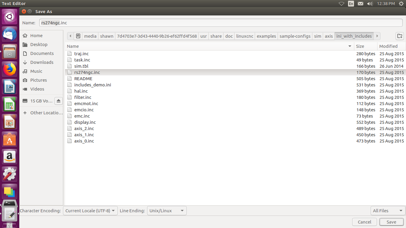

I'm not sure what rs274ngc.inc is for. Looks like it's some kind of example for multiple includes.
Either the path has a typo in your ini file or you have two [RS274NGC] sections.

Foregoing subroutine path, /subprograms, MDI, o111 call able and visible with digital read out now. Maybe Axis had to be closed and opened to reset. Sudden, no pop-up error box unable to open file <111>. Running main program and calling o111 still hangs near end of main program and not traveling home. What could cause the hang?

Replied by smplc on topic Save subroutine file and location
Main program hang upon calling subroutine was the subprogram had a percent top of and end of block. Removed percent's and main program called subroutine and no hang, returned to main and traveled home. A percent has to be after m2 if used with subprogram.

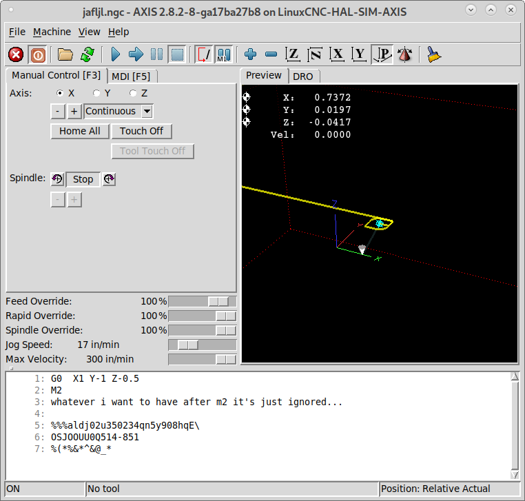

- BigJohnT
- Posts: 3981
- Thank you received: 994
03 Jul 2021 13:35 - 03 Jul 2021 13:40 #213561
by BigJohnT
Replied by BigJohnT on topic Save subroutine file and location
Nothing is executed past M2 or M30.
linuxcnc.org/docs/2.8/html/gcode/m-code.html#mcode:m2-m30
As you can see in this screenshot I can put anything I want after M2 and it's a valid file because nothing is used after M2.
Wrapping G code with % is different than using a program end.
linuxcnc.org/docs/2.8/html/gcode/overvie...de:file-requirements
JT
JT
