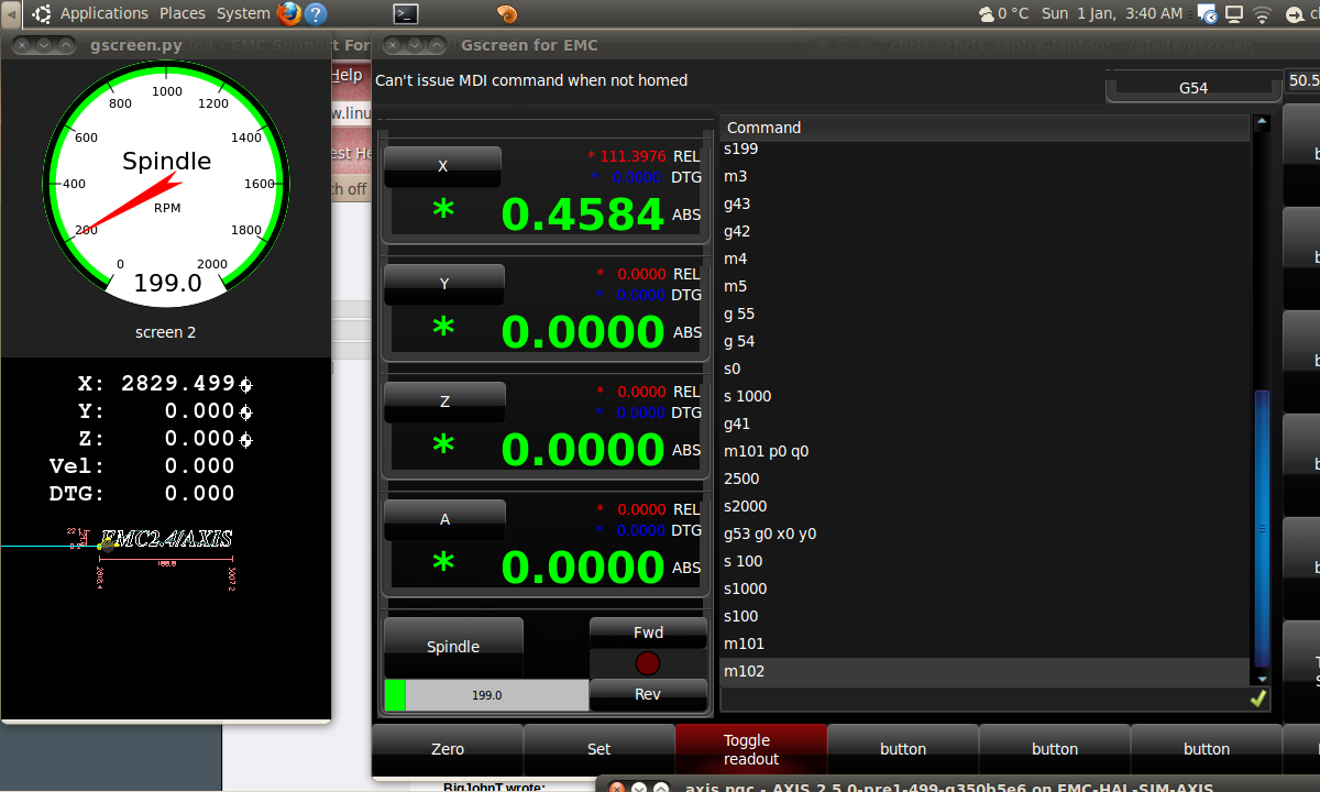

01 Jan 2012 11:45 - 01 Jan 2012 11:51 #16178 by cmorley
Replied by cmorley on topic Re:GUI Discussion
here is another shot not much different.
there is actually two screens here - the second one would go to a second monitor or could be not shown.
I can see getting the buttons and status indicator, without clutter right is gonna take some planning.
Last edit: 01 Jan 2012 11:51 by cmorley.
01 Jan 2012 12:41 #16179 by cncbasher
Replied by cncbasher on topic Re:GUI Discussion
looking good Chris ,
i'm not to sure over the spindle speed dial size in relation to the rest of the screen , althoug i appricate it's scaleable etc
i'd be tempted to have it small around the size of the dro's for example , and probably a fixed size leaving the rest of the screen usable
but it's looking exactly along the lines i'm thinking of , yes keeping the clutter out is the major headace
having a seperate screen for diagnostic listing would be nice i.e halpin listing
feed rates etc keep to the buttons as in touchy , would save space and lesser used functions
i'd say have a home axis screen from machine start , then once homed it changed to the above screen
after all until the machine is homed everything else is not needed
and a jog menu screen
i much prefer the look as it is at the moment simple screens ,
and probably split over 6 screens to cover everything
keeping the important major items to one screen

02 Jan 2012 06:23 #16197 by KPA
Replied by KPA on topic Re:GUI Discussion
Chris,
The spindle gauge is nice looking as it adds some splash. but my thought would be to change the "Vel:" label to "Feed:" (more intuitive), and to have the spindle speed as "RPM:" just under the Feed: This is one of those 'less is more' thoughts.
What I would really like to see in the gauges (linear or dial) are load meters for each axis, with a memory tick on the dial that remembers the highest load encountered - perhaps an alarm when an overload condition occurs.
Jay
02 Jan 2012 07:36 #16198 by cmorley
Hey guys.
The second screen is just there to prove the concept. The objects, sizes and placement are in a state of flux.
The size of the spindle dial readout is too big I agree. I just didn't adjust it. i added it just to prove out the program and to see which display is better. (there is a bar graph for spindle speed on the main page).
Jay - the labels you are referring to are part of a gladeVCP widget so I cannot change them unless I commit code to EMC (which I might later)
The option at the moment is show the readout or don't - as you can see the main display I have turned it off as I have my own DRO. (you can't see that screen in the pic)
Peak meters are an interesting Idea. either as an option to the existing meter or bars or as a separate widget. This would be code added to gladeVCP again.
I'm close to having it be able to actually do something in manual mode. then I'll add MDI It will still need to be used in tandem with a regular GUI.
Then maybe I'll post a test code for people to play with.
So we all agree a keyboard being required is not the end of the world? Even if it is, to begin with It will be required.

02 Jan 2012 19:37 - 02 Jan 2012 20:02 #16219 by KPA
cmorley wrote:
..i added it just to prove out the program and to see which display is better. (there is a bar graph for spindle speed on the main page).
Hmm.. good question.When I look around I see analog dial gauges everywhere. Bar type of guages less so. That's probably historical due to how mechanical gauges are built. However I feel both gauges convey information well. I think it will boils down to a 'Traditional' style (dial) vs a 'Modern' style (bar)
cmorley wrote:
..part of a gladeVCP widget so I cannot change them unless I commit code to EMC..
And therein lies the big issue. To build out a modern controller is no small task. I've been pouring through the AXIS code recently, and I see redundant code, scattered code, and just plain lots of code. None-the-less it has a LOT of features, things that fall outside of a common CNC controller and more into experimental or University uses. Things like joints, complex kinematics, full 9 axis, and I hear multiple spindle in the wish list. Terms like Max Velocity - nobody says that, in the CNC world it's feeds and speeds (feedrate and RPM). Personally I think EMC2 has enough capability in the back-end, and with the right team doing add-on development - to run something like Big Dog
You know it's exciting to work with this capable of a program, it reminds me of my University days when we were writing a control system to power a Golf Cart with a Ballard Fuel Cell.
As for front ends,
AXIS tries to be all things to all people - it caters to all of the above type of uses. To maintain that kind of application requires a real team effort, good architecture and good modularity. I went into the Sourceforge Tracker to see the outstanding bugs and feature requests, many open ones go back a couple of years. I think our development team is taxed out.
This begs a futher question, do we encourage folks to contribute to the main GUI, if so perhaps to modernize the look and feel and code structures to attract more developers, or do we start building purpose-built front-ends for specific machine types. Hmm.... now that I think of it, this is open software, so we do both!
I think it's fundamental
Chris, I think you're doing good work putting this together - no small feat!
Jay
