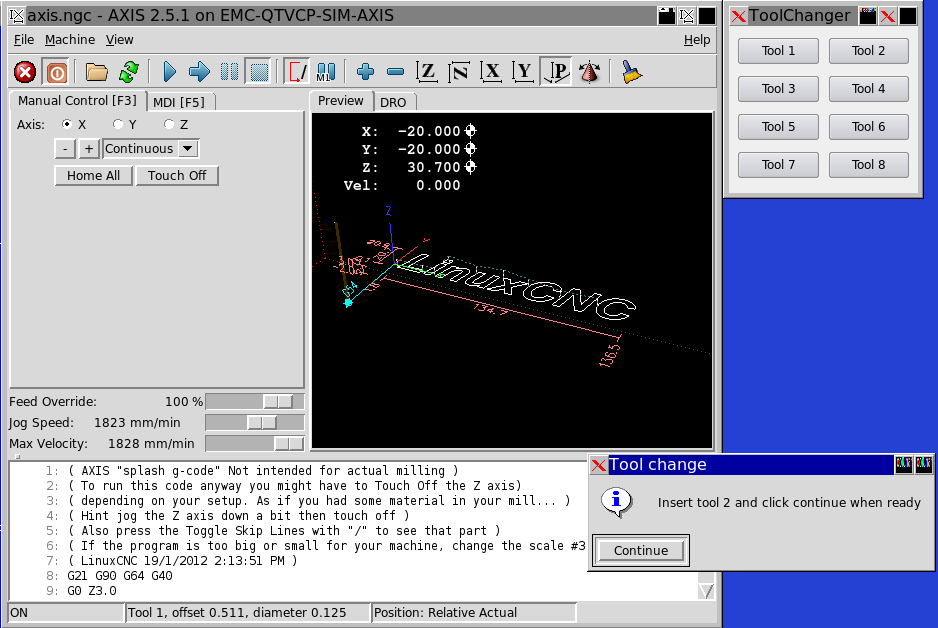

I am using Qt4, now that I have got my head around the changes from 3, I prefer it.
The uic conversion of .ui to a header file with the graphical setup for the program, is a very powerful tool when you get used to it.
In C++ it means you can write a class which inherits the class created by uic and create the entire graphic interface just by calling setup_UI()
Don't know if it is quite the same with the python bindings.
It allows you to program the GUI completely graphically in Designer, make changes and it is compiled on the fly without affecting your code.
(assuming you use qmake, .pro files etc)
I have lots of changes and polishing to do, as I gradually test all the library functions, but in due course I may well publish it.
Presently I am patching Axis to read a [QTVCP] section in the .ini file and based upon the entries spawn the qtvcp binary and then parse a qtvcp.hal file to make all the necessary pins connections.
You may be able to help.
I am having trouble getting the .ini file name from within Axis so that I can spawn the qtvcp binary with that as an argument
sys.argv[2] should contain it, but it is returning rubbish when I use it. I think inifile is actually a class rather than a string.
The linuxcnc script create an env variable $INIFILE with that name but I can't seem to grab that either.
Any ideas ?

29 Oct 2012 16:52 #25986 by ArcEye
Hi Chris
For a user friendly qtVCP there cannot be a compiling step.
Depends whether you are bothered about following the pre-existing work flow processes or doing things differently.
To a large extent the perceived lack of compiling with python is erroneous, its just that the compilation to machine code takes place on the fly at run time.
One should make the panel in designer then load it inside of HAL with the loadusr command.
My panels don't need to use loadusr, they have access to the running Linuxcnc instance and all the HAL libraries.
They just need to be named in the .ini file and the patch to Axis spawns them like a normal binary
They create themselves, get their comp_id from the running instance, create and populate their pins. They could do the linkages to external pins too, but it is probably more easily maintained
to treat them as components and do these linkages through a .hal file.
Now if you are talking of building a full GUI screen for linuxcnc then I don't see the compiling step as such a barrier.
That wasn't my intention, but I can see that eventually I might go that way, it would make everything far easier.
My biggest problems come from trying to interact with Axis.
Are you embedding the QT panel inside AXIS? can you get the panel to match the basic look of AXIS (themes)?
At present I am creating a separate panel, embedding / docking with Axis is the major headache, whereas it would be simple if Axis were a Qt app.
No I most definitely not trying to match the look of the GTK widgets, I can't stand them!
Do you have a screen shot?
A very simple one of a test panel which mimics the toolchanger pyVCP that John put out at
www.linuxcnc.org/index.php/english/forum...changer?limitstart=0
Seemed a good enough place to start.
regards
