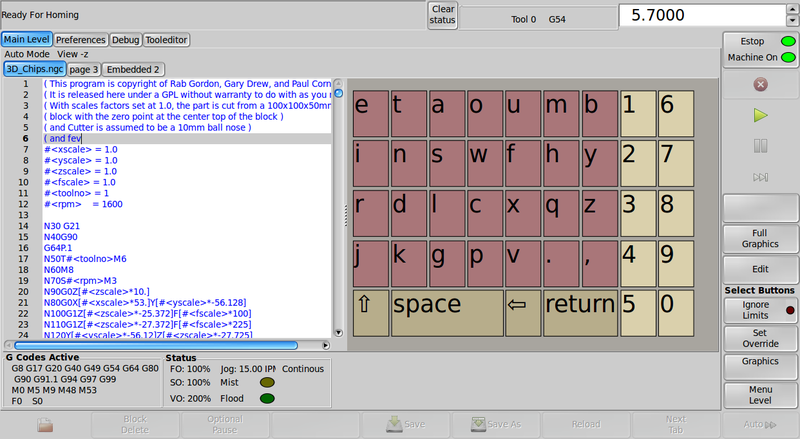

05 Dec 2012 10:08 - 05 Dec 2012 10:09 #27225
(sorry you have to reference the pic a few posts back)
This is for gcode editing? cursor keys on the bottom left? on screen keyboard in the middle (is that really enough letters?)
Can you explain the maintenance mode capabilities ?
Replied by cmorley on topic Professional machinist GUI
Chris,
I will get you answers on those questions. Plus add option 3, Maintenance. I added a hacked and choped theroitical screen shot of where this might be headed. Let me know if it is way out of line? It is a Fanuc and your gscreen mockup. Everything shown is a touch screen GUI not physical button.
Last edit: 05 Dec 2012 10:09 by cmorley.

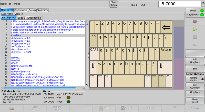

- Posts: 7947
- Thank you received: 2159
05 Dec 2012 17:26 #27233
I played around with some... I patched 'Onboard' keyboard program so I could embed it in Gscreen.
This is a couple of the scsreen shots... The keyboard is supposed to be user configurable. Unfortunately it also needs a patch to do this...
This Onboard program can be made to 'POP' up when needed instead without patching it - I have not tried that yet.
But this does look alot like what you are used to...
Chris M
Chris M

05 Dec 2012 17:35 #27234
by cncbasher
Replied by cncbasher on topic Professional machinist GUI
Chris,
Can the keys be cut back to the minimal needed , as in the fanuc display , I don't see a need for keys that are not required to edit gcode . this will reduce the area needed even more
but great look forward to trying it

05 Dec 2012 17:41 #27236
Yes the second screen shot is a minimal key if you press the shift key other keys show. It needs cursor keys though.
If you are using Ubuntu 10.04 open a terminal and type 'onboard'
play with it like that - there are four default keyboards available - you'll see an icon on the top tool bar click it for options.
Chris M
Chris M
- Posts: 7947
05 Dec 2012 17:44 #27237
I was noticing that when in program mode I have axis/spindle control keys that you don't really need.
Does the graphics screen need to be shown in all modes?
