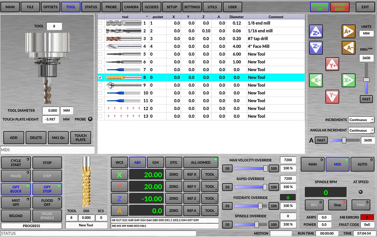

I do not appear to have a tool_offsetview.py file? Can I please ask you to upload it with your tooltable image mod please

I recently corrected this file and now it automatically creates horizontal images from existing vertical images. I'm away now and won't be able to send this file until the end of next week

Try modified tool_offsetview.py, located in /usr/lib/python3/dist-packages/qtvcp/widgets/
If the images are too small, you need to modify qtdragon.ui a bit.

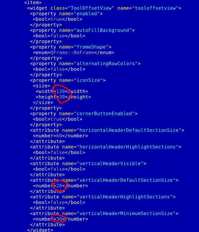

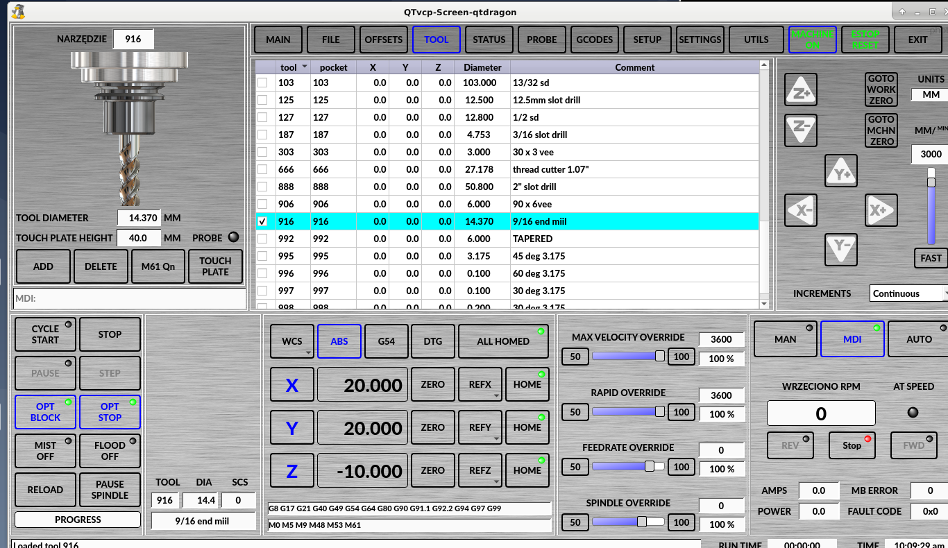

Your screenshot shows very small tool images, change these few values in the qtdragon.ui file as in the attached image and it will look better.

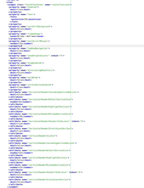

Good Morning, I have no iconSize in the tooloffsetview widget part of qtdragon.ui
Attached qtdragon.ui and screenshot.
Chris
