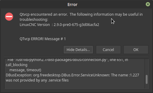

Fixed program prefix, still get the same errors, division by zero and missing preference file.
- Posts: 7368
- Thank you received: 2181
10 Oct 2019 22:09 #147660
Replied by cmorley on topic Screen shots of gui designs
add an empty file with the preference path to fix that error

Yup that did it, also moved it to the usual Linuxcnc config directory. Now it starts without errors but:
No images on probe screen
errors when closed, will check later
does load the file but there is nothing on the preview screen

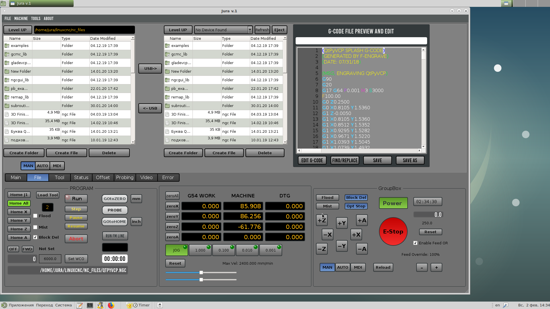

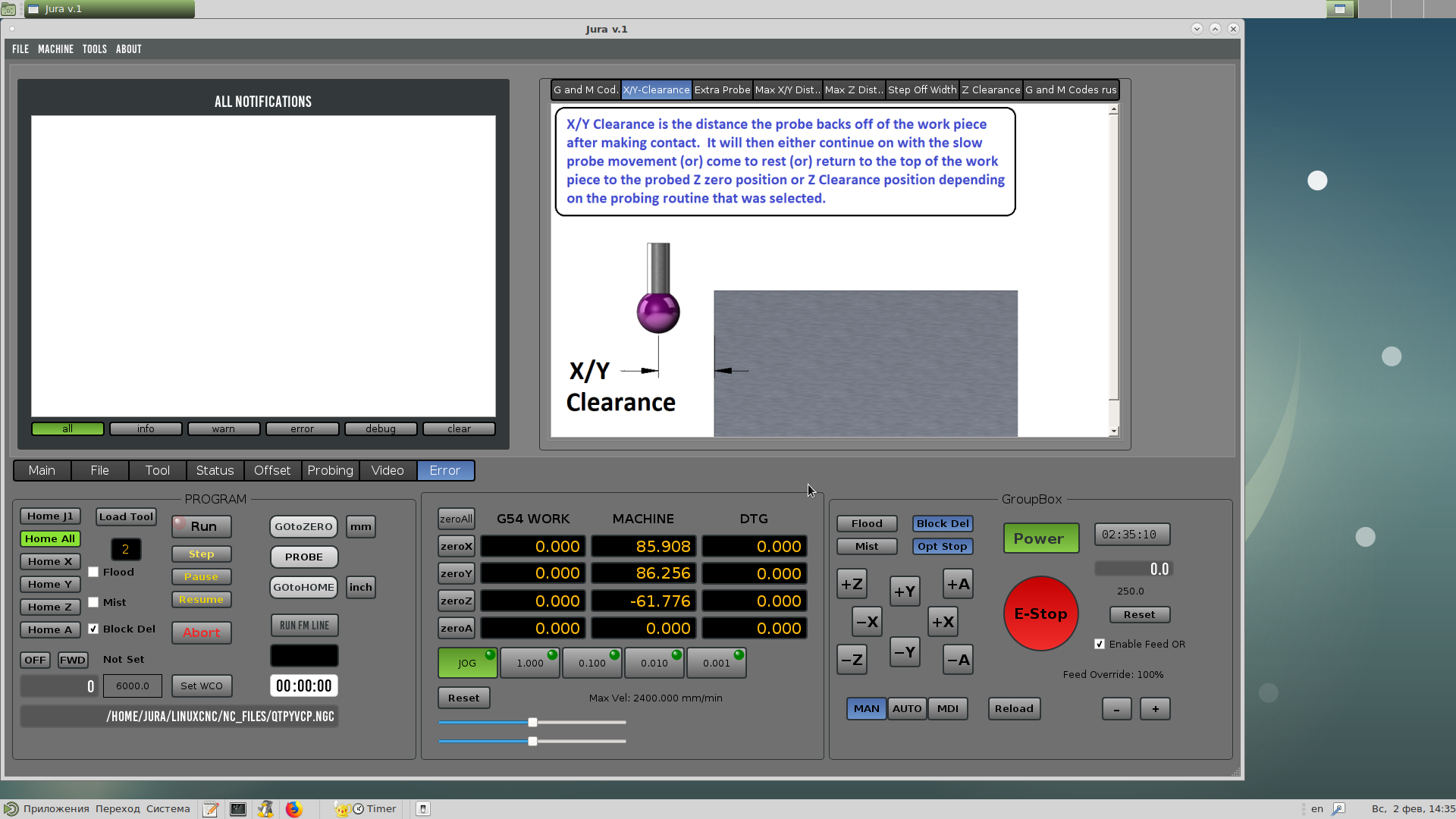

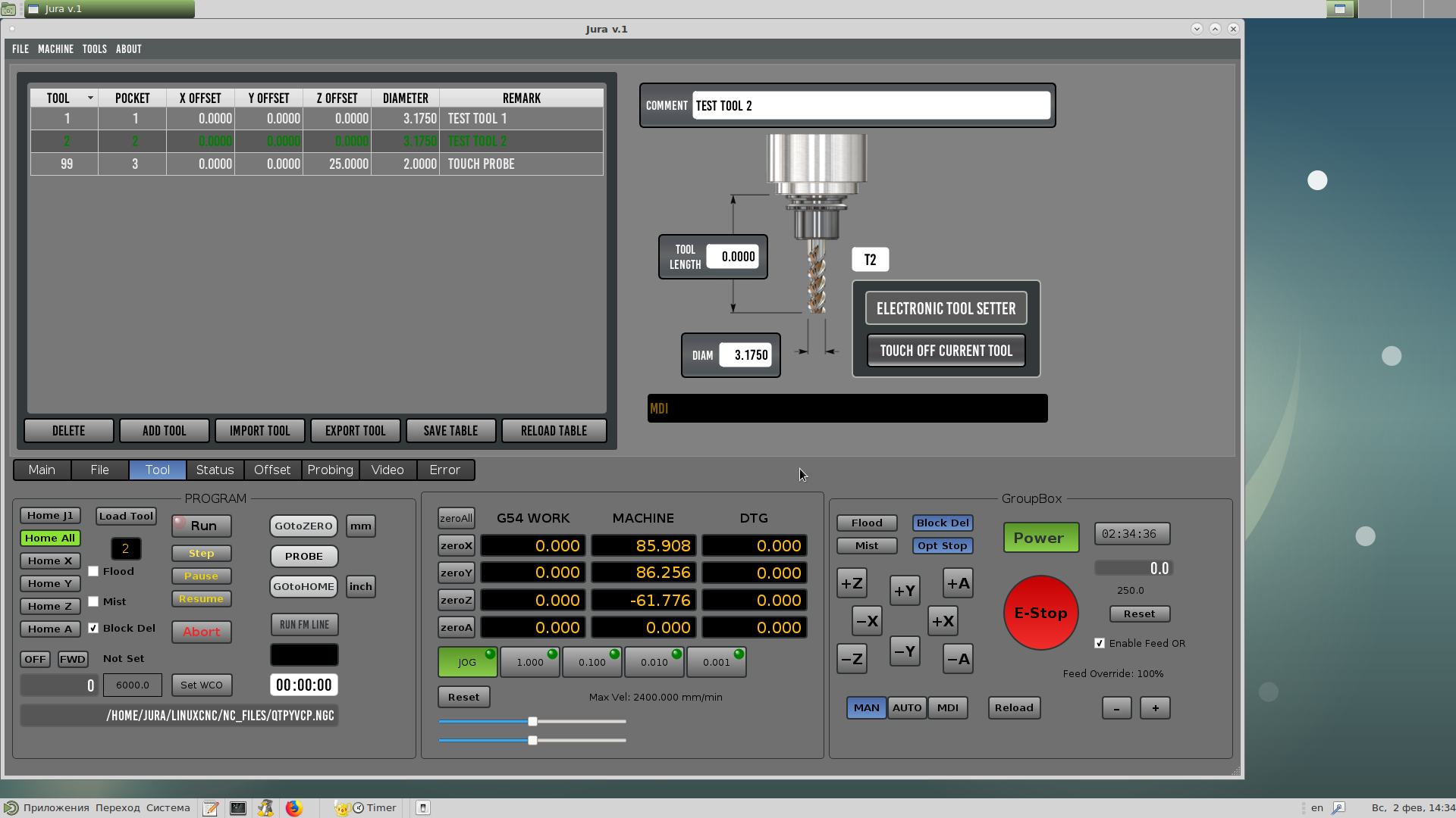

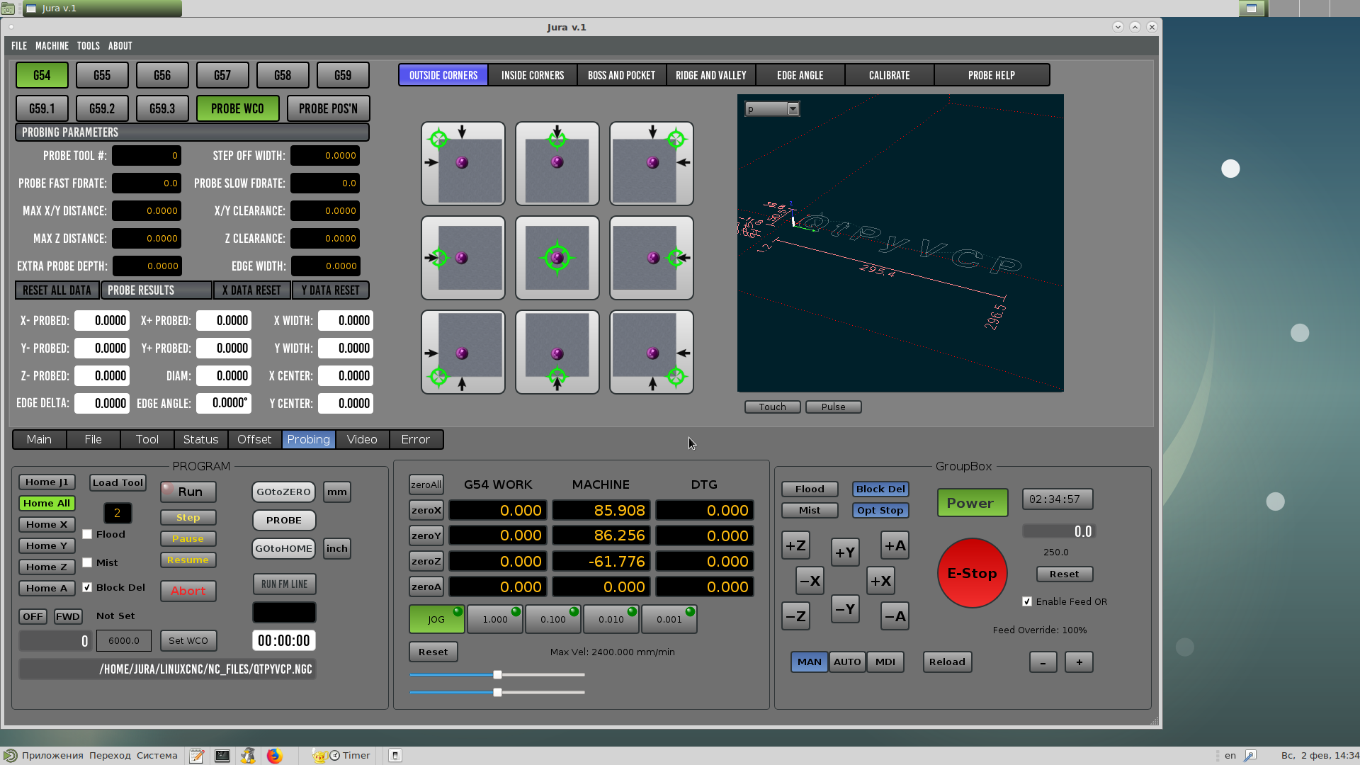

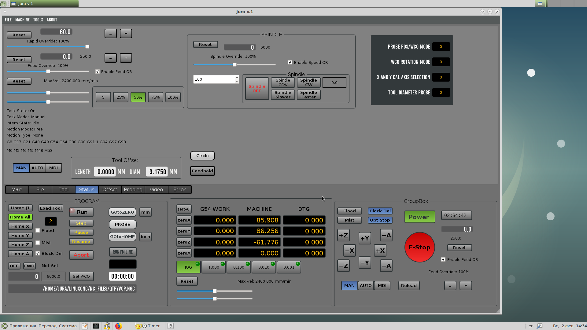

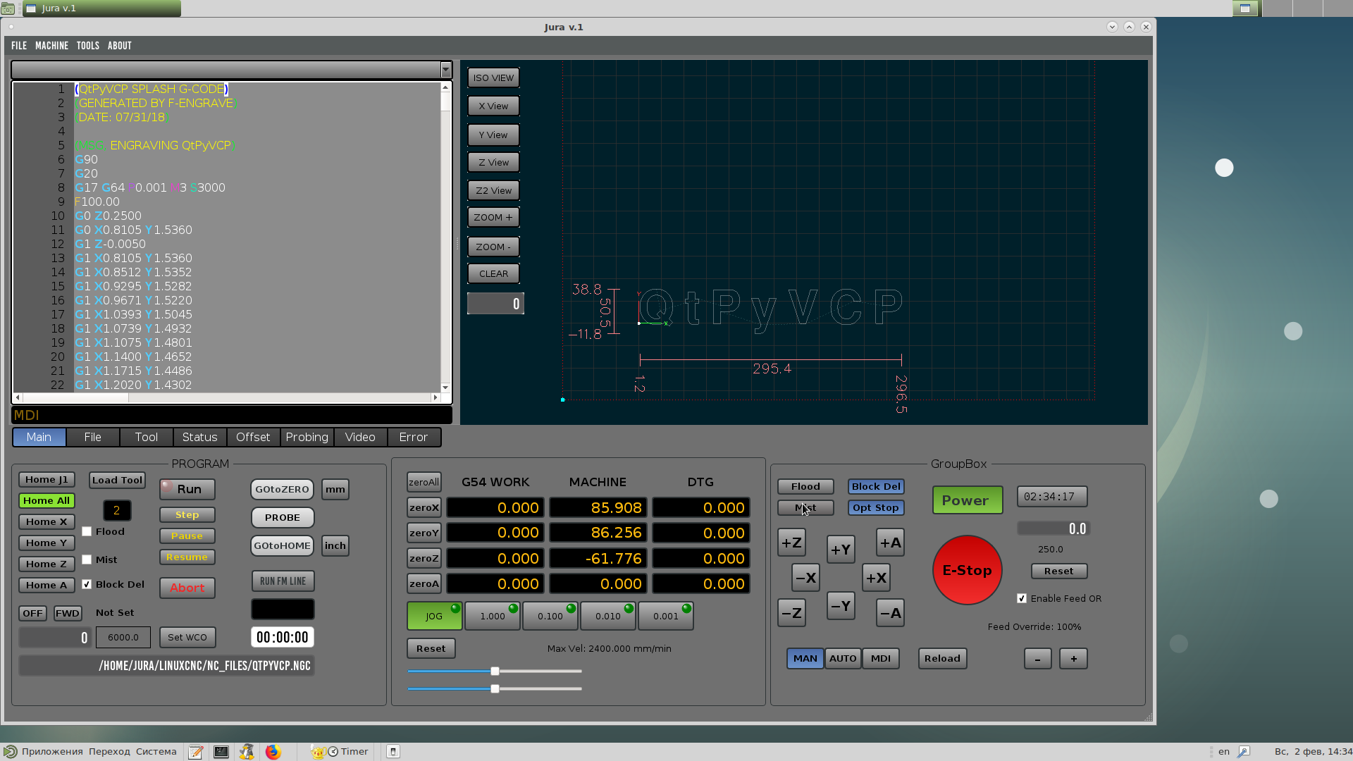

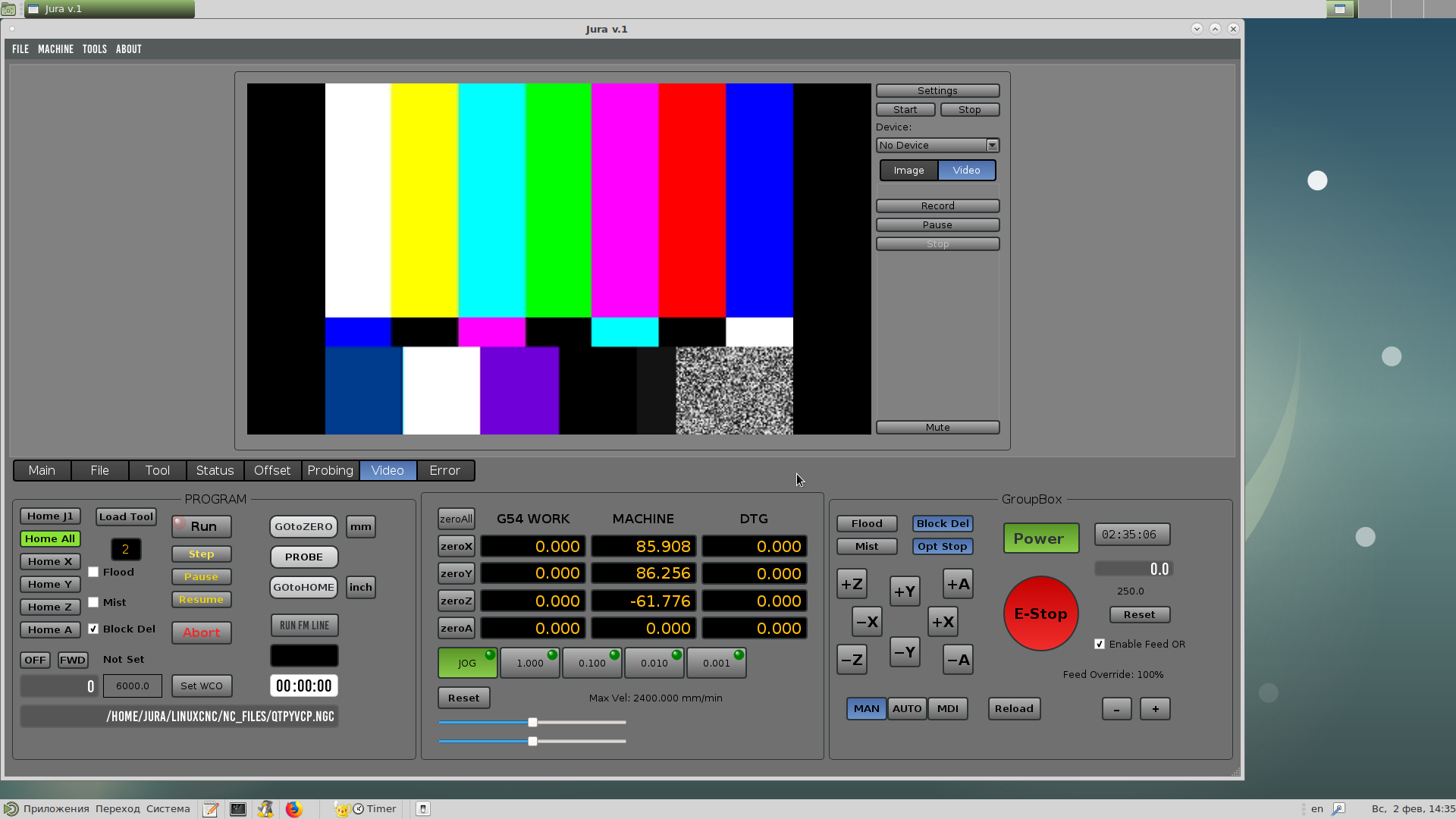

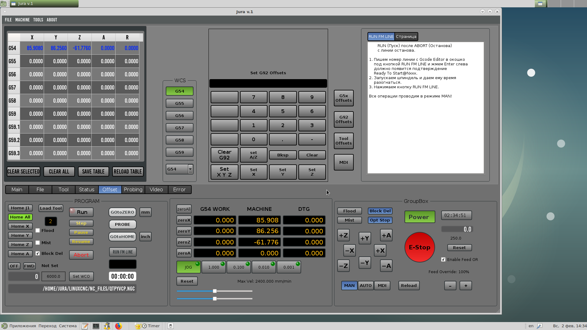

Hello! I have a 4 axis hobby machine 600x900x120 running MACH3. I wanted to go
on linuxcnc QtPyvcp. I purchased Mesa7i96 and, thanks to the hard work of specialists, made up such an interface for myself. Interface format 1600х1000. Thanks a lot, everyone.

02 Feb 2020 17:29 #156389
Replied by tommylight on topic Screen shots of gui designs
If you do not mind uploading that config here, i am sure someone will find it useful.
Thank you.
