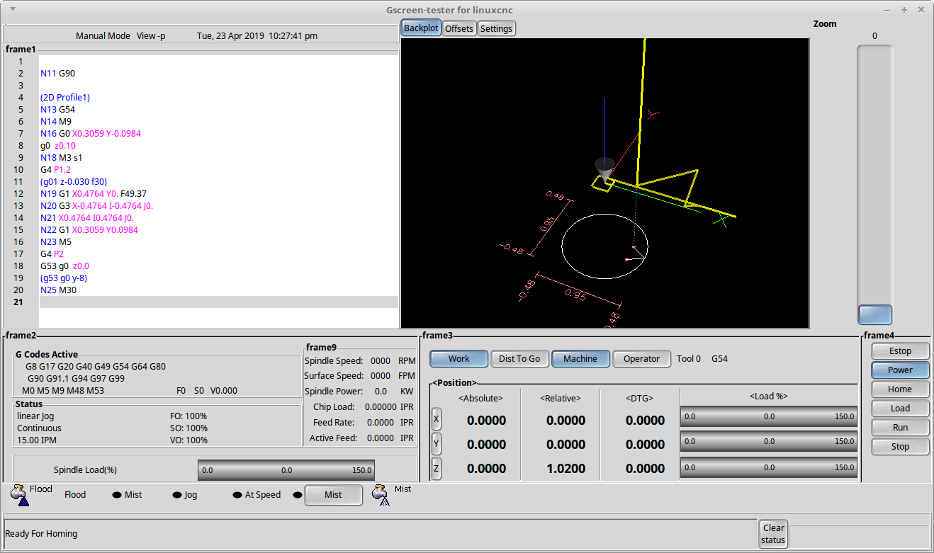

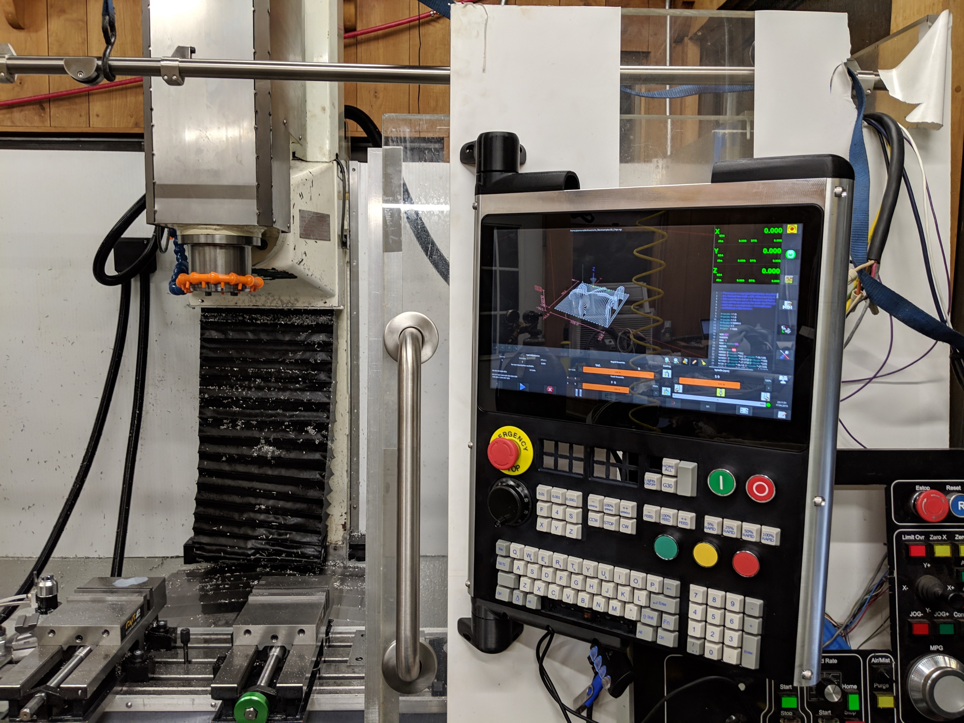

Hello Everyone,
I have been working on a custom Gscreen skin for my machine. It is simple and straight forwards and mimics the Haas GUI somewhat.
Even though I have a touchscreen, I wanted as few on screen buttons as possible. I am in process of building a console that will eventually be available to purchase, but right now it is just a project I am working on. Here it is running Gmoccapy with a dark theme.
My machine is a tool room bed mill that I have converted into a VMC. forum.linuxcnc.org/30-cnc-machines/33016...11-bed-mill-retrofit
Anyways, I am having a hard time understanding where the Gscreen skins get their data from. I have looked at the Industrial skin and the Gaxis skins and have borrowed from both, but im stuck trying to connect the other fields.
Things im trying to understand are how to get values for Feed rate, Spindle Speed and Velocity as individual labels instead of all the values in one label. Also, how would the override labels be changed from FO, SO and VO to read Feed:, Spindle: and Velocity:? The label in Glade seems to just set the location of the label and the values come from somewhere. This somewhere is what Im trying to find.
If someone would point me in the direction I should be looking, I would greatly appreciate it.
-Adam

I am also in the process of building a gscreen ui so maybe I can help. The label widgets from the glade file are periodically updated in the python code. To browse this code, just copy it to a local folder ( sudo cp /bin/gscreen gscreen.py) and open it with a text editor like notepadqq or something. The specific labels you mentioned are in update_feed_speed_label(self). HTH

28 Apr 2019 15:10 #132179
Replied by cmorley on topic Custom Simple Gscreen Skin - Need help linking values
As persel8 said, the built in skins usually call functions that are builtin to gscreen's main body of code. for instance the call update_feed_speed_label(self) calls code in gscreen.py :
you could copy this code into your handler file, and modify it to suit.
I guess I should add more docs for Gscreen....
Chris M
def update_feed_speed_label(self):
data = self.data.velocity
if self.data.IPR_mode:
try:
data = data/abs(self.halcomp["spindle-readout-in"])
except:
data = 0
if self.data.dro_units == self.data._MM:
text = "%.2f"% (data)
else:
text = "%.3f"% (data)
self.widgets.active_feed_speed_label.set_label("F%s S%s V%s"% (self.data.active_feed_command,
self.data.active_spindle_command,text))I guess I should add more docs for Gscreen....

Really nice inteface module you have built there. Where is the keyboard from?
