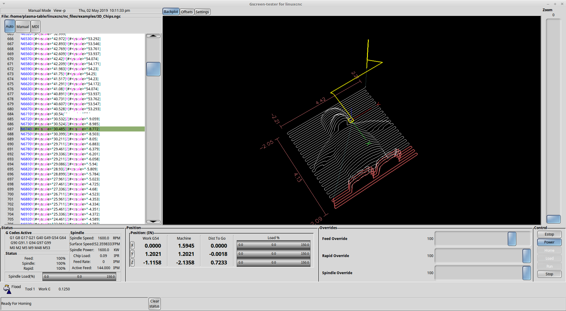

I am aware of QT but wanted to keep things simple and just move some stuff around. I have done the glade panels in axis and some other other stuff, but wanted to just put something together to do what I needed.
As persel8 said, the built in skins usually call functions that are builtin to gscreen's main body of code. for instance the call update_feed_speed_label(self) calls code in gscreen.py :

you could copy this code into your handler file, and modify it to suit.

Thank You. This appears to be what I was looking for. I will work on this tonight of re-creating this function in the handler file and see where I get.

Well I made great progress with the the advice given.
I need to do some more refining and a bunch of cleanup to the handler file but its almost done.
I was able to link up the values I needed to get spindle rpm, feedrate and current velocity, and current tool diameter from the tool table to calculate surface speed and chipload per rev. However, I think how im getting the data from the tooledit widget is causing an issue and not letting me edit tools in the table.
Also, im trying to understand what emcstat is. I cant seem to find much documentation of this but It seems this is part of linuxcnc and not gscreen...
Im still having trouble getting some labels to justify how I want, Like the Status section showing the overrides percentage. Im trying to get the labels right justified while the value label is left justified so all the :'s align but no luck yet. I think im getting a handle on the expand and fill packing options now which is a bit confusion.
Currently the override sliders are temporary filling the extra space.

Thanks for getting back on this. I have it all sorted out and working. I make direct calls to the gscreen functions where possible and use my own callback return methods. Once I figured out how gscreen works, it became much easier to customize stuff. I must say that is quite an ingenious bit of code you wrote. I now have a fully functional and fully customized gui for my diy router built from gscreen.
