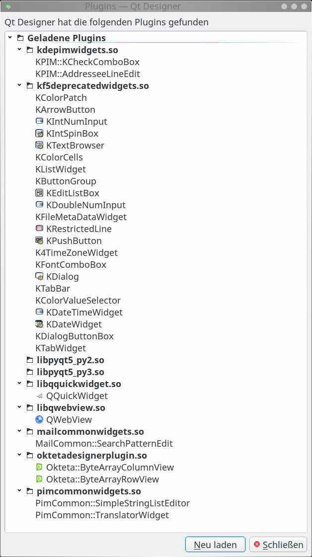

26 May 2019 04:54 #134962 by cmorley
Replied by cmorley on topic need help on setup of qtvcp
when you start designer now clck 'helpt' select 'about plugins' and see if it found the library libpyqt5_py2.so
26 May 2019 05:01 #134963 by Reinhard
Replied by Reinhard on topic need help on setup of qtvcp
Well, the lib is mentioned but has no entries
26 May 2019 05:12 #134964 by cmorley
Well as long as it sees the _py2 version then that is good - it finds the library.
The other question is which version of libpyqt5_py2.so did you copy over?
5.7 hopefully
