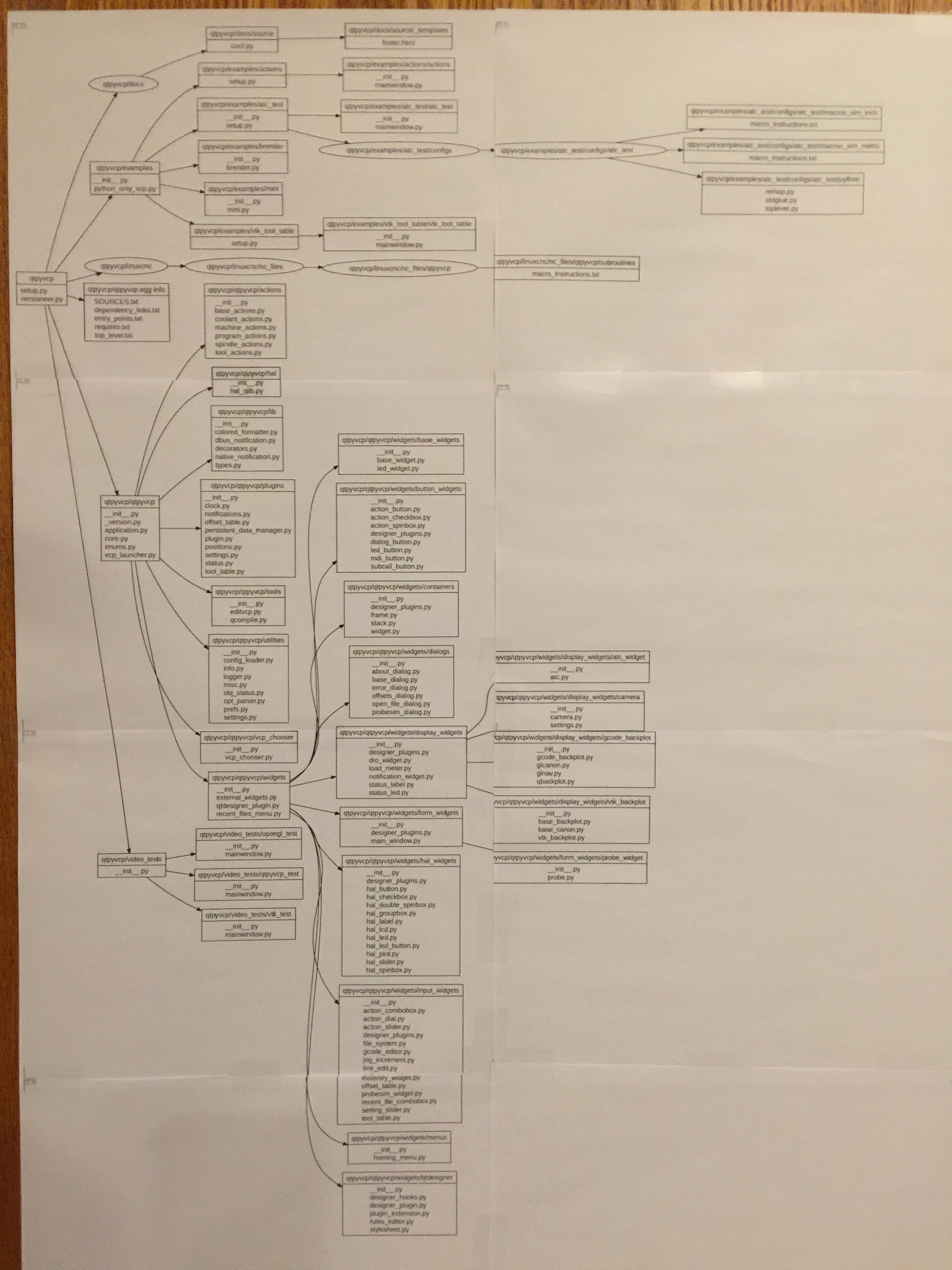

04 Jan 2022 05:18 #230718 by auto-mation-assist
Replied by auto-mation-assist on topic Labview UI project for Linuxcnc
I have been thinking about how to proceed on the Labview UI project. The largest issue that I see is that LinuxCnc does not have a process that consolidates all system status information in a tagged and thus use full format that can directly output all status data for use with any user interface whether local or remote. It is possible to interface to shared memory via status request but this returns raw data with no tags to tell what is what since only internal processes know what memory locations contain specific data and what format it is in.  Also decoding raw data without knowing where to find specific data and format it is in provides a significant problem to overcome.
When looking at all the various sources that provides status within LinuxCnc it can be seen that there are many that are generated by things that have been added over the years that are really external to  LinuxCnc proper since they are not available in status shared memory. The processes that generate these use an assortment of programming languages which makes this issue more difficult to overcome.
So why does this problem exist?  I believe that there is not a a single developer who is not aware of this issue but to fix it requires a lot of effort and planning possibly to the point of a major rewrite.  A programmer once told me that to many fixes and work a rounds make things harder to fix.  I see the lack of a very fast and consolidated status system within LinuxCnc as a very significant problem for future development work..
I would love to get any information on things related to consolidating status info something that is universally accessible and very fast. Does any one have a complete list of all processes that generate specific  status information and how many of these are not consolidated into the LinuxCnc status memory ?

10 Jan 2022 20:51 - 10 Jan 2022 20:52 #231344 by auto-mation-assist
I'm bouncing around between various projects and getting the LinuxCnc Interface that I would like to see is just one of those. I believe that I can develop it myself to suit myself but the hope was and that LinuxCnc developers would be interested such and interface for the increase in flexibility it could provide. But there appears to be a lot of resistance but then I have also not seen any comments to date that adding a universal interface is would not desirable.
As a point I would like to mention that networking as you likely know can take place inside a computer and does not have to leave it and is typically used to make interfacing a lot easier. I have read the latest posts and aware of all the options available or suggested by my own research in the past over the years. This included keeping silent and just doing my own thing without sharing. But that would be not being involved. Being involved includes making desires and suggestions known.
The most significant issue that I see is that I would like a interface as I have mentioned many times in the past that is not available right now but has the potential of being extremely beneficial. I sure such a interface will be incorporated in some way or other at some point in time.
To work on my project further.
One of the things that will help is to make a diagram of how the important parts of LinuxCnc links things together in a very detailed way. In the past I when I was working of qtpyvcp I made a chart of its hierarchy.  It is likely somewhat out of date but below is a copy of the file.
I think to aid in my work that I will need to breakdown LinuxCnc into its major blocks  and generate maps to get a better understanding of how data is routed between various building blocks. Surely there must be something like that available and I'm wondering if anyone has already generated such maps and willing to share. I have not been been able to find any that provide really good details yet.

11 Jan 2022 03:39 #231386 by cmorley
Replied by cmorley on topic Labview UI project for Linuxcnc
Developers in linuxcnc work mostly in two way, as far as I can tell.
Fixing things so linuxcnc still works ie python2 to python3 / required disto changes
Whatever interests them or is needed by them.
There is very little 'planned' work. There is no official plan or even a mission statement.
We have really a very little amount of active (with commit access) devs - something like 5 I'd say.
The only guide we have is the docs (look under developer information):
It will be out of date but still relevant.
There are some good google videos made by machinekit that explain things in better detail.
If you did make a code map that would be a very useful thing for the project!
