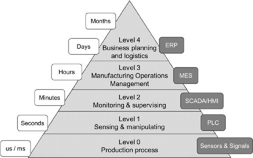

05 Sep 2020 10:49 - 05 Sep 2020 10:50 #180799 by Mud
Replied by Mud on topic Labview UI project for Linuxcnc
Why shouldn't I be able to see status updates as it runs? Why can't I monitor a job running for a few hours from the comfort of my office while I'm doing other things? Why can't there be a 65" monitor int her factory showing the current state of production?
So are you guys in agreement that real time operation is not required for monitoring purposes?
As I see it, user interaction is per se not real time so is the GUI. Or am I missing something here?
Are you talking about something like Octoprint for LinuxCNC? That is something I could see to be useful.
I guess you guys may already be familiar with ISA-95 - this version of the pyramid has rough timing requirements.
(Not my picture, nicked from here ).
I'd be lying if I said I'm following the whole conversation, but it's interesting because there are lots of people selling I4.0 under the guise of connectivity, lots of managers who believe it's important (but don't necessarily know why they want it), some definite benefits to the connectivity...but really a lot of the froth is really I3.0! Not trying to paint Rod as a straw man here by the way...I just get a bit less interested at a factory level! ;)
Last edit: 05 Sep 2020 10:50 by Mud.
