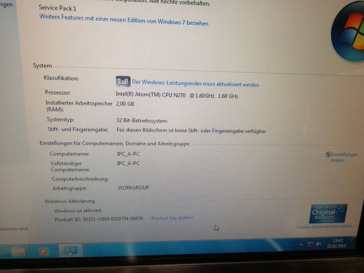

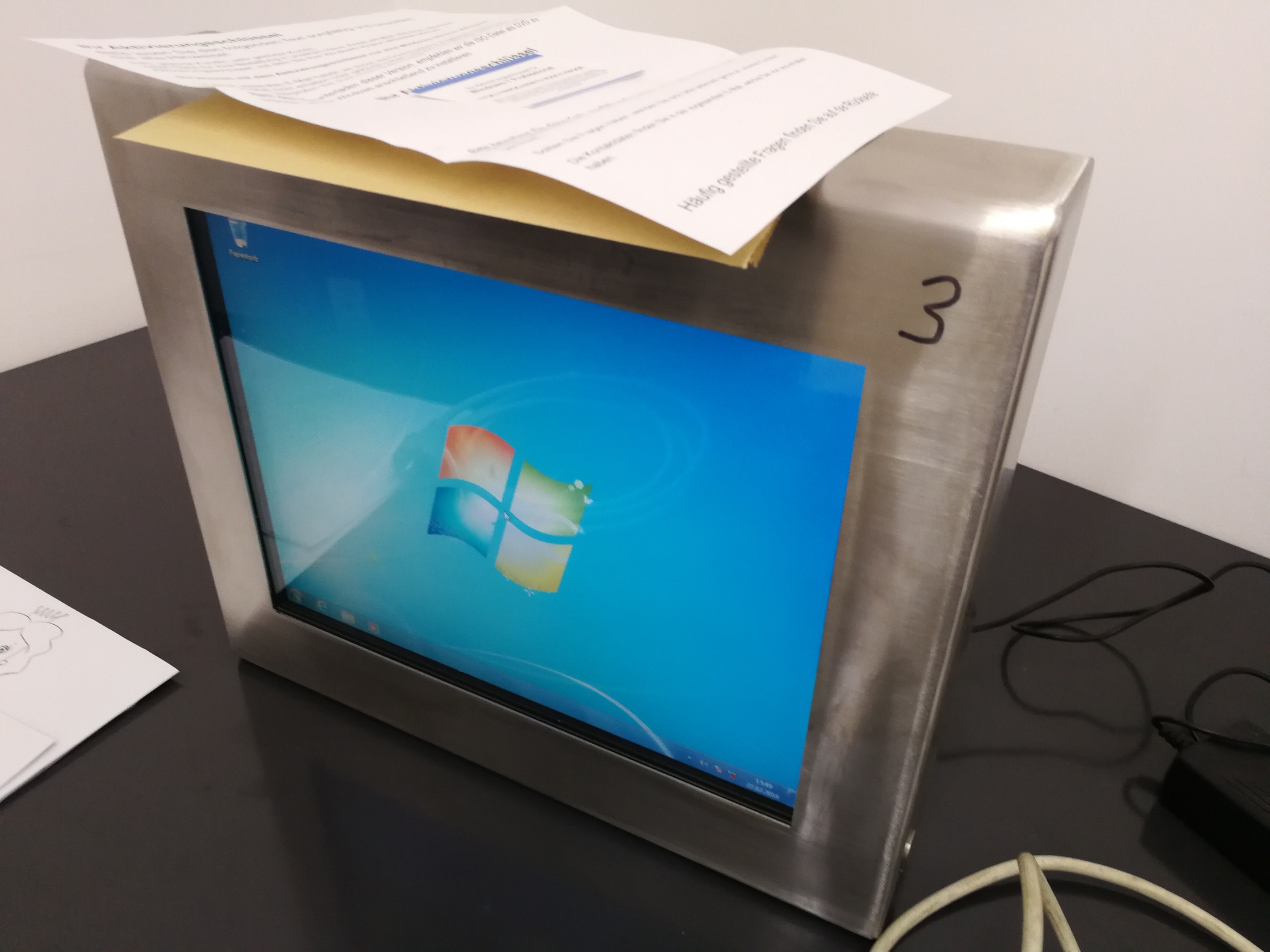

Replied by poolizei on topic Strategie bei Hurco BMC20 refit
I have an Industrial boxed Panel PC available (2 of them) the are not very high powered but completly waterproof and in a stainless steel case without touchscreen.
Do you think this Intel Atom N270 @ 1.6GHz could be fast enough, it only has 2GB Ram but this could be upgraded.
Thanks for your kind support!
Andreas

- Posts: 19899
01 Mar 2018 13:06 #106798
Should be fine. Try running the latency test to make sure.
LinuxCNC doesn't need much CPU power. It ran perfectly well 15 years ago on the computers available then, and hasn't got any more complex in the core areas.
Replied by andypugh on topic Strategie bei Hurco BMC20 refit

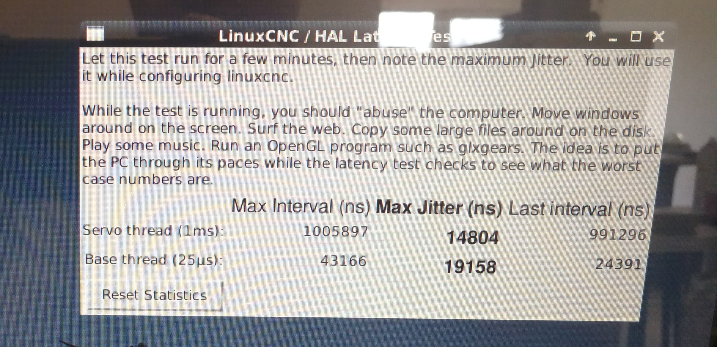

01 Apr 2018 14:13 #108212
by poolizei
So today I took some time and performed the Latency Test and tried some random Stuff while the test was performed (moving files, connecting ethernet, opening and playing youtube videos, moving windows) the outcome seems quite promising to me what do you think?
Please keep in mind I plan to use this hardware with Ethernet based Mesa Stuff and Or Ethercat based Servo-Drives
I have 3 of these units available got them nearly for free...
If they won't be suitable I would try to fit another small Mainboard into the case...
I appreciate your support!
and want to which all of you happy Easter.

01 Apr 2018 15:54 #108214
That looks pretty good. That would be fine for software stepping too.
