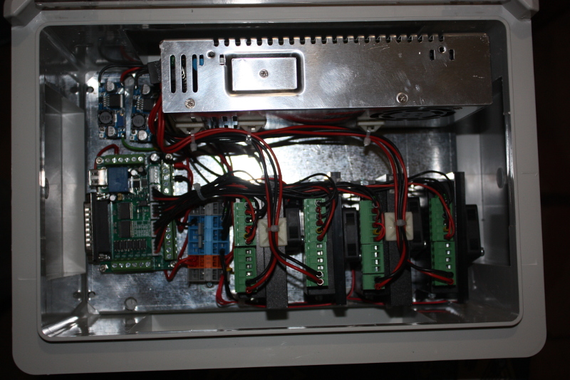

06 Oct 2019 16:18 - 06 Oct 2019 16:46 #147255
by Louis Cypher
Replied by Louis Cypher on topic Mach3 5 Axis China BoB: 5 V Versorgung
Last edit: 06 Oct 2019 16:46 by Louis Cypher. Reason: Added image

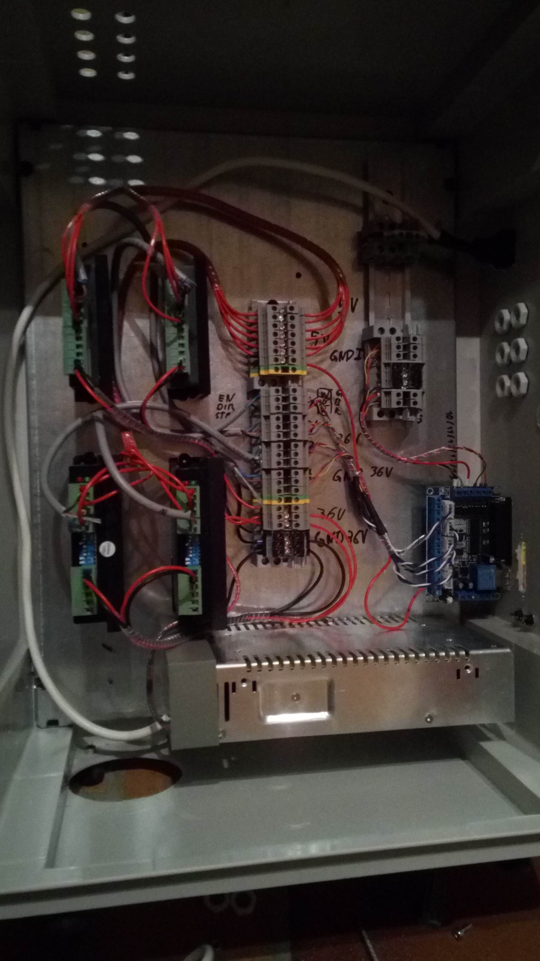

- Louis Cypher
- Posts: 45
06 Oct 2019 16:31 #147259
by Louis Cypher
Basically you are saying you have one circuit for the endstops running at a higher voltage and a board with optocouplers close to the bob to reduce EMV?
I measured the board/drivers and ground doesn't seem to be connected in the drivers. Same for endstop circuit vs digital IO part of the bob
Another story is the reading of contacts. They are influenced by higher emv as longer distances are requested. I've only seen them realized by optocouplers. Therefore u need a second and better higher voltage.
The grounding is a bit of philosophy. As boards are often cheepo, both negative supplies are often connected so you have no choice anyhow. But that means you easily run a "ground loop" over external supply and printer/USB cable. So try to keep these cables near to each other's.
Any values you can give me for the capacitor? I was thinking about a 1k to 10k resistor to keep the current in the mA range.Myself if the hw allows I always connect negative to ground only via a resistor in parrallel with a capacitor. One time to avoid high current low frequency mass loops with higher frequency short gutted and on the other side gives that the possibility to measure on the resistor if something is not good in your cabling or electronic.
If you understand these things it is not to difficult to "re-engineer" a cheapo job without good documentation.
m5c Mike
- Louis Cypher
- Posts: 45
06 Oct 2019 16:35 - 06 Oct 2019 16:36 #147261
by Louis Cypher
Der Step Down Converter hat wahrscheinlich einen gemeinsamen Ground für Input und Output Seite. Damit baust Du einen Groundloop von der Hochstromseite der Treiber zur Digitalseite der Treiber. Ich habe mich mit einem Digitalelektroniker unterhalten und der hat mir das bestätigt und deutlich davon abgeraten. Deswegen arbeite ich lieber über einen extra Powersupply.warumm nutzt du denn nicht einen einfachen stepdown wandler
Last edit: 06 Oct 2019 16:36 by Louis Cypher. Reason: No need to have the picture in this post

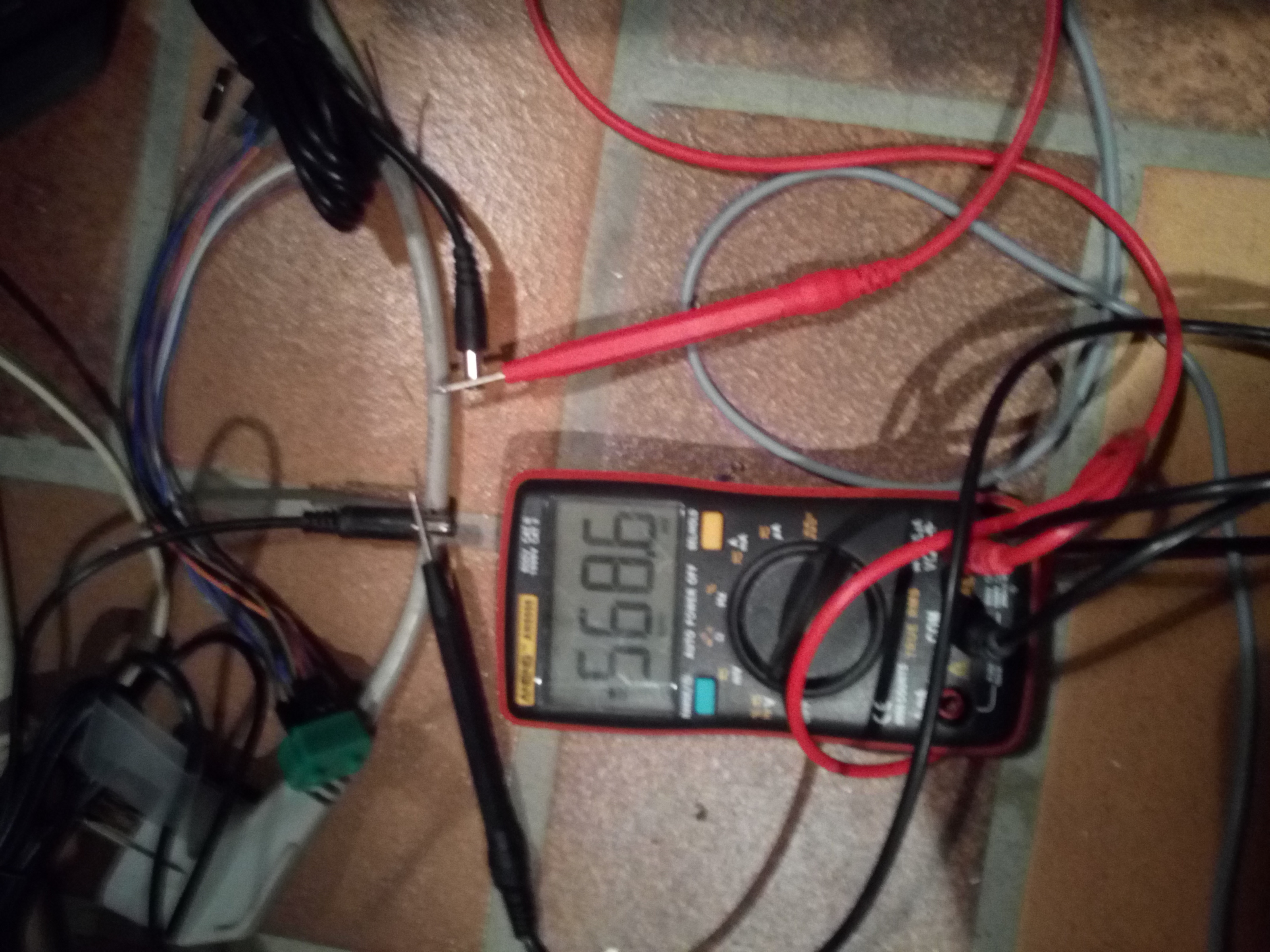

- Louis Cypher
- Posts: 45
06 Oct 2019 17:46 #147276
by Louis Cypher
Siehe meine Messung (der maximale Potenzialunterschied den ich gesehen habe war 6V! Und das bei einem 12V und einem 5V Netzteil)
Ich verstehe was Du meinst, den Satz könnte aber jemand missverstehen. Masse ist immer nur ein Bezugspunkt und eben nicht immer 0VBeispiel:
Masse ist Masse (0V). Und die sollte immer über alles gleich sein (verbunden).
