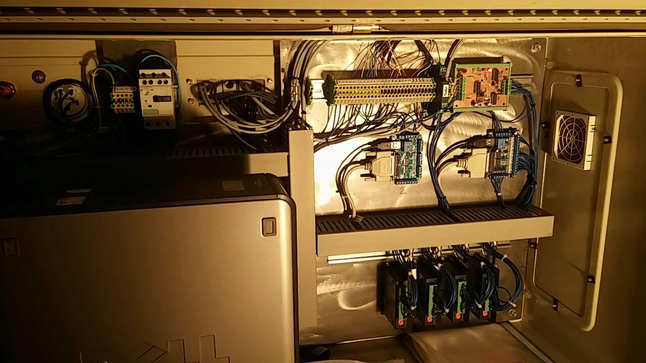

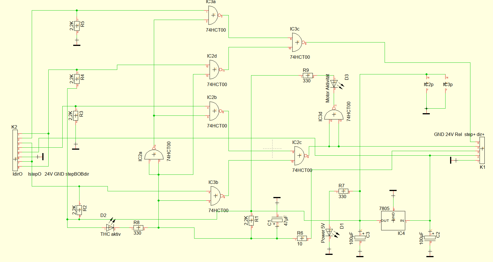

07 Dec 2019 02:43 - 07 Dec 2019 03:35 #152210
by spicer
Replied by spicer on topic THC Kontroller für Plasmaschneider selber bauen
Last edit: 07 Dec 2019 03:35 by spicer.
- spicer
- Posts: 422
- Thank you received: 126
07 Dec 2019 07:07 #152219
by spicer
Habe nun das vorhandene gebraucht und angewandt.
Siehe forum.linuxcnc.org/42-deutsch/37893-hat-...-mit-ttl-komponenten
