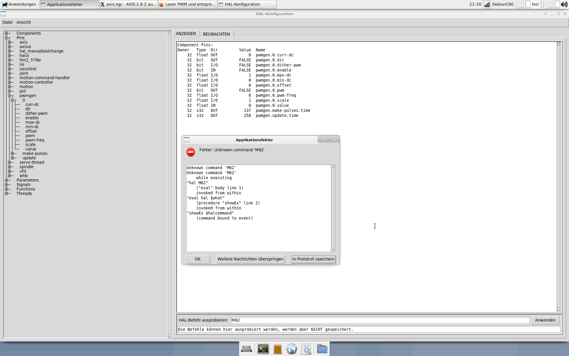

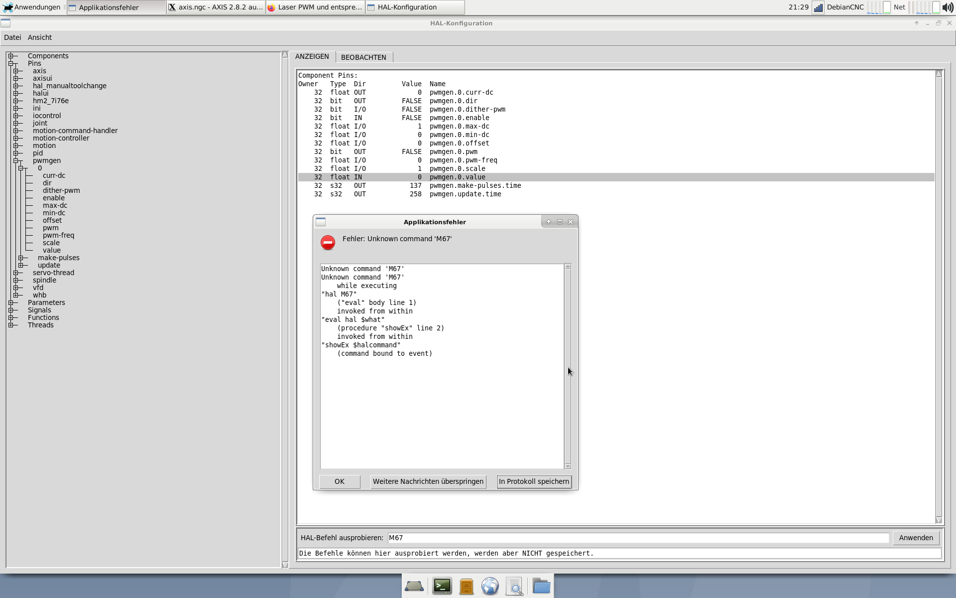

16 Feb 2022 20:23 - 16 Feb 2022 20:32 #235075
by tracer
Replied by tracer on topic Laser PWM und entsprechend.hal verändern
Hello PCW again,
If i start the Linuxcnc Program i get an error message
./CNC_Neu.hal:38: Signal name 'halui.program.is-running' must not be the same as a pin. Did you omit the signal name?
An if i do # this line and Linux cnc starts, i go to halt Configuration to show the pin pwmgen and tries to work with M67 ord M62 but get other error Messages, see Screenshot
Can you please help me with this?

16 Feb 2022 21:48 - 16 Feb 2022 21:58 #235084
Replied by PCW on topic Laser PWM und entsprechend.hal verändern
If you want the PWM enable to be controlled by a M62 etc command,
you would do something like:
net laser_pwm motion.analog-out-00 => hm2_7i76e.0.pwmgen.00.value
net laser_pwm_enable motion.digital-out-00 => hm2_7i76e.0.pwmgen.00.enable
And yes, the halui line is missing the signal name, but it was designed to
simply enable PWM when the program is running.
If you want to do this, this line would be appropriate:
net laser_pwm_enable halui.program.is-running => hm2_7i76e.0.pwmgen.00.enable
Note that this will fail if the pin: halui.program.is-running is already connected
to another signal
Also these statements should be removed:
loadrt pwmgen output_type=1
addf pwmgen.update servo-thread
addf pwmgen.make-pulses servo-thread
Since you are not using software PWM.
to another signal
Last edit: 16 Feb 2022 21:58 by PCW. Reason: copy-paste error

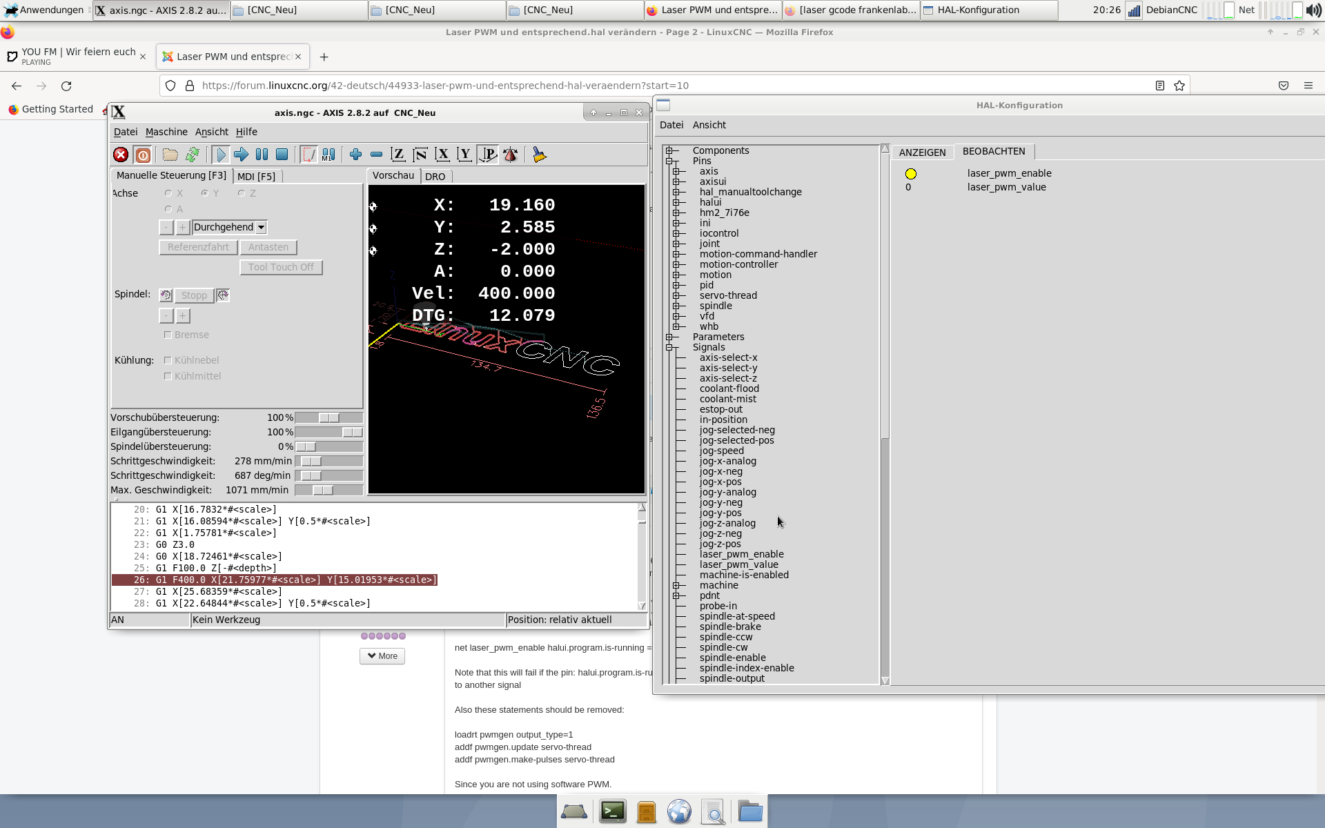

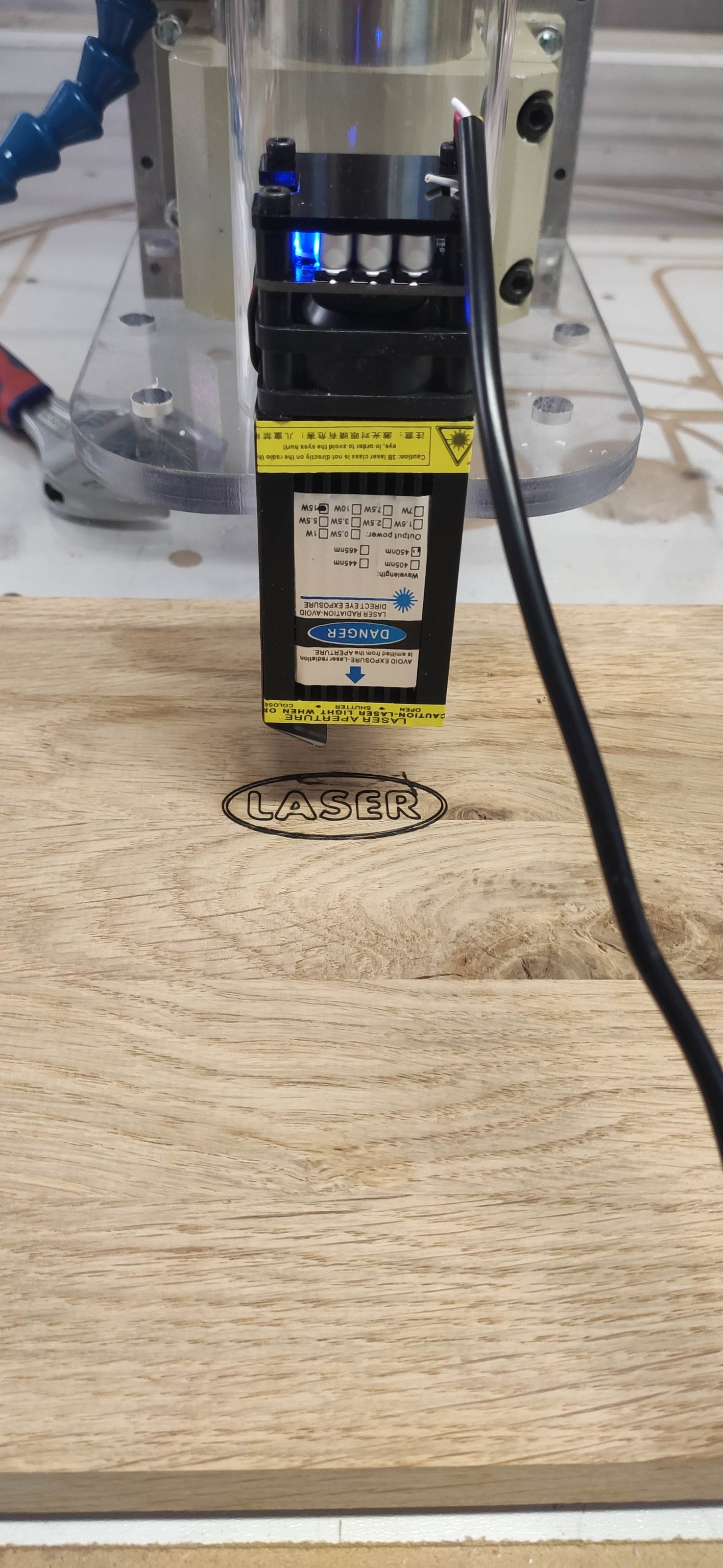

17 Feb 2022 17:17 - 17 Feb 2022 20:32 #235148
by tracer
Hello PCW,
step by step im coming forward.
in the Hal Config by running the programm the laser_pwn_enable is turning on.
MANY MANY THX to you!!!
I was running the GCode from FRankenlab and also the Laser_PWM_value is changing by the value in GCode Q150 or Q0,2
But i get no PWM Signal at the wirng to the laser.
I connected the Signal PWM wire to TB3 Pin3 and TB3 Pin 5 on the Mesa 7i76e
forum.linuxcnc.org/42-deutsch/44933-lase...aendern?start=0#none
What am i doing wrong?
EDIT
Found the Mistake. I havent hared the Ground from LAser Power Supply to MESA GND:
Now its working. Many Thx to you PCW!!!!!
EDIT
Last edit: 17 Feb 2022 20:32 by tracer.
