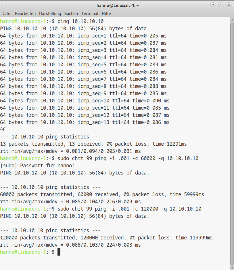

21 Feb 2025 15:11 #322209
Replied by tommylight on topic motor-0-position error beim Abbremsen aus 4-7,5 m/min
What does
ip a
in a terminal return?
The ping times look way to short (except the 10ms one) so you might be pinging your PC
Then again, i read above that it communicates with the Mesa board, so might be OK, just making sure.
ip a

21 Feb 2025 19:27 - 21 Feb 2025 19:35 #322220
by Muftijaja
Replied by Muftijaja on topic motor-0-position error beim Abbremsen aus 4-7,5 m/min
Hello PCW, tommylight,
Yes, I have switched to the optional Realtec Network Controller, because with the Intel i got triple as bad pings as with the Realtec when using it for the Mesa Card. (The Intel is very unstable indeed, Internet sometimes connects only with fixed IP, sometimes only with DHCP, that has cost me nerves the last weeks)
hanno@Linuxcnc-1:~$ lspci | grep -i ether
00:19.0 Ethernet controller: Intel Corporation 82579LM Gigabit Network Connection (Lewisville) (rev 04)
02:00.0 Ethernet controller: Realtek Semiconductor Co., Ltd. RTL8111/8168/8411 PCI Express Gigabit Ethernet Controller (rev 15)
I try to find the DKMS driver, if you say this could help.

tommylight: ip a gives back:

What does that mean in relation to my pings?
Thanks for your support!

21 Feb 2025 21:02 - 21 Feb 2025 21:02 #322228
by Muftijaja

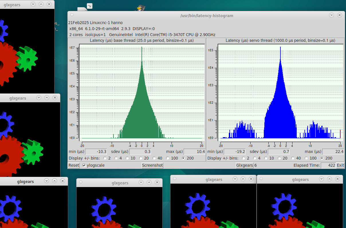

Well, I have installed the DKMS driver r8168 and repeated the ping test and histogram. Ping is a little slower but base thread in the histogram is way better than before!

hanno@Linuxcnc-1:~$ lsmod | grep r8168
r8168 581632 0
What do you think about it?
Kind regards and thank you for your support!
Hanno

21 Feb 2025 21:09 #322231
Intel might need coalescing set to 0, PCW knows how, i never needed it despite using all kinds of PC's, but there are plenty of members here who needed it and it works properly.
The following user(s) said Thank You: Muftijaja

21 Feb 2025 21:29 - 25 Feb 2025 13:32 #322234
by Muftijaja
tommylight, thank you for this tip! Yes indeed, I had the line sudo ethtool -C eno1 rx-usecs 0 on my Desktop to put it in the terminal each time after the PC starts. That helped a lot for the ping as I used the Intel NIC. So I gave Chatgpt the job to make a one-click file out of it, successfully. I can post it here asap, if I go down to my Linuxcnc PC tomorrow (Germany time)THe Realtec NIC is configured by start with coalescence=0, afaik.
PS: Below the file with double click function. delete the .txt and make it executable as a program. (ethool was the name Chatgpt gave it )

21 Feb 2025 22:20 #322238
Replied by PCW on topic motor-0-position error beim Abbremsen aus 4-7,5 m/min
Looks fixed to me.
Wish the LinuxCNC X86 image had the RealTek DKMS driver pre-installed
