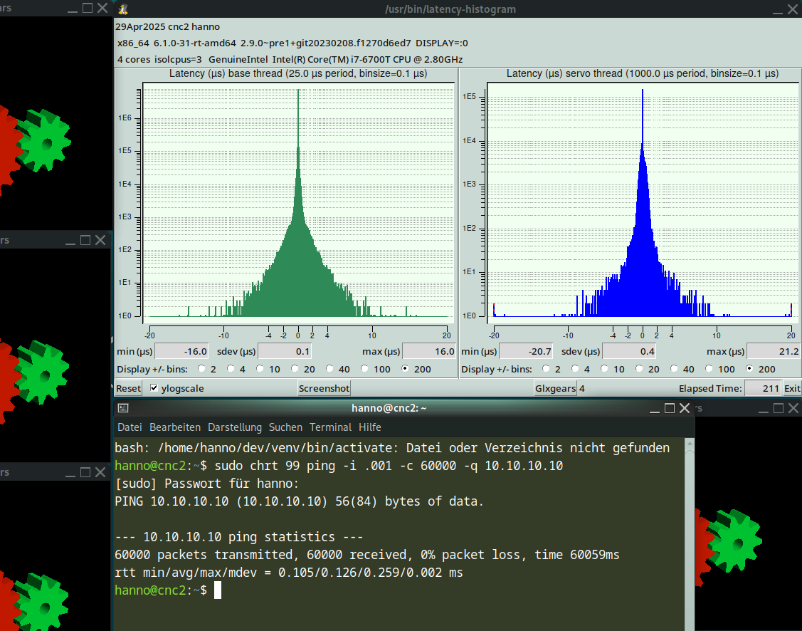

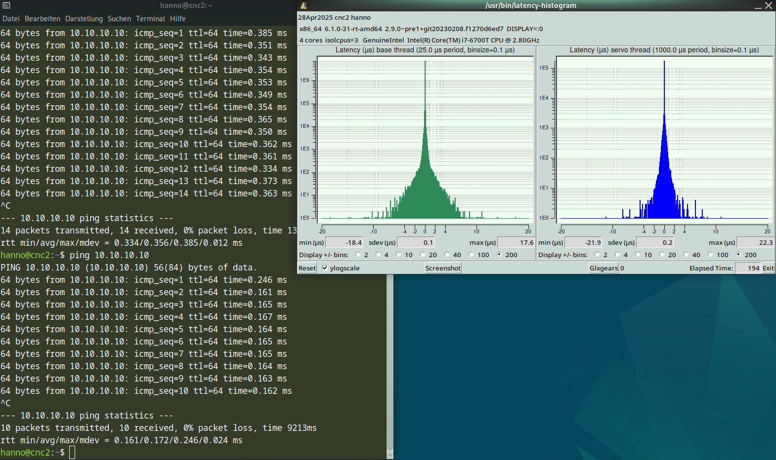

29 Apr 2025 10:40 - 29 Apr 2025 10:42 #327282
by Muftijaja
Replied by Muftijaja on topic motor-0-position error beim Abbremsen aus 4-7,5 m/min
Hi, I tried a lot the last days.
I set the P to 500 as you said, I made the realtec optional kernel settings, i took a look for Energy efficiency and did not find anything of this, I set ff2 back to 0, and in the first try (an air run of my last part) it seemed to run - but 2 min after start the motor-0-position error came again, right in a direction change of the path. As before.
That was very disappointing, so I decided to get another PC from the shelf, a Lenovo m910q with 16GB, i7-6700T 4C/8T and put the SSD from the other in it.
The machine started at once, no problems to fix, I declined all BIOS settings that are described in the latency thread. This jounger PC has WLAN for the Internet and a I219-LM Intel network card, that should be better, somebody told me.
I did the coalescence workaround in etc/interfaces, I made the ethtool working (sudo ethtool -C enp0s31f6 rx-usecs 0), I made the kernel options: quiet irqaffinity=0,1 isolcpus=3 intel_idle.max_cstate=1 i915.enable_rc6=0
The outcome was not bad, but worse than before, regarding the ping times. The realtec gave me 0,056-0,070, the intel gives out:
rtt min/avg/max/mdev = 0.165/0.189/0.307/0.052 ms which is bad in my eyes.
Even if i kill the WLAN adapter, it does not much better:
111 packets transmitted, 111 received, 0% packet loss, time 112114ms
rtt min/avg/max/mdev = 0.108/0.164/0.199/0.011 ms
What do you think about it? should I go down to the machine and try it out or should I do sthing else?
Thanks for your advice, I appreciate that much!
Hanno
Hanno
Last edit: 29 Apr 2025 10:42 by Muftijaja.
- Muftijaja
- Posts: 102
- Thank you received: 4
29 Apr 2025 11:02 - 29 Apr 2025 12:11 #327283
by Muftijaja
This is my last effort to get the ping down. I set the Cool Option to thermally optimized, a cool&quiet option in BIOS. Other settings would bee acoustic optimized or full throttle. I hope it does not affect anything of cpu clocks.
rtt min/avg/max/mdev = 0.105/0.126/0.259/0.002 ms what do you think?
Greetings, Hanno
Greetings, Hanno
Last edit: 29 Apr 2025 12:11 by Muftijaja.
- Posts: 18063
- Thank you received: 5308
29 Apr 2025 15:06 #327297
Replied by PCW on topic motor-0-position error beim Abbremsen aus 4-7,5 m/min
The ping times are not terribly important _unless_ packets are dropped due to timeouts.
Default timeout setting is 80% of the servo period so those times look fine for a 1 KHz
servo thread.
servo thread.
The following user(s) said Thank You: Muftijaja
