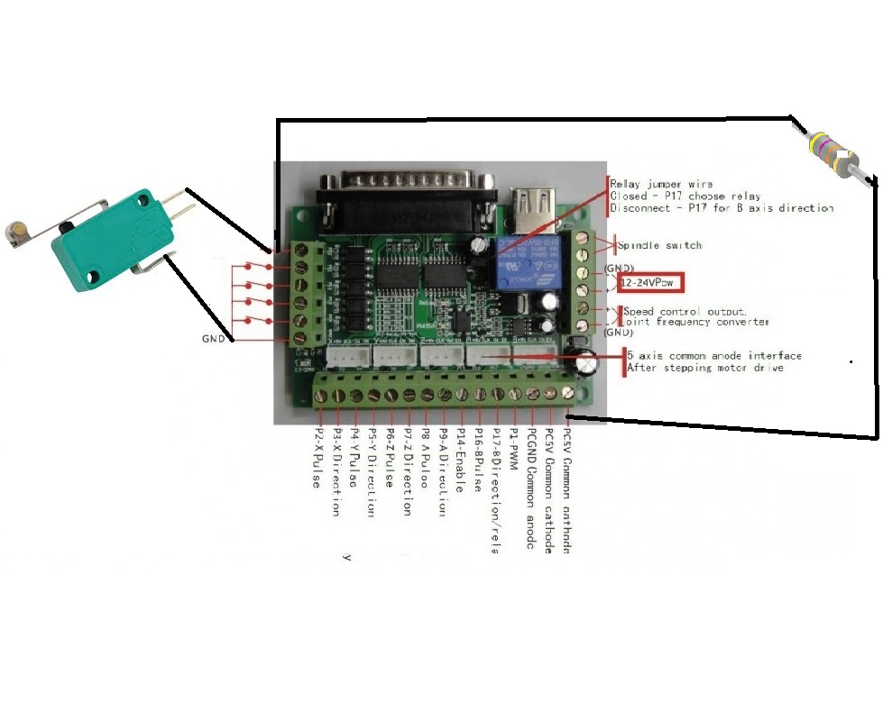

09 Jan 2017 18:54 #85536
by beauxnez
Replied by beauxnez on topic linuxcnc pour plasma
- Todd Zuercher
- Posts: 4764
- Thank you received: 1464
09 Jan 2017 19:06 #85539
Replied by Todd Zuercher on topic linuxcnc pour plasma
That should not be nessisary. The board should have it's own internal pull-ups.
- Posts: 21762
- Thank you received: 7436
09 Jan 2017 19:09 #85540
Replied by tommylight on topic linuxcnc pour plasma
No resistor, it is on the bob.

25 Feb 2017 11:46 #88615
by beauxnez
bonjour
en modifiant le fichier thc.hal j ai reussi a faire fonctionner le bouton estop
j ai tous mes voyant eteint:)
quand j appui sur le fin de course connecter sur le pin 15 le voyant ne s allume pas
quand j essaye de faire avancer le moteur il ne bouge pas ?
voici mon fichier modifier selon ma bob

27 Feb 2017 17:33 #88685
Do not change the file names, or if you do change them, change the appropriate entries in the ini file.
And you have the limit switch ( in this case the probe switch ) wired to pin 13 in hal, not pin 15.
For that BOB you might need to add the enable to pin 14 and edit the thc.hal for torch on from pin 09 to pin 17.
When you power on the drives, do the motors lock can you move them by hand?
