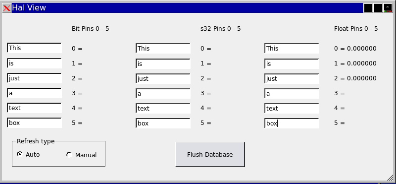

13 May 2013 02:24 #33967 by mariusl
It works with the symlink. I would like to get the stuff to compile later but for now it does well.
What am I supposed to see in the textboxes on the form?
Regards
Marius
www.bluearccnc.com
13 May 2013 15:03 #33978 by ArcEye
See the halview_README file in the zip
Basically, whatever signals you have linked the pins to, the values of the out pins attached to those signals will be displayed.
I wrote it when I was testing a toolchanger component and trying to get particular homing behaviour at start up. This meant having to stop and re-start lcnc over and over again and I was getting sick of opening up a window to watch pins every single time I did it.

13 May 2013 18:20 #33982 by mariusl
That is exactly why I am excited about this tool. I hate the constant restart while you are testing new stuff.
I get the values displayed like this "1 = 125.0000" in the label field but the text box us empty. I does not really bother me, I just wanted to know what the intended contents were. As long as I can see the values somewhere.

13 May 2013 18:31 #33986 by mariusl
OK I read the info in the zip file. The net name should be displayed but mine is blank. Is there a special way to write the net name?
Regards
Marius
www.bluearccnc.com
13 May 2013 21:08 #33993 by ArcEye
I think you mean the text box next to the field display.
It is just a text box, click on it and you can type whatever you like in there, as a reminder of what you are looking at.
It does not fill itself in.
I am guilty of the usual programmers error, being so familiar with the program that it all seems obvious so I don't explain it properly :S
regards
13 May 2013 23:50 #34014 by mariusl
OK, that is usefull enough as it is. I have to make notes these days otherwise I dont remember what went where. :huh:
Regards
Marius
www.bluearccnc.com
