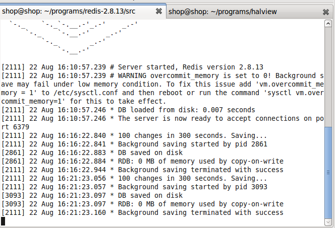

Replied by mariusl on topic HalView - view HAL pin values externally in C++
Hi Mick
I installed the halview utility on two machines now. both running on linuxcnc 2.6.latest.
The redisclient refused to compile so I used the supplied file. On both systems I get all thing loading but it seems like nothing is talking to one another. Here are some screen shots of the terminal running the server as well as the lcnc halshow etc.

- ArcEye
- Posts: 22
- Thank you received: 240
22 Aug 2014 22:04 #50187
by ArcEye
Replied by ArcEye on topic HalView - view HAL pin values externally in C++
Hi
I would suspect it is a problem with redis, probably changed something between versions.
I didn't have to start it in a terminal, after the make and make install, it started a daemon at boot.
I probably scripted it, can't remember, was a long time ago.
Unfortunately I don't have anything installed that is still running on Ubuntu 10.04 to test with.
I have been into my NAS that has the last remaining backup of 10.04 in it
redis was version 2.4.6, your version 2.8.13 has hugely changed even just going by the release notes and may not be compatable.
If you want to install Debian Wheezy, I could probably make a binary deb given time, but I suspect you have enough complications
Best I can offer at present is to zip up the redis 2.4.6 sources and put them somewhere for you to download and try those
regards
regards
I will try the older files for now as I am not ready to go the Wheezy just yet. I have a machine in the office that I must put Wheezy on but until then, the stuff in the shop has to be 10.04
PM me so I can send you a link to my dropbox.
Hi
I have now re-written the program to port it for Qt5 and have it running on Debian Wheezy
I used the redis-2.4.6 sources, so I suspect the later sources must have been the problem you had.
I will make a binary deb package at some point, that installs the lot, redis-server, hiredis libs, redisclient component, pulls in Qt5 libs and provides a sample config folder to test it on.
Will have to repeat the process on a binary.hybrid.iso install to get that right, I am using a 64 bit rt-prempt kernel and MachineKit at present
regards
regards
