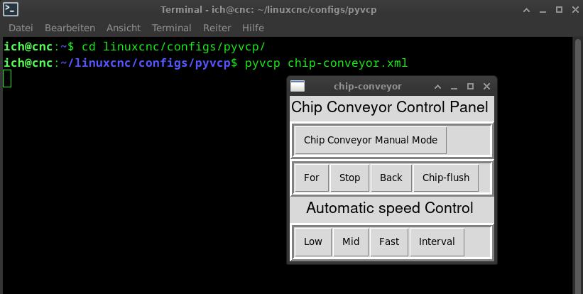

24 Feb 2024 10:45 - 24 Feb 2024 10:47 #294186 by chris@cnc
I would not so much to do with M-code. Just simple on/off. Control over custom panel is more useful.
Standard selection could be:
Chip Conveyor start/stop with input pin in middle speed.(Maybe program run or M-Code)
Any other function select over panel.
I wrote a simple interval function for my mist collector. This function could break the out pin and we have interval. Attach example...
And for speed. 3 simple out pins to select speed input on VFD. I guess analog control is a little overkill. 3 speed mode should be okay in case of VFD using.
Last edit: 24 Feb 2024 10:47 by chris@cnc.
25 Feb 2024 17:35 #294413 by chris@cnc
I think we should use the most common mcide for this conveyor on off cycle and mcodes are fin, i can just expose the hall pins for thise settings easily enough.
If you're brain is working better than mine right now, let work out the flow chart.
On another note, I'm working on a big integrated hal. component where all of my lathe specific comps will go. I was thining Lint.comp lathe integration component.
I am not so good at making flow charts, but i could set up a simple on/off cycle. If you want, you can take a look. The comp is working.
in0 starts the fwd pin. And if in7 high will be fwd pin cut by interval cycle time. Timer length could be set with hal setp.
in1 is manual fwd
in2 is stopp
in3 is manual back
chip flush is set if conveyor run.
The speed could also set up direct to VFD pins.
What do you think?
