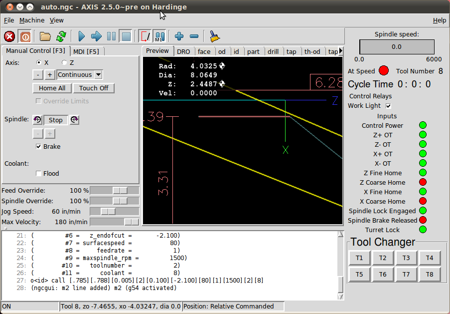

On my Hardinge CHNC I have an 8 station tool turret. I was always fumbling around to spin the turret to put a tool in or change an insert when it hit me I needed some buttons on my pyvcp panel to do that for me. The advantage is on click tool changes and I don't have to leave the manual screen.
The XML to create the buttons

The Post GUI hal file entries
# MDI Commands

The ini file entries (if you don't have the HALUI section just add it)

The Screen Shot of the buttons.
