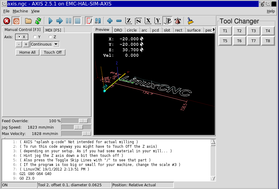

I did check that thats why i posted the question in the forum
My ini has more but i copiued only this 3 sections
[DISPLAY]
DISPLAY = axis
EDITOR = gedit
POSITION_OFFSET = RELATIVE
POSITION_FEEDBACK = ACTUAL
MAX_FEED_OVERRIDE = 1.2
INTRO_TIME = 5
PROGRAM_PREFIX = /home/tkamsker/linuxcnc/configs/Heiz400T-3WZW
INCREMENTS = 5mm 1mm .5mm .1mm .05mm .01mm .005mm
PYVCP = ToolChPanel.xml
[HAL]
HALUI = halui
HALFILE = Heiz400T-3WZW.hal
HALFILE = custom.hal
POSTGUI_HALFILE = custom_postgui.hal
[HALUI]
# HalUI-MDI-Befehle hier einfügen (max. 64)
# MDI commands
MDI_COMMAND = T1 M6 G43
MDI_COMMAND = T2 M6 G43
MDI_COMMAND = T3 M6 G43
MDI_COMMAND = T4 M6 G43
MDI_COMMAND = T5 M6 G43
MDI_COMMAND = T6 M6 G43
and The XML is an exact copy of that thread for the start
And the custom_postgui.hal is
# Benutzerdefinierte HAL-Anweisungen können nachfolgend angegeben werden
# Die Befehle in dieser Datei werden nach der AXIS GUI (und PyVCP-Panel) ausgeführt.
# MDI Commands
#net too1-1 halui.mdi-command-00 <= pyvcp.tool-1
#net too1-2 halui.mdi-command-01 <= pyvcp.tool-2
#net too1-3 halui.mdi-command-02 <= pyvcp.tool-3
#net too1-4 halui.mdi-command-03 <= pyvcp.tool-4
#net too1-5 halui.mdi-command-04 <= pyvcp.tool-5
#net too1-6 halui.mdi-command-05 <= pyvcp.tool-6
#net too1-7 halui.mdi-command-06 <= pyvcp.tool-7
#net too1-8 halui.mdi-command-07 <= pyvcp.tool-8
now commented out that i can work manually
So i see the 8 Buttons
My idea was that i do simply an Collet On and Collet off button which simply call M101 and M102
Then the T1 T6 buttons wich would Translate to Tx M6 <cr> o<ww> call <cr>
Where <cr> is carrige return
I wanted to stay verry simple
So the error
custom_postgui.hal:4: Unknown command 'net tool-1 halui.mdi-command-00 <= pyvcp.tool-1'
was not clear how to tackle it. Can i switch on debug or is it simply the wrong section for that command does it need to be set later or earlier ?
In my day profession i am a developer but i did so far spent no time in the code and i hope that this is not now necessary ;)-
So if someone already had similar issue or has an hint would be verry welcome ,..
Because when this is finnished (and i can dio the pcb i try ) then i might be able to finnish the arduino based pendant ,..
Where i have an working prototpye,..
thx
thomas

It's quite simple, I have copied all of Johns entry into sim files and the problem is that the <pyvcp> </pyvcp> tags are missing from the .xml file
Should be
<?xml version='1.0' encoding='UTF-8'?>
<pyvcp>
    <labelframe text="Tool Changer">
    <font>("Helvetica",16)</font>
    <hbox>
      <button>
      <halpin>"tool-1"</halpin>
      <text>"T1"</text>
      <bd>3</bd>
      </button>
      <button>
      <halpin>"tool-2"</halpin>
      <text>"T2"</text>
      <bd>3</bd>
      </button>
      <button>
      <halpin>"tool-3"</halpin>
      <text>"T3"</text>
      <bd>3</bd>
      </button>
      <button>
      <halpin>"tool-4"</halpin>
      <text>"T4"</text>
      <bd>3</bd>
      </button>
    </hbox>
    <hbox>
      <button>
      <halpin>"tool-5"</halpin>
      <text>"T5"</text>
      <bd>3</bd>
      </button>
      <button>
      <halpin>"tool-6"</halpin>
      <text>"T6"</text>
      <bd>3</bd>
      </button>
      <button>
      <halpin>"tool-7"</halpin>
      <text>"T7"</text>
      <bd>3</bd>
      </button>
      <button>
      <halpin>"tool-8"</halpin>
      <text>"T8"</text>
      <bd>3</bd>
      </button>
    </hbox>
    </labelframe>
</pyvcp>
This is the running proof
Another benefit of always running programs from the terminal, you get to see all the error messages.
regards

22 Oct 2012 12:45 #25601 by BigJohnT
Replied by BigJohnT on topic Re:Tool Changer
Did you put the MDI commands in the ini file in the correct place?
linuxcnc.org/docs/html/config/ini_config..._sub_halui_section_a
John
22 Oct 2012 13:02 #25603 by andypugh
Replied by andypugh on topic Re:Tool Changer
"unknown command" is a strange error message, as I would expect "pin not found" if it was a problem with the PyVCP or the MDI_COMMANDs.
You can check that the halui.mdi-command and pyvcp pins exist by using Machine->Show HAL Config to bring up the Halshow widget.
My suggestion is that they do.
I wonder if the problem is some sort of windows line-ending problem? Is the interpreter baffled by the "<LF>net" command?
22 Oct 2012 13:03 - 22 Oct 2012 13:05 #25604 by ArcEye
Replied by ArcEye on topic Re:Tool Changer
So the Tags are here
I do get the command unknown and that is not clear how to tackle that one
You will just have to zip your complete config folder and attach it.
The code works, as demonstrated, there must be something in the way it is implemented in your configs which is causing the error.
(or as I have just seen Andy say, your files are littered with CR / LF or other control chars if done on a word processor)
regards
Last edit: 22 Oct 2012 13:05 by ArcEye.
