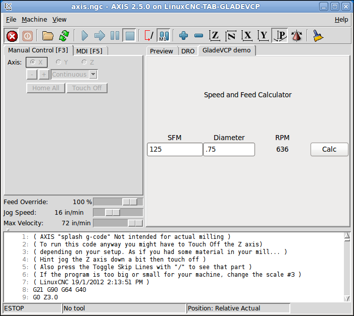

I started with a simple RPM calculator and ran into a small glitch with the entry box not showing the | to indicate that the box has focus... not a deal breaker but a bit strange to get used to. It might just be a bug I don't know.
Does anyone know what the debug line is for and if there are any options?
calc.py
The [DISPLAY] ini entry
John
calc.py

BigJohnT wrote:
There were some hoops to jump to get GladeVCP to interoperate properly with Axis wrt key handling and focus, because the Axis GUI toolkit (tkinter) is a bit historic and not particularly friendly towards embedded windows; see the note here: www.linuxcnc.org/docs/devel/html/gui/gla...key_handling_in_axis
I'm fairly sure this causes what you see - this wont be the case in a purely GladeVCP UI, like gscreen
re the debug variable - looks like c&p leftover; since it's not referenced in your code it can be deleted

Michael,
Thanks for the explanation. The debug was from the samples in 2.5 so you might want to delete it from the sample configs. One other thing I noticed was that the def get_handlers(halcomp,builder,useropts): had to be on the left margin or it would not work. The manual example shows it intended the same as the def above it.
John

ah! right you are - now I understand why Xavier had the same issue
fixed
