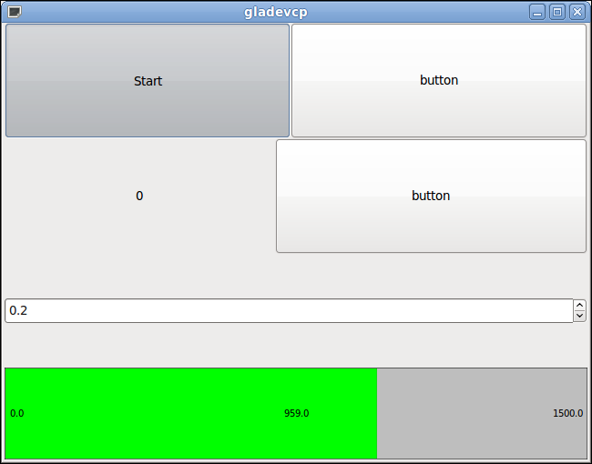

18 Aug 2012 15:56 - 18 Aug 2012 15:58 #23383 by BigJohnT
Replied by BigJohnT on topic Re:Run GladeVCP from halrun
wd5jwy,
Just for fun I created a component to work with the spooler that makes the stepper run to the max then reverse direction and run back to the min setting at the velocity set by the spin box. The green bar shows the current step count from the stepgen. So with this you don't need a mechanical reversing mechanism like a deep sea reel, just a guide on a screw...
File Attachment:
File Name: wd.zip
File Size:3 KB
John

18 Aug 2012 16:14 - 18 Aug 2012 16:15 #23384 by BigJohnT
This is an update to spooler.comp
component spooler;
pin in signed min_limit;
pin in signed max_limit;
pin in float vel_in;
pin in signed step_counts;
pin out float vel_out;
variable int direction;
function _;
license "GPLv2 or later";
FUNCTION(_)
  if(step_counts <= min_limit){direction = 0;}
  if(step_counts >= max_limit){direction = 1;}
  if(direction) {vel_out = -vel_in;}
  else {vel_out = vel_in;}
This will update the velocity all the time so if you change it the effect will be immediate.
Thanks to bpuk on the IRC for the update.
John
