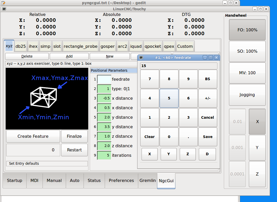

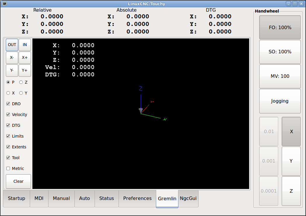

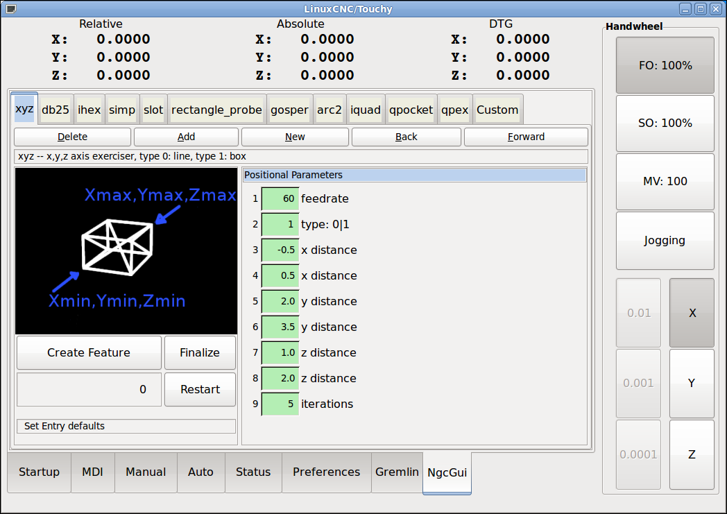

Axis is a combination that includes Tcl and it doesn't play nice with Gtk all the time. There seem to be some limitations when trying to combine the two.
You mention you want to make the panel mouse free, is this for a touch screen? Would you be interested in testing Touchy + Gremlin (backplot) + pyngcgui?
No, I just prefer to hit a few keys instead of clicking everything with a mouse. While milling it doesn't matter how well you try to evacuate the chips; part of it ends beside the machine anyway. While milling freehand using the NC-control as an advanced power feed even more so.
The (Logitech) washable keyboard stands up to that abuse nicely. The mouse doesn't like chips and is generally a slow method of doing things. Shortcut keys are much faster, and easier to do blindly.
Looks good!
But until I have a touchscreen (I will have one in the future) I think I prefer the regular axis interface with a panel next to it for some often used tasks.
