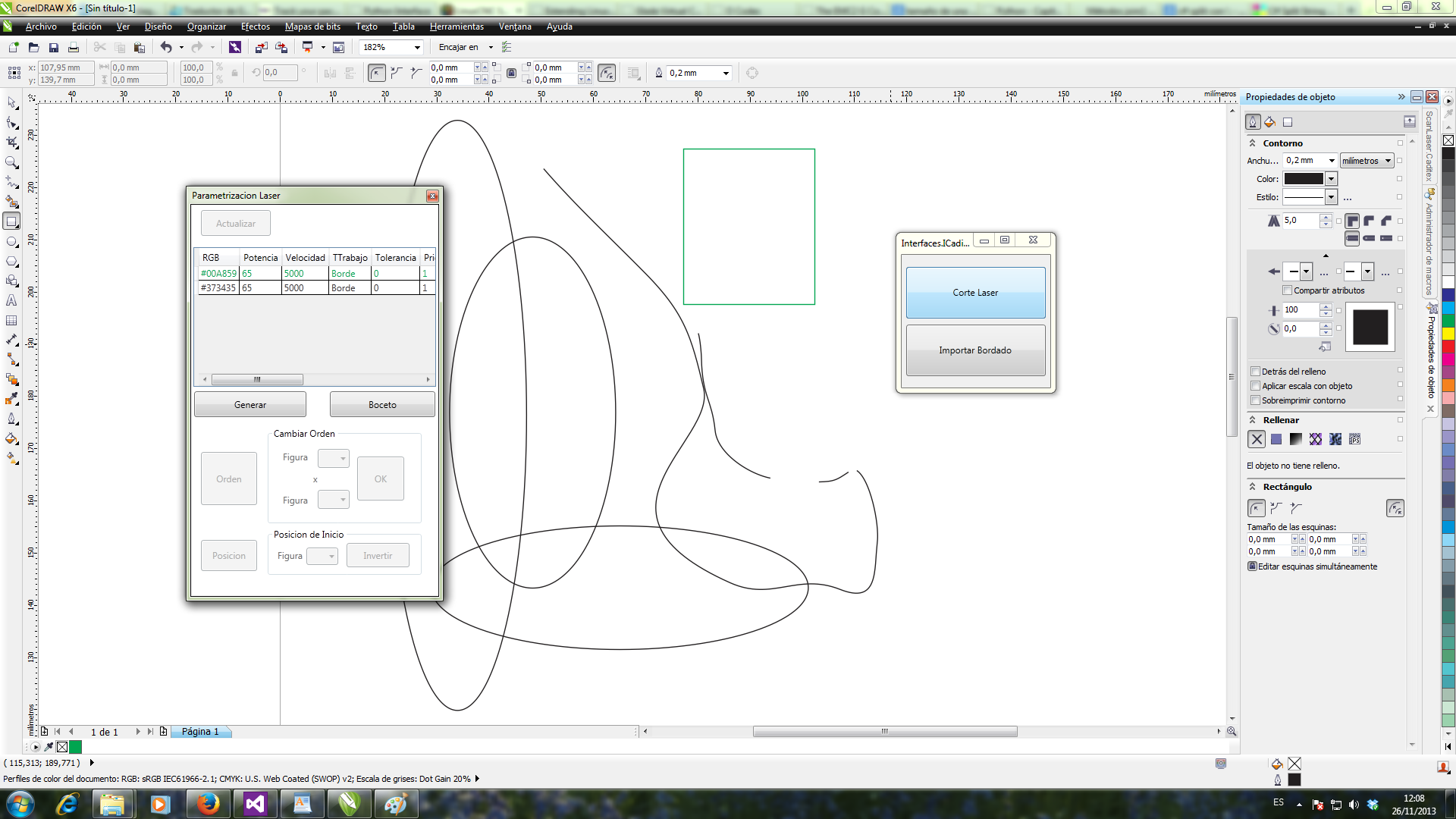

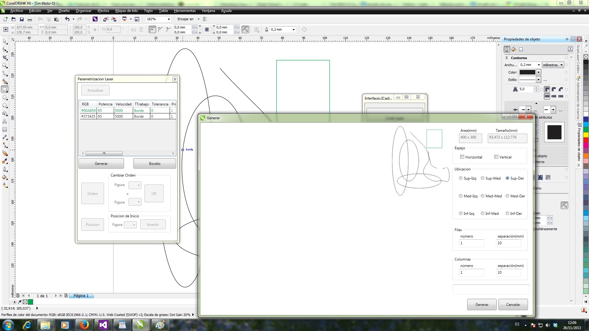

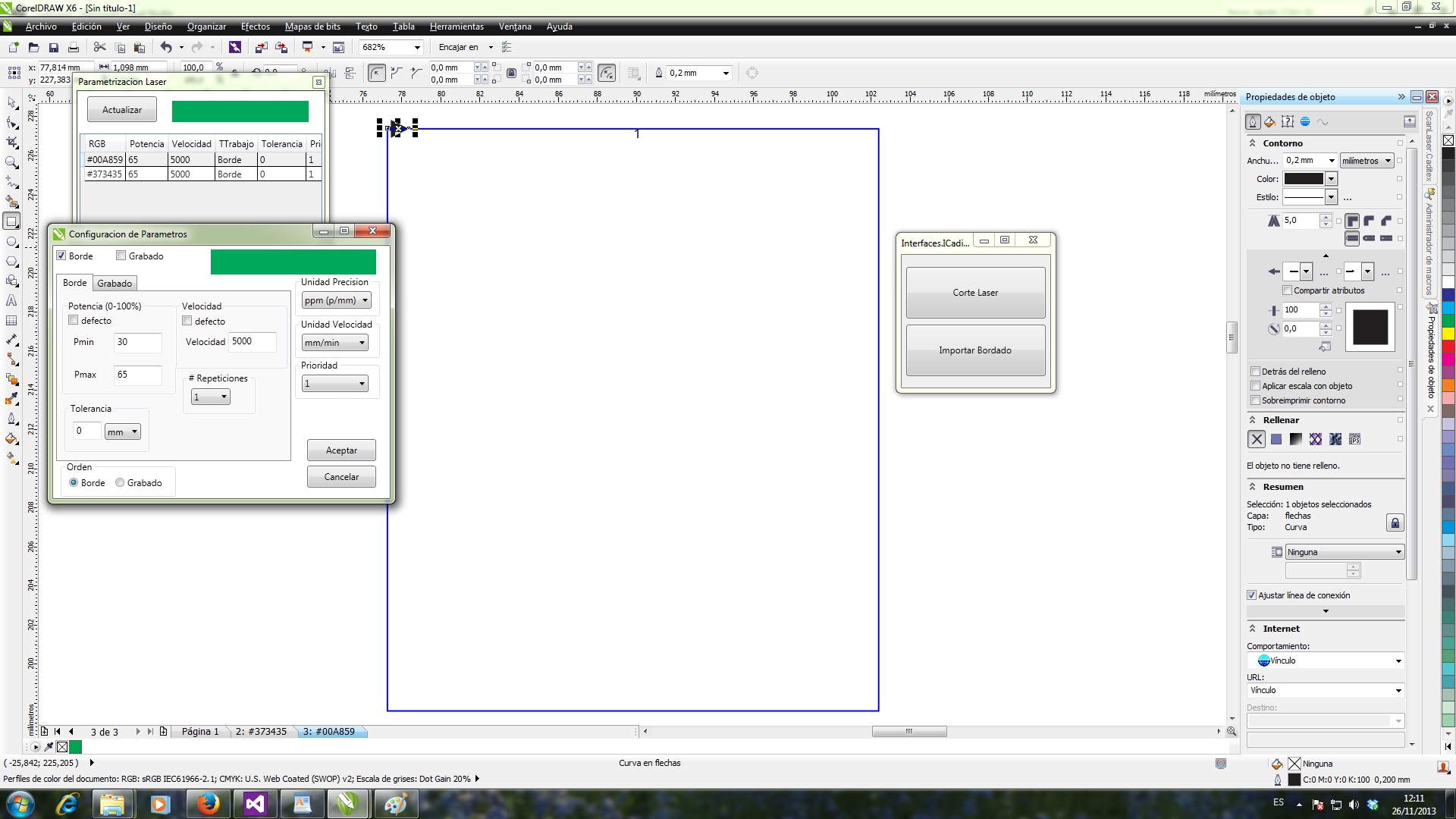

Really in not only GUI. I have develop a custom CAM for CorelDraw that build the .ngc file for a laser machine. Now I want add the functionality of press a button en my GUI and the machine move along the perimeter without activate the laser. This is to see if the figures draw inside the material without do measurement of material. I have included the o subrutine that will draw the perimeter inside my .ngc and want only call this subrutine when I press the button "Trace". Now I have tried the solution of Michael and this work fine. Only is a few "ugly" have two files and the one only with o subrutine
