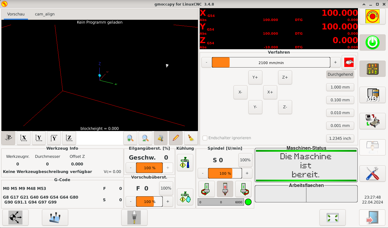

with the post above and the apps in the LinuxCNC 2.6 configuration tree i was able to do a pyvcp image_u32 replacement for gladevcp.
here is the result code of a short example how to:
To see a "live" example i made a tiny LinuxCNC config with the new gmoccapy screen, see attached file. Copy the file to your config folder and start it with LinuxCNC.
Thanks Guys
You Rock The World

return [HandlerClass(halcomp,builder,useropts)]To see a "live" example i made a tiny LinuxCNC config with the new gmoccapy screen, see attached file. Copy the file to your config folder and start it with LinuxCNC.
Thanks Guys
You Rock The World

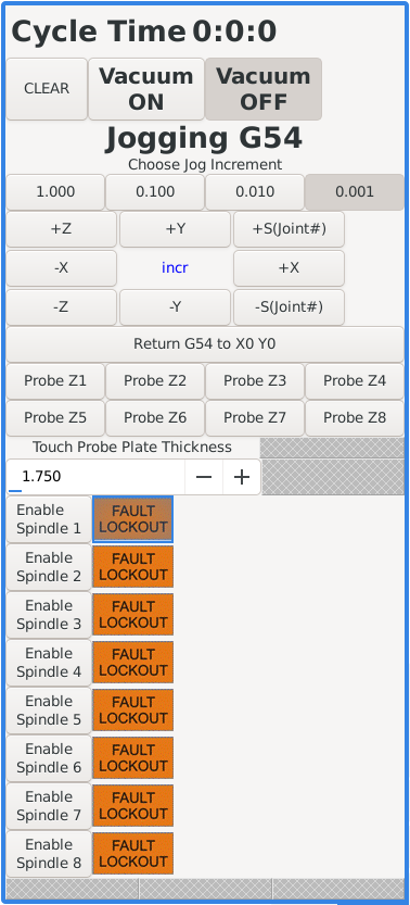

I'm really struggling with the python side of this. So far everything I've tried fails and I haven't been able to usefully decipher the output at the command line to understand where I'm going wrong. I'd like to have all of the image files stored in a sub directory in the machine config directory and I need to use the same list of possible images for multiple displays in the VCP. Here is the beginning of what I'd like the gladevcp to look like.
The 8 orange "Fault Locout" images, are the ones that I need to change depending on the state of each VFDs status.
The list of all of the image names is 0-fault-lockout.gif, 1-fault.gif, 2-start-pending.gif, 3-stop.gif, 4-dc-brake.gif, 5-run-at-0hz.gif, 6-run.gif, 7-accel.gif, 8-decel.gif, 9-current-limit.gif, 10-decel-override.gif, and 11-lower-transistors-switchin-on.gif
