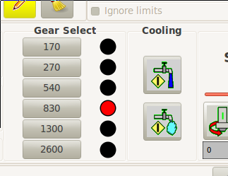

Replied by mariusl on topic objects not loaded or recognized
Some screen shots and code

31 Aug 2014 17:23 #50548
by newbynobi
As default value is "0", it will load that value.
This message is normal if the file gearselect.var is not in the correct place or does not exist. Taht only happen on the first run. If you close the GUI the file should be written.
Delete the geraselect.var file,
start gmoccapy_marius
push button 1300
close gmoccapy
Take a look in gearselect.var, it should now have SelectedGear = 5
If you now restart gmoccapy_marius, the hal pin should have value 5
Check for the rights in the directory, may be the file is owned by "norbert"?
Please report, as you challenge me
Norbert

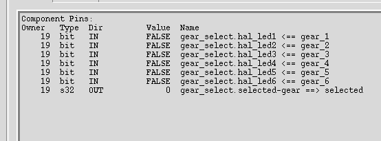

- mariusl
01 Sep 2014 01:59 #50556
by mariusl
Regards
Marius
www.bluearccnc.com
When I look at the pin with halshow directly after startup it is 0 instead of the reported value. This is what I am crying about. My comp is not even connected at this time. I am just using halshow. If you look at my picture in previous post you will see the halshow showing 0 when the python script reports the pin to be some other number.
This is just for directly after startup. The value is not passed to the pin. After any handler is called to change the pin, it actually does change. The problem is at startup only.
The file is correct but the pin is not set when the constructor was called and then assigned a value.

- mariusl
01 Sep 2014 18:49 #50565
by mariusl
Regards
Marius
www.bluearccnc.com
Now matter how I tried, I could not get the pin to be initiated at startrup so I did a work around.
I made another hal pin that is connected to the machine on signal. So now when the machine is switched the handler will be called and effect the pin.
connected like this
sg = hal_glib.GPin(self.halcomp.newpin("selected-gear",hal.HAL_S32, hal.HAL_IO))
self.halcomp["selected-gear"] = self.SelectedGear
print("Hal pin stored value was %s" % self.SelectedGear)
print("Hal pin has been set to %s" % self.halcomp["selected-gear"])
kickstart = hal_glib.GPin(self.halcomp.newpin("kick-start", hal.HAL_BIT, hal.HAL_IN))
kickstart.connect("value_changed", self._do_kickstart)
def _do_kickstart(self, kickstart):

- mariusl
06 Sep 2014 15:33 #50838
by mariusl
Regards
Marius
www.bluearccnc.com
Hi Norbert
I moved my lathe config to 2.6 and now it does not effect the screen widgets again at startup. Not even with my kick start trick. Please have alook at some of the strange errors that I get when I run linuxcnc.
Things like connection error???
LINUXCNC - 2.6.2
Machine configuration directory is '/home/shop/linuxcnc/configs/lathe'
Machine configuration file is 'lathe.ini'
Starting LinuxCNC...
Connection error: Connection refused
/usr/bin/gmoccapy:147: GtkWarning: gtk_widget_grab_default: assertion `gtk_widget_get_can_default (widget)' failed
self.builder.add_from_file(XMLNAME)
**** GMOCCAPY GETINIINFO ****
Preference file path: /home/shop/linuxcnc/configs/lathe/lathe.pref
/usr/bin/gmoccapy:220: GtkWarning: Invalid icon size 48
self.widgets.window1.show()
**** GMOCCAPY INFO ****
**** gmoccapy screen 2 found ****
toolfile: /home/shop/linuxcnc/configs/lathe/tool.tbl
**** audio available! ****
Waiting for component 'gladevcp' to become ready......WARNING:Config:Can't load Default loading default layout instead
........adding import dir .
......module 'gearselect' imported OK
module 'gearselect' : 'get_handlers' function found
Hal pin stored value was 3
Hal pin has been set to 3
Registering handlers in module gearselect object <gearselect.GearSelect instance at 0xa73c1ac>
Register callback 'on_frame_main_destroy' in <gearselect.GearSelect instance at 0xa73c1ac>
.....Xlib.protocol.request.QueryExtension
../usr/bin/gladevcp:185: GtkWarning: GtkSpinButton: setting an adjustment with non-zero page size is deprecated
builder.add_from_file(xmlname)
./usr/bin/gladevcp:185: GtkWarning: gtk_radio_button_set_group: assertion `!g_slist_find (group, radio_button)' failed
pyngcgui:INTFC:linuxcnc running=1
pyngcgui:INTFC:ini_file=</home/shop/linuxcnc/configs/lathe/lathe.ini>
.activating GTK bug workaround for gtkrc files
Set from kickstart - Hal pin stored value was 3
Set from kickstart - Hal pin has been set to 3
...........Xlib.protocol.request.QueryExtension
**** no valid probe config in INI File ****
**** disabled tool measurement ****
******************************* Gcode.lang found
(gmoccapy:1996): GtkSourceView-CRITICAL **: gtk_source_language_manager_set_search_path: assertion `lm->priv->ids == NULL' failed
**** GMOCCAPY INFO : inifile = /home/shop/linuxcnc/configs/lathe/lathe.ini ****:
**** GMOCCAPY INFO : postgui halfile = postgui_call_list.hal ****:
/usr/lib/python2.6/dist-packages/Onboard/KeyGtk.py:43: PangoWarning: pango_font_description_set_size: assertion `size >= 0' failed
font_description.set_size(self.font_size)
