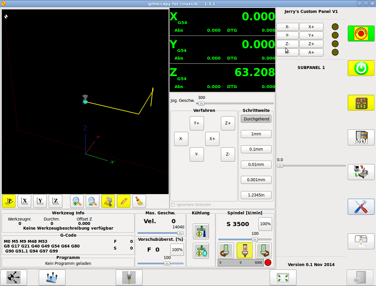

@BigJohnT
Thanks for the syntax... the file is not causing errors... but it's not doing anything either. The panel comes up, but the buttons are still non-functional.
The custom_postgui.hal file looks like this now.
Once we get the buttons functional... I need to find the names reference...
I understand gladevcp.btn_x_minus as I programmed it in Glade, but I need to find where the other names jog-x-minus and halui.jog.0.minus come from... so I can look up the JOG reference for getting the slider connected... and for the LED indicators.
For example... I know that the LED to detect the X-Home is called led_x_home and that it must connect with halui.?????? just need to find the references.
For now... what am I missing to activate the buttons?
...and I REALLY do appreciate the help!!!
Jerry

18 Nov 2014 05:21 - 18 Nov 2014 05:25 #53178
by newbynobi
Replied by newbynobi on topic Getting Started - Setup / Download / Configuring
Jerry,
as far as I see from here in Germany, you placed all the button in a hal_table and that one is not active, so the buttons in there aren't active eather. (I can not see whitch kind of hal_table you used)
You may take a look at the documentation for details.
Are they looking as in your first screenshot (light grey)?
Is the machine out of emergency, switched on and all axis homed?
Or do they get active?
Norbert
Norbert

18 Nov 2014 05:42 - 18 Nov 2014 05:44 #53179
by Askjerry
Replied by Askjerry on topic Getting Started - Setup / Download / Configuring
Nah, they do not activate... they stay grey.
When I followed the pyVCD example, I typed in the XML, then put the code into the custom_postgui.hal and everything worked.
Here is the pyVCD sample screen shot...
I thought that if I used Glade to make the XML file... it would work the same way... but apparently not. It loaded... that's a start... and the latest configuration didn't crash the system... but it never activates. Not sure why. I asked another friend and he said something about needing to write a whole Python program to make it work. So I'm kinda stuck now. It's odd... because the pyVCD only needed two items... the XML and the lines I put in the custom_postgui.hal file.
Hopefully someone can take the ZIP file I attached in my last post and look at it... then find some minor thing I missed. But for now... I'm using the first configuration I built with a pyVCD set of Jog Buttons (image above)... right out of the manual... all I did was add in the A-Axis buttons.
I want to get the Glade version working... then learn how to do the MDI calls.
One step at a time I guess.

18 Nov 2014 15:42 - 18 Nov 2014 15:44 #53188
by newbynobi
Hallo Jerry,
please tell your friend, that he is wrong, not even one line of code is needed for a normal glade panel.
As I told, you did use a hal-sensitive-table, witch has a pin to sensitize or not the child widgets. This pin have never been set high.
If you add at the end of your postgui file following lines, your panel should work.
If that do work, then lets make the next step, to connect the pins in a correct way, or just rework your panal.
Norbert
P.S. As you see, gmoccapy has the button allready on board and homing state is done by DRO color change
setp mypanel.hal_table1 1
setp mypanel.hal_table2 1
Norbert

18 Nov 2014 16:05 #53189
by newbynobi
Hallo Jerry,
I just did a litle rework on your glade file.
hal_table_1 is now a state_sensitive_table, so the button in there will get sensitive after the machine is homed.
hal_table_2 is now a normal glade table, so widgets are sensitive all the time.
And I added also the missing adjustment for the slider.
If you do use this panel, you do not need to add the setp lines to your postgui hal.
Norbert
Norbert
