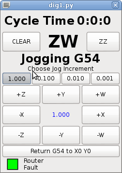

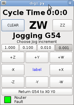

I have been struggling trying to make a GladeVCP. In my panel I want to have a label that changes to show the state of a group of radio buttons. I have it to where It mostly seems to work when testing the panel by its self from the command line. The label will change to what I want when each radio button is selected. The only problem here, is when the window is first opened the label only says "label" until I select one of the buttons. (not to big of a deal)
The bigger problem is that when I open the panel in Linuxcnc (using Axis), the label never changes and always says "label".
Any idea where I'm going wrong.

What exact command are you using to load gladevcp into axis?
in your class's __int__ function you could add:
self.jog_increment.set_text('1.000') for an initial text output (but pick the default output of course)
also I might change this:to :
You would need to define the button name in the __intit__ section:
self.g54inch = self.builder.get_object('g54inch_jog')
(of course all the others too)
and finally I would temporarily add a print command in the activ_inc section to confirm that it is actually getting called.
I would bet it is not getting called.
(you would need to run linuxcnc from a terminal to see the output)

I think there is an error in your script.
See the line
Self.jog_increment
And the following line, Imho you missed a "=" and the line brake should mot be there.
This small error do avoid loading the tab correctly and that is the reason it does not work.
But there are sure more problems if i see the bulk of errors.
Norbert

Replied by cmorley on topic Lable Change by HAL Radio Button?
here is your files editted to work as best i could.
You will only be able to load this using gladevcp no more calling it directly with python.
You will not be able to set a default 'jog' speed as you are using O codes through MDI.
MDI cannot be done until linuccnc is homed.
You would have to do this using more python code - calling MDI commands from the python handler file, rather then action widgets.
If you can live with no default jog speed then the code seems to work for me.
Hope that helps.
