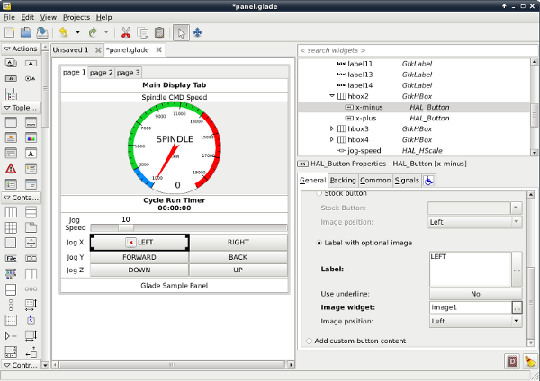

- Click on the slider.
- In the GENERAL tab of the slider, click on the "..." next to ADJUSTMENT.
- A dialog box will open up, click NEW to add the adjustment.
- In the box at the top with all the stuff... click this new adjustment to get to it's values.
- Make some changes to this adjustment...
Rename it something that makes sense, I used "jog-adjustment" for example.
- Fill out the following information at a minimum...
- VALUE = The starting value for the slider
- MINIMUM VALUE = The slowest allowable speed
- MAXIMUM VALUE = The fastest allowable speed
- STEP INCREMENT = Step size for the allowable movement.
Attached is Version GLADE (1.1)

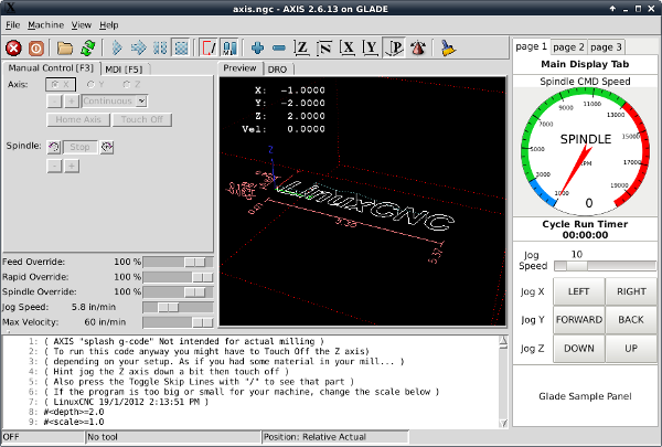

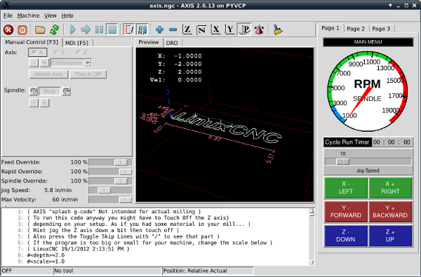

After a bit of trial and error... I was able to create the same machine with a GLADE and with pyVCP. There are a couple of subtle differences... color on the pyVCP buttons for example... but I'll address artistic stuff for GLADE in another post.
Anyway... here is the final result.
pyVCP Original Panel
GLADE Duplicated Panel
Now to learn the artistic side of the GLADE method... whoo!
Jerry

There are about four ways to change the color of the button - it's more painful then it should be.
- upgrade to 2.7 - there are fancy light buttons widgets that can be colored (and rounded and text changed on state)
-place an image file in the button using the GLADE editor.
You would need the text in the image
-try a technique something like this in a python handler file:
stackoverflow.com/questions/1241020/gtk-...lored-regular-button
python files of course allow you to do almost anything but takes more work.
-use custom themes - probably not worth the effort for just a small panel.
Chris M

CHRIS -
You said...
The only indication to place an image is what I see below... and that only places a small image next to the text.
I guess I'll have to learn Python now... from what you are saying... and the referenced web page... it sounds like you rewrite the handler.py file into the folder... and do the changes there. The custom_postgui.hal would modify the AXIS signals... and the handler.py would modify the panel.glade appearance after loading.
If I read that correctly... the WYSIWYG of the GLADE program would not look right until you actually ran it in AXIS.
Sort of what I am doing with pyVCP... write it, look at it, change it... repeat.
Yeah?
Jerry
You said...
Yeah?
Jerry
- Posts: 7368
- Thank you received: 2181
24 Dec 2017 19:52 #103571
Replied by cmorley on topic GLADE Signals IN and OUT - Resolved
Jerry:
try selecting 'add custom content', then add an image widget to the button.
Yes WYSIWYG is not quite true... I generally run an editor and a linuxcnc session side by side to see the changes.
Chris M
