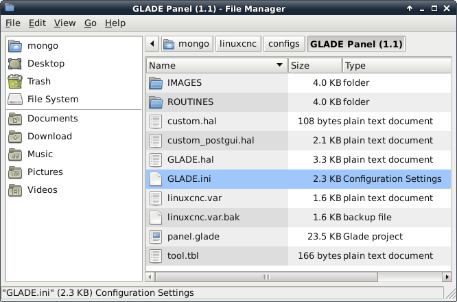

Norbert - This only gives me more questions right now... because I am not yet familiar with where the instructions go to place the code or how to set up the relative path for the imagedir.
As you can see... for each configuration file, I have two subdirectories, ./ROUTINES and ./IMAGES where the .ngc routines and images used in panels and splash screen live. In this case we would be working on GLADE Panel (1.1) in the CONFIG directory.
The code you described above... i presume it would be placed into the subdirectory with the machine.ini and refer to the subdirectory ./IMAGES yes?
Also... are the images placed, centered, or trimmed? In other words, if I made an image that looked like brushed aluminum that was larger than the current button... would it center and trim that image... or expand the button to fit? If the image were smaller... would it center it, zoom it to fit, or attempt to shrink the button? If the image had to be the exact size, i would need to screen capture the current button, then use GIMP or INKSCAPE to measure it and produce an image specific to that size button.... I just need to know how to handle it.
For now... I will presume that the image must be the same size as the button I want to change... and I will presume this image will live in the ./IMAGES folder.
I can take a screen shot and copy a button... in this case, the x-minus button from panel.glade.
I can bring it into GIMP, then decorate it like this... and save it as button1a.png to be imported...
So then I would take your code...
So then... WHERE does this modified code go?
...and how do I let machine.ini know to run it??
let's say I called it "panel_graphics.py" and put it in the same directory as the machine.ini then I presume I either need to add a line to panel.glade or machine.ini to find it... which one? How?
Thanks,
Jerry

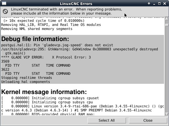

This button thing makes me mad. I created a simple gui with one led, one button and a slider to test things out and it doesn't work.... linuxcnc exits with error thinking the signal of the jog-slider does not exist in the gui. Without the hal directive in postgui.hal file, program starts correctly. I really don't n know what i'm doing wrong...
Files are generated by stepconf wizard for me. Link here:

Replied by cmorley on topic GLADE Signals IN and OUT - Resolved
what is the exact error message?
Chris M

You have used a gtkHscale for your jog slider. That widget does not make HAL pins.
You need to use a HAL_hscale.
Chris M
