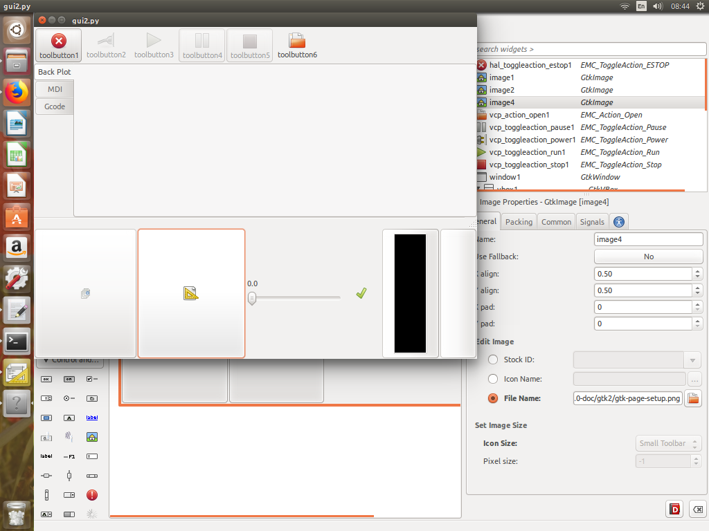

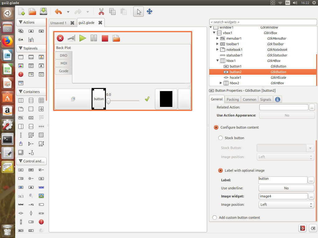

I'm using glade 3.8.6 to make a new GUI. i 'm having a trouble that i dont know how to make a button with label and image. I tried the option "label with option image" but it doesnt work. The image wont show up when "label" is not Null .
Is there anyway that i can put an Icon + label within button. Does it just need to do in Glade or have to edit source.

I don't know, seems to work for me, but I'm using v3.8.0.
Have you defined the image widget for image4?

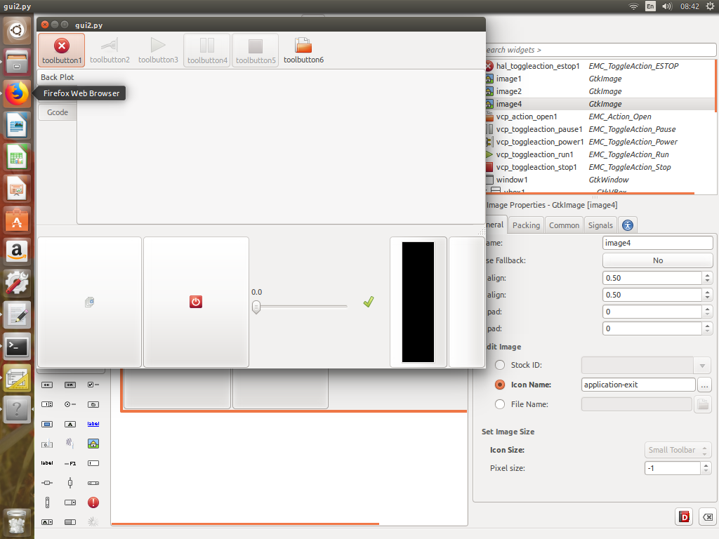

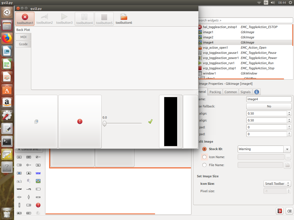

in image4, i defined "stock id", "icon name" or widget but nothing works. I also tried install v3.8.0 before but it's buggy.

IIRC uou must specify the image with an absolute file path (you have to type it in) and it will show properly when loaded.
try that.
I remember getting it to show in there editor was always problematic.
