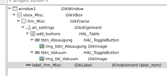

Hi there,
I have implemented in Gmoccapy two additional buttons with the help of glade in the box_custom_3 position.
The whole setup works fine, the button symbols change when I toggle them etc., but the only problem is that the background color of the whole frame is light grey, whereas the rest of gmoccapy is white. Does anybody know how I can change that?
Here is a screenshot of glade
Regards
albert
Regards
albert

One workaround I found out, is to set another theme, so that the rest of the GUI has the same grey. This is also ok for me now, but just for interest, if anybody knows an answer to my question, this would be fine.

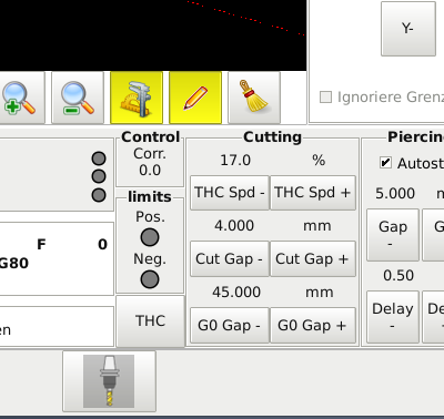

Please take a look at gmoccapy plasma sim config, i did some glade panels for that and the python files do handle themes. Within the python files the theme used is set also to the glade panels to archive the same optical caracter.

The plasma example shows the same behaviour on my machine.
Also in my python code, I put the following snipped from your plasma example
from gmoccapy import preferences
from gmoccapy import getiniinfo
get_ini_info = getiniinfo.GetIniInfo()
prefs = preferences.preferences(get_ini_info.get_preference_file_path())
theme_name = prefs.getpref("gtk_theme", "Follow System Theme", str)
if theme_name == "Follow System Theme":
theme_name = gtk.settings_get_default().get_property("gtk-theme-name")
gtk.settings_get_default().set_string_property("gtk-theme-name", theme_name, "")
which shows no difference.
Albert
