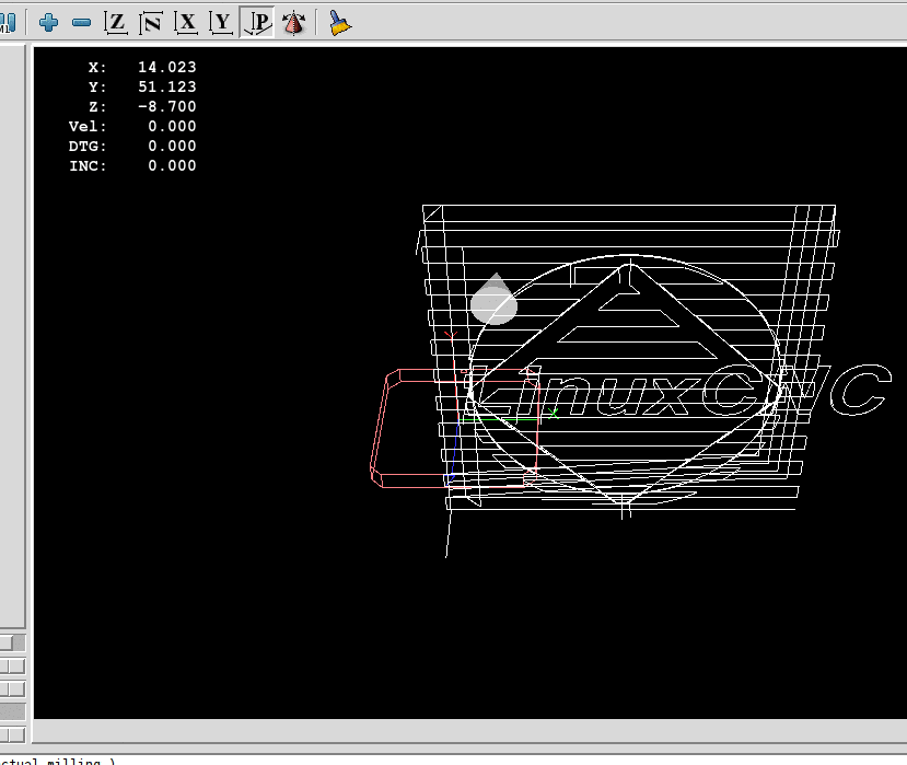

I was wondering if it was possible to display a Gcode trajectory on gremlin without actually loading it.
Ideally I have a gcode file achieving a trajectory but I would like to visualize at the same time another gcode file on the same gremlin window, to be able to do a live comparison while using the machine. For instance I would like to know if my current trajectory is inside or outside another one done previously on a different file, while I am using the machine.

It seems that it should be possible. The "stand alone interpreter" might be one part of the puzzle, as I think that Gremlin only accepts canonical commands.
github.com/LinuxCNC/linuxcnc/tree/master/src/emc/sai

The second file can be loaded as follows:
in axis(.py)
in axis(.py)
else:
unitcode = ''
try:
result, seq = o.load_preview(f, canon, unitcode, initcode, interpname)
except KeyboardInterrupt:
result, seq = 0, 0
try:
f1 = "/home/nkp/linuxcnc-HBM/build/nc_files/cds.ngc" #XXX nkp
result, seq = o.load_preview(f1, canon, unitcode, initcode, interpname) #XXX nkp
pass
