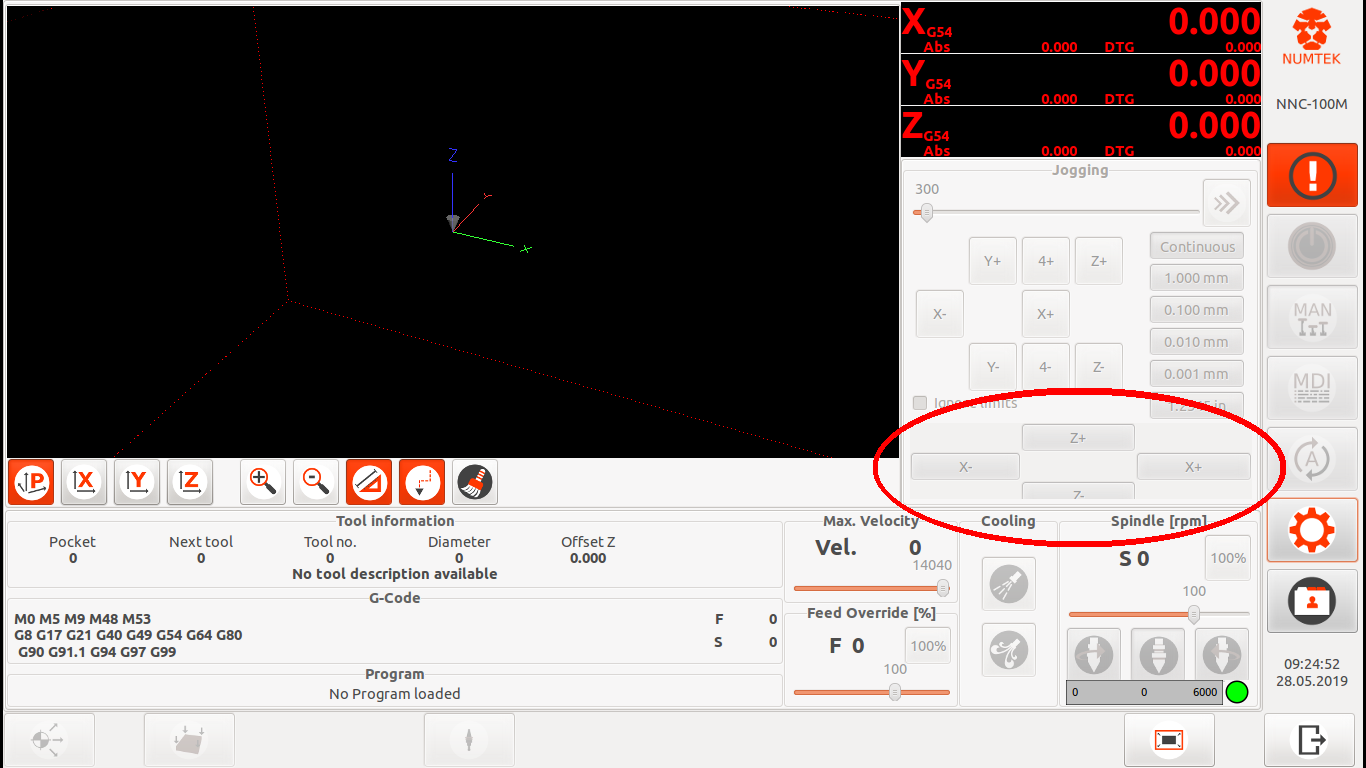

I've searched these forums and the web for an answer to this but nothing came up. I made a simple gladevcp panel to replace the jogging panel on gmoccapy, but instead of replacing it, the new panel shows up just below it:
The ini file has this:
Attached is the glade file. Any help is appreciated. Thanks in advance.
EMBED_TAB_NAME = panel_test
EMBED_TAB_LOCATION = vbox_jog
EMBED_TAB_COMMAND = gladevcp -x {XID} -H panel_test_2.hal panel_test_2.gladeAttached is the glade file. Any help is appreciated. Thanks in advance.

Is there some docs that says you can insert your own jog controls by replacing the stock ones? i didn't see it in the docs.
You can of course modify Gmoccapy directly if you like ...

I must have overlooked the Configuration of tabs and side panels section of Gmoccapy's documentation. Looks like only some locations are valid. I'll see what can be done without modifying Gmoccapy itself.
