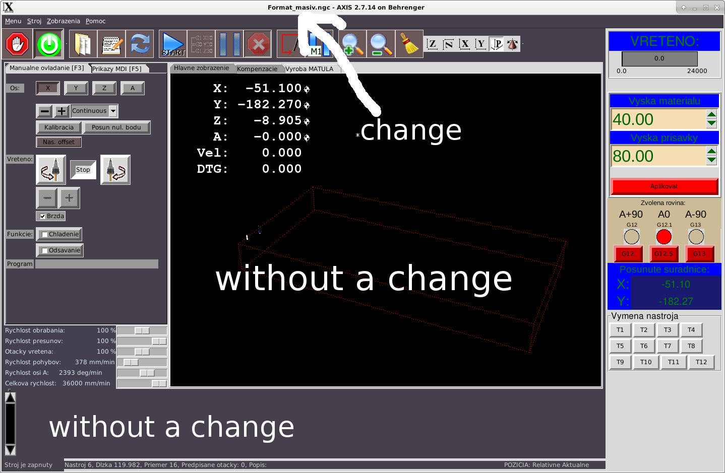

Hi people, i would like call python script from gladevcp button. I need open file to AXIS via python.

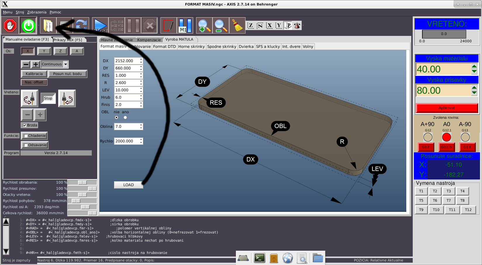

Thanks for help. This is the right way.
Now I have another problem.
This python works, but badly:

When the button is pressed, the program overwrites only the top names but nothing in the system.
Gcod without changes. (my gcod is ok, link also)

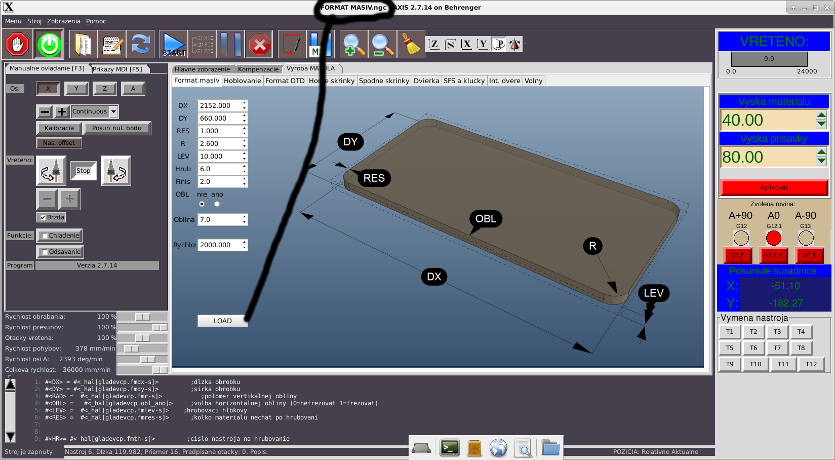

Try something like this:
#!/usr/bin/env python
from subprocess import call
def on_for_mas_pressed(data=None):
call(['axis-remote','Format_masiv.ngc'])Please Log in or Create an account to join the conversation.

Great thanks to "Cmorley"
It works perfectly.
