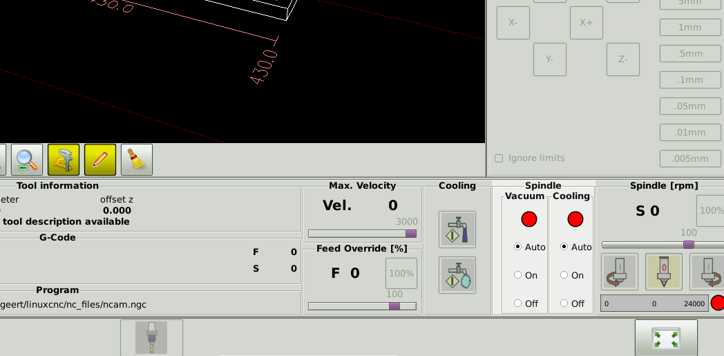

I am trying to add some radiobuttons and led indicators to Gmoccapy.
So far, I designed how they should look with glade, modified my .ini file to make them appear between the cooling and spindle boxes which looks OK:
Starting Gmoccapy shows the buttons as expected and in the correct location:

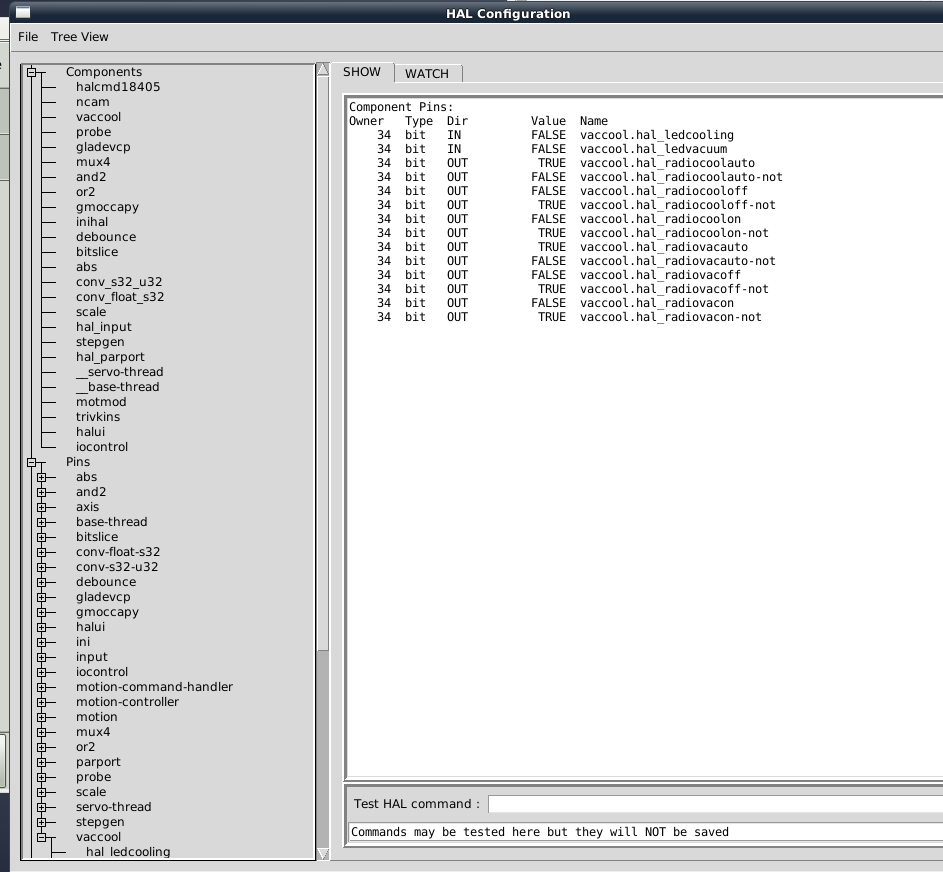

Opening halshow shows the correct component (vaccool) as well as the corresponding pins as available:

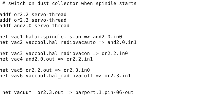

But as soon as I want to use those pins in my custom_postgui.hal file:
I get the following error when starting linuxcnc:
Am I missing something fundamental here ?

I'm not sure about this, but it is possible that the underscores in your pin names are causing a problem. Can you try to rename what the hal pins your gui is creating are called to get rid of them.

You must connect HAL pins for the custom gladevcp in a separate file by using the -H option in gladevcp.
linuxcnc.org/docs/2.7/html/gui/gladevcp....command_line_options
in that file connect the widgets pins to signals only
then in any other file you can connect those signals to what ever other pins you like.
In this way the it doesn't matter on the timing of the availability of the pins.

Geerd's problem is a race condition - caused by how gladevcp is loaded without waiting for the pins to be ready.

Removing the underscores did not change anything.
Cmorley's reply however seems to be the correct one. My gladevcp hal-radiobuttons now work as expected.
